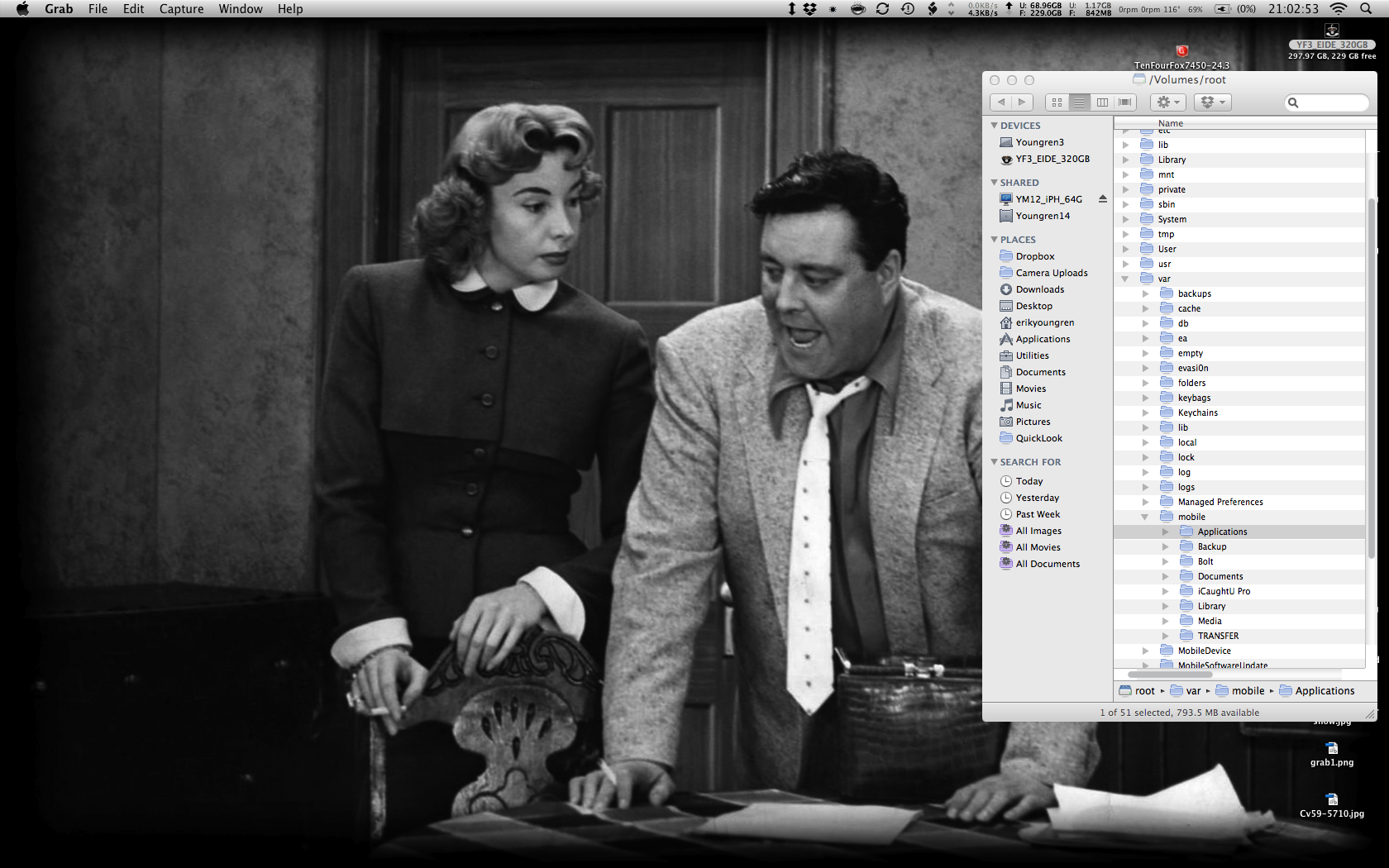

OpenSSH combined with NetaTalk are what allow me to mount my iPhone as a hard drive and copy files to and from my Mac via WiFi.
is it compatible with windows? (doesn't look like it is from what I see online). if not, do you know of any alternative equivalent to netatalk? sounds really nifty and convenient
Unfortunately, I'm not sure if there is anything for Windows. But I will keep an eye out.
Netatalk is also written by Saurik and it leverages Appletalk, which of course is an Apple protocol.
Here's my root drive mounted on my desktop. In the shared devices my iPhone is listed as YM12_iPH_64G. You can also mount the home drive if you want.

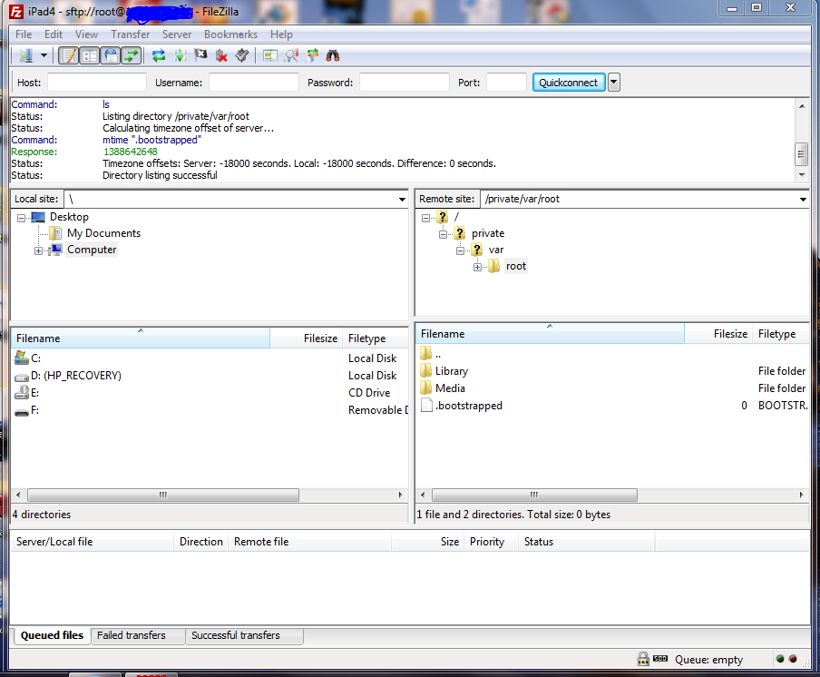

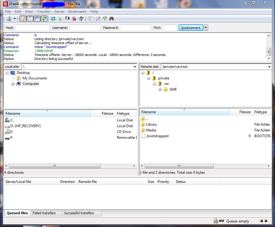

I use FileZilla. Computer in left pane and iPad in the right pane. It is so easy to navigate and move file back and forth between the panes.
