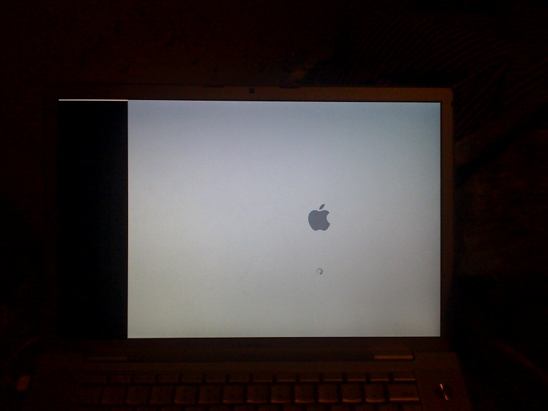

Hey there.
My Mac has been playing up a bit.
When im using it the screen will distort.
And when i go to restart the screen is displaced and it Kernel Panics (see pic)
What could be the issue behind this? I have formatted my Hard drive and reinstalled with snow leopard (Funny it happened few weeks after i first installed SL).
And it still does the samething, But I sure its affected by the heat of my mac somewhat. If i have SMC Fan Control on it cools it and doesn't do it as much.
Help much thanked for.
Thanks TheTosh
Take it to the Apple Store. That looks like your graphics card has failed, should be covered by warranty. (Even though you have a pre-unibody Apple covers failed 8600m's). Assuming that is what you have..

I have.
NVIDIA GeForce 8600M GT:
Chipset Model: GeForce 8600M GT
Type: GPU
Bus: PCIe
PCIe Lane Width: x4
VRAM (Total): 128 MB
Vendor: NVIDIA (0x10de)
Device ID: 0x0407
Revision ID: 0x00a1
ROM Revision: 3175
Displays:
So Yes i have a 8600.
