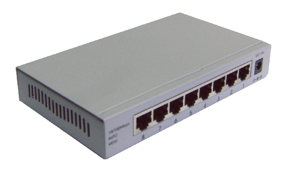

He means a switch like what is shown below; an ethernet switch. You would plug in your modem to the switch, then plug in how many wired computers you need into the switch as well.
It's not a switch on the computer.

Thanks. Understand now. I will find out if my router can do 1000. If not I will purchase one of those.
