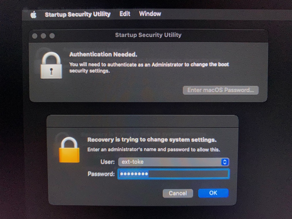

It won't boot from external if SIP is disabled in Recovery.
This of course can be because you can't adjust the Startup Security Utility's settings...

Just noticed that my SIP is off, when booted to external Monterey, even that I enabled it in Recovery just before.
There's something so wrong... maybe they never bothered to make good firmware to mini2018... niche product and all...

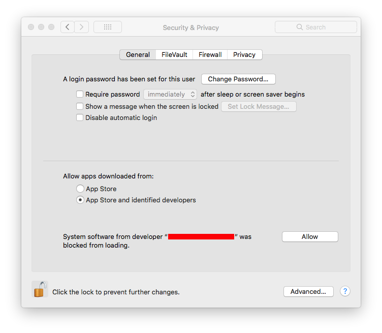

Is this "a normal" behavior of 3rd party kexts in Monterey:
1647284059949-png.1973421
All kexts are grayed out, so you can't choose what to use and what not?
All or nothing?
That list appears to be software that you already have installed, and that you have been using.
(probably not new software that you have just installed)
So, those would be related to kexts that you have already been actively using as part of the software that you have added to your Mac.
And, not really a mention of kexts, but that the security part of your system is informing you that the system needs to be restarted before the software from those various developers can be fully used.
Finally, your next step is to clear that message by restarting your Mac.
What other choice would you need at that time?
( I might keep a copy of those developers, in case the Monterey system goes "wonky" after a restart. Gives a little info about what might not be working -- although the fact that the system shows you a list of developers (and not error messages of some kind) might give you some reassurance that those various apps are probably OK with Monterey.
Restart, and find out... :cool:

Nope, OS is asking me to enable them all or nothing.
The first one is for satsmart kext.
Others are baggage from Mojave, I guess.
I would have liked to choose, what to enable and what tu disable.
But all grayed out and already chosen.
Here comes the bootloop again!
I manually removed them all and got my problem away.
But this just show how broken the OS still is.
