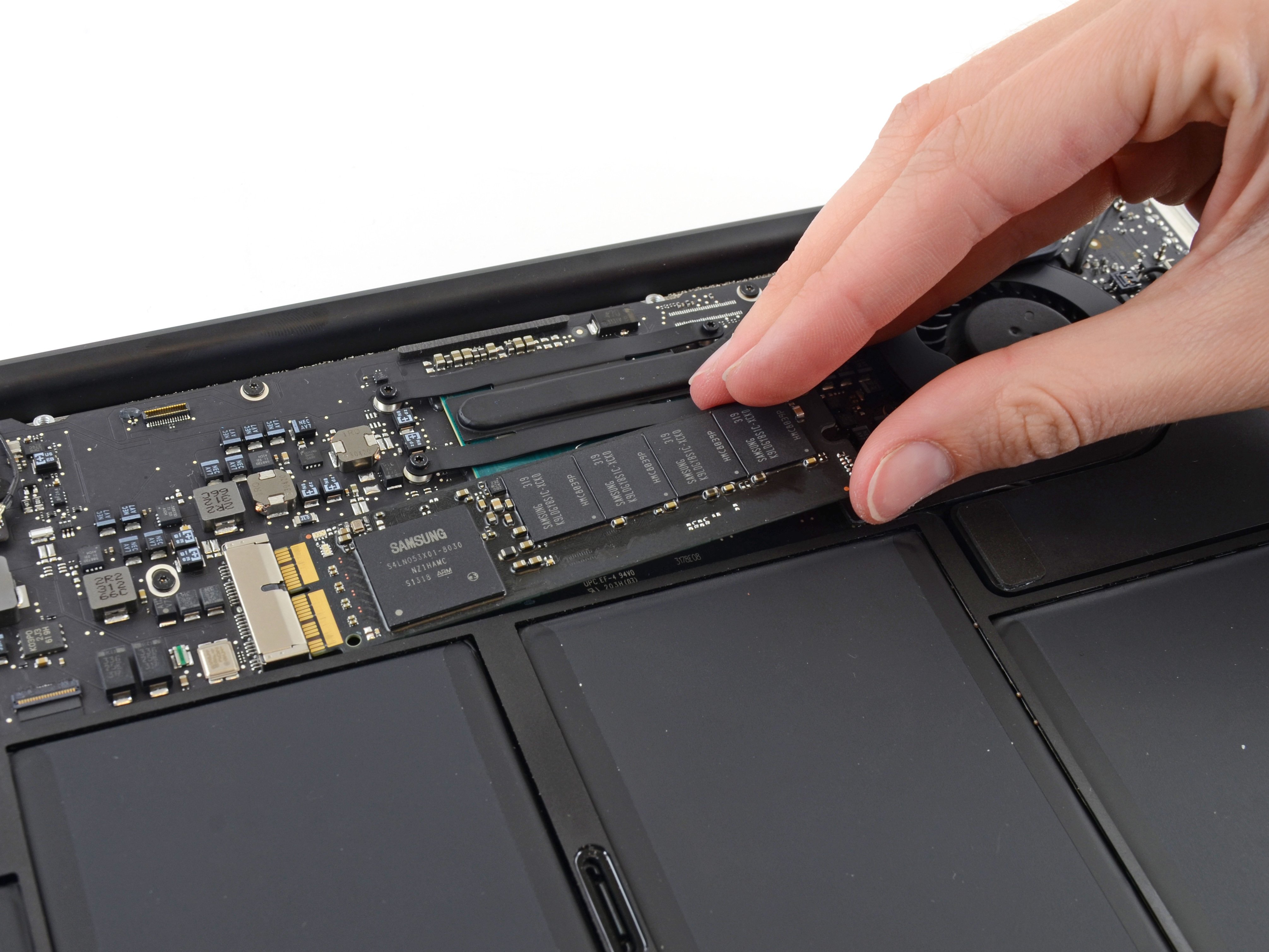

I have a 128 SSD, I want to increase it to 512 and therefore I want to know what the read and write speed should be, so as not to buy a too slow SSD and not overpay for an overly expensive one that will not reveal its potential.
And therefore I am interested in what the maximum read and write speed can be for my 2017 MacBook Air.
I suggest that you make sure the firmware is fully updated. Check in System Information/Hardware Overview.
I have one of those 13-inch, 2017 MacBook Air, and the firmware should be 489.0.0.0.0
If not, install the latest Monterey on the OEM SSD, which should result in updated firmware. THEN, replace the SSD with whatever third-party SSD. (I have a Solidigm 512GB, which gives me about 1350 MB/s R/W -- fast enough for me)

I have Monterey version 12.6.7 Is it bad?
You can buy a kit here, and some of them include a 1TB external drive to make it easy to back up your original drive before you swap them out.
Reactions: MBAir2010
It's not the current version, which is 12.7.6.
Download the current version installer, make a bootable USB from that. Boot to that installer USB. Install the update--to your OEM SSD installed in your 2017 MBAir.
Check your firmware version, both before you install Monterey, and after the install. You may find that it is already at version 289.0.0.0.0, in that case, you don't need to proceed with the Monterey install, as the firmware is already current. Continue on with whatever replacement SSD you want to use.
