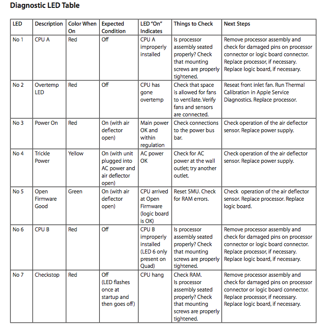

According to my G5 Service manual, the 7th LED from the top, inset below the DIMM slots, is LED #7.
ON RED indicates a CPU hang.
Things to Check: Check RAM. Is processor assembly seated properly? Check that mounting screws are properly tightened.
Remove processor assembly and check for damaged pins on processor connector or logic board connector. Replace processor, if necessary. Replace logic board, if necessary.
Since you already seated the RAM, try removing pairs until you find something that works consistently.
