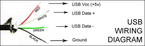

I don't think it would be too hard to take a 1 m cable and splice out two feet of it at a radio repair /electronics company that does professional soldering… For 10 or 15 bucks…
I'm on the fence of cutting my extra Apple Watch cable down from the 1m to 1.5".
I've cut and spliced before, but instead of reconnecting the four wires, I'd probably just solder it into a new connector.

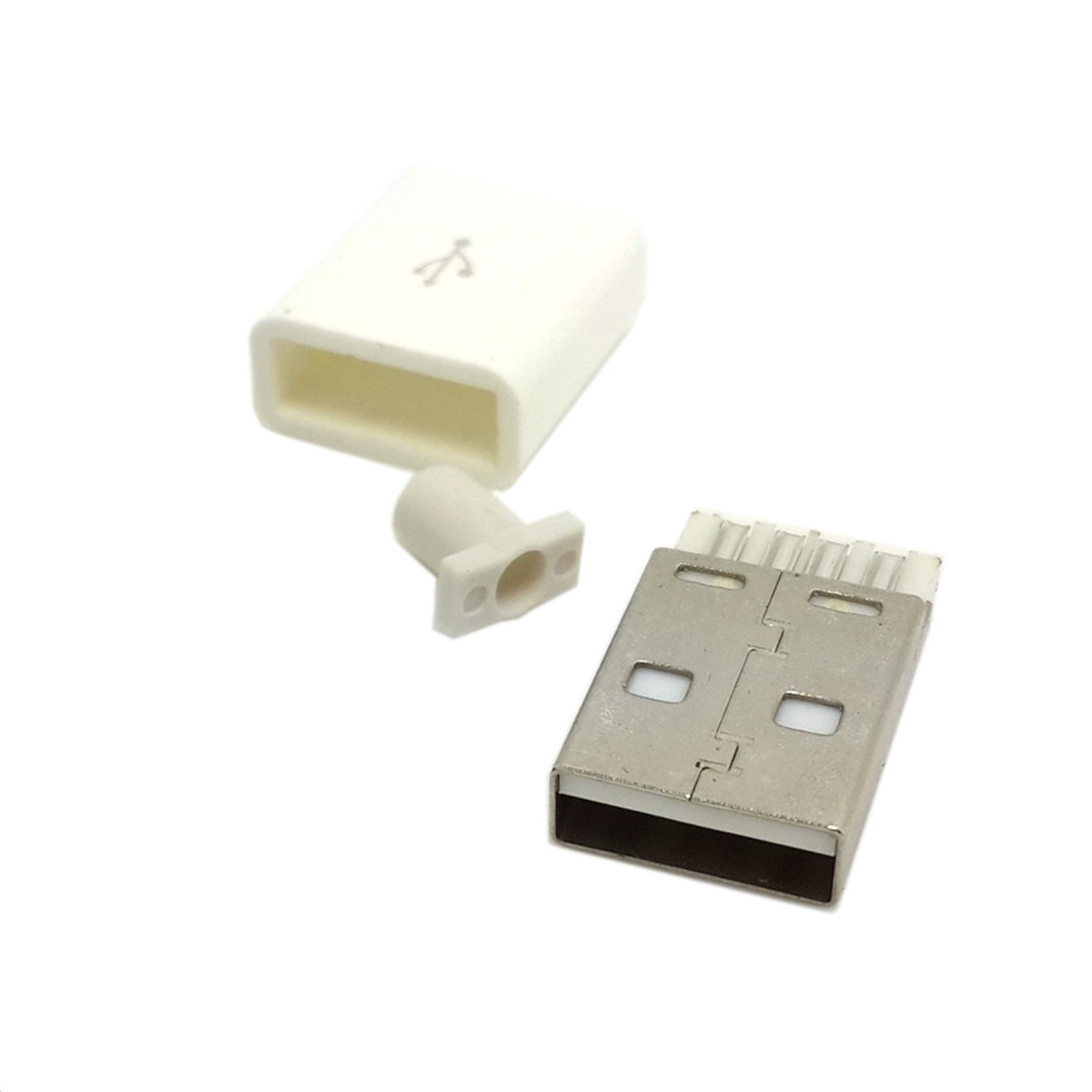

A 10-pack of these are just over $5 on eBay and Amazon.
http://www.ebay.com/itm/New-DIY-USB...874?pt=LH_DefaultDomain_0&hash=item1e9cc15172
  • Cut wire
  • Run it through the sheath and white cover
  • Tie a knot or glue at the sheath
  • Open up the wire and solder to the 4 connectors
  • Glue the white cover to the USB connector
