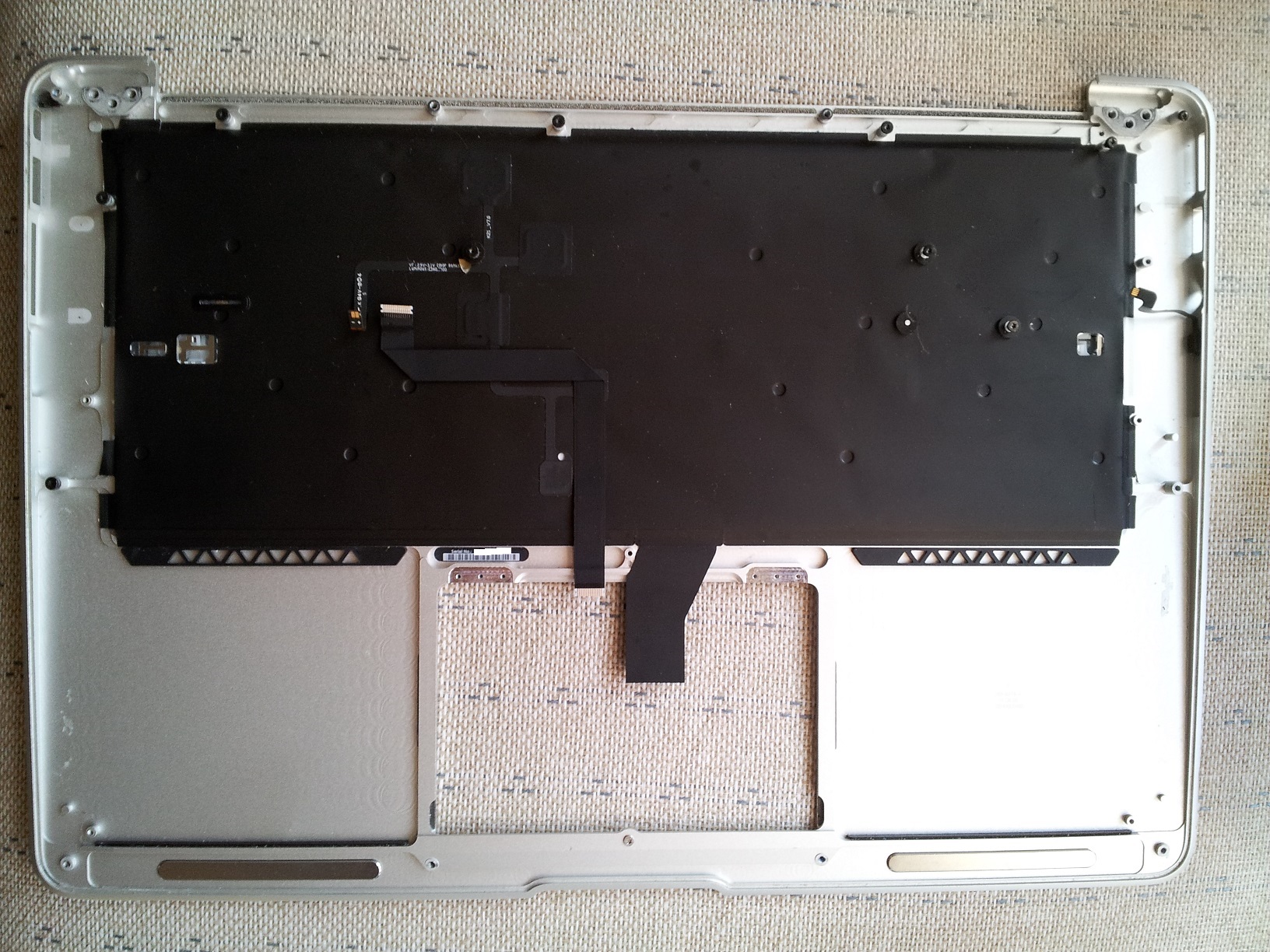

Those that think air passes via the keyboard are 100% incorrect.
Air does not pass that plastic membrane on the backside of the keyboard.

The air is pulled in one side of the hinge and out the other side of the hinge. The gap exists wether the lid is open or closed.
