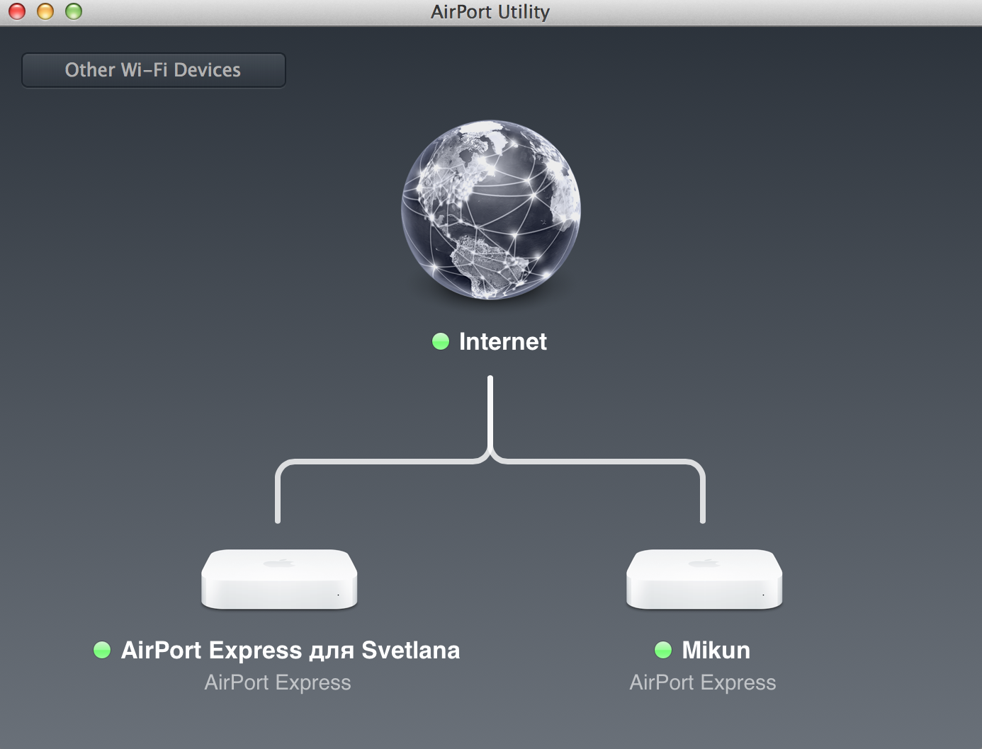

When I open Airport Utility I have the world globe at the top. Underneath it is a small green dot and it reads Internet.
Then it is branched off into 2 other Airport Express. To the right is my Airport Express with a green light and Airport Express and (my named network).
To the left is another Airport Express with a green light and it's called Airport Express (3 funky character almost Russian looking) Svetlana.
What is this?
Why isn't there just my network?
I live in a condo in Chiang Mai Thailand.
I have an ethernet connection coming out of the wall. I have had this set up for about a 3 weeks now since buying the APE new.
I never noticed this before.
It all works fine and I have pretty fast wireless internet.
Anybody know what this is?

If the (almost russian) AirPort were connected to your network, it'd be connected via a line on the graph. Solid if wired, dashed if wirelessly.
PS there's an option in utility's preferences to show only basestations you've set up.
It is connected via a line to the globe, but not my airport
I have the selected in preferences to show only base stations I've set up and this one still shows up.

Ok, you've got AirPort Express for Svetlana there neighboring! This also means it's already been set up!
If you hover the mouse over both AirPorts, what details do you see?
You could also try if you can enter the Edit mode of her router to have a closer look.
Also, woth a Bonjour Browser you should see how come, her airport registeres on your local network?
That would mean both AirPorts are already in bridge mode?
I'll have to test my two tonight. I'm curious to see if you have two Airports setup as routers, but connected to the same ethernet network (like his apt building), if they show up like that.
Essentially, both AirPort Expresses are on the same local network (apartment building). The Internet comes through a modem and connects to a large switch which runs drops to every apartment. So when you plug in your Express, it functions within the same LAN as the other.
When I click on that APE it asks for password.

There is no default password for Airports, AFAIK.
Other brand routers come with an generic admin account/password enabled from the factory. You have to know that to be able to login and configure the router. With Apple, you use Airport Utility, and it just lets you in (if it's a new router).

Bottom line is that it's ok, what I'm seeing is normal and all it good.
Glad you're all set! 🙂
