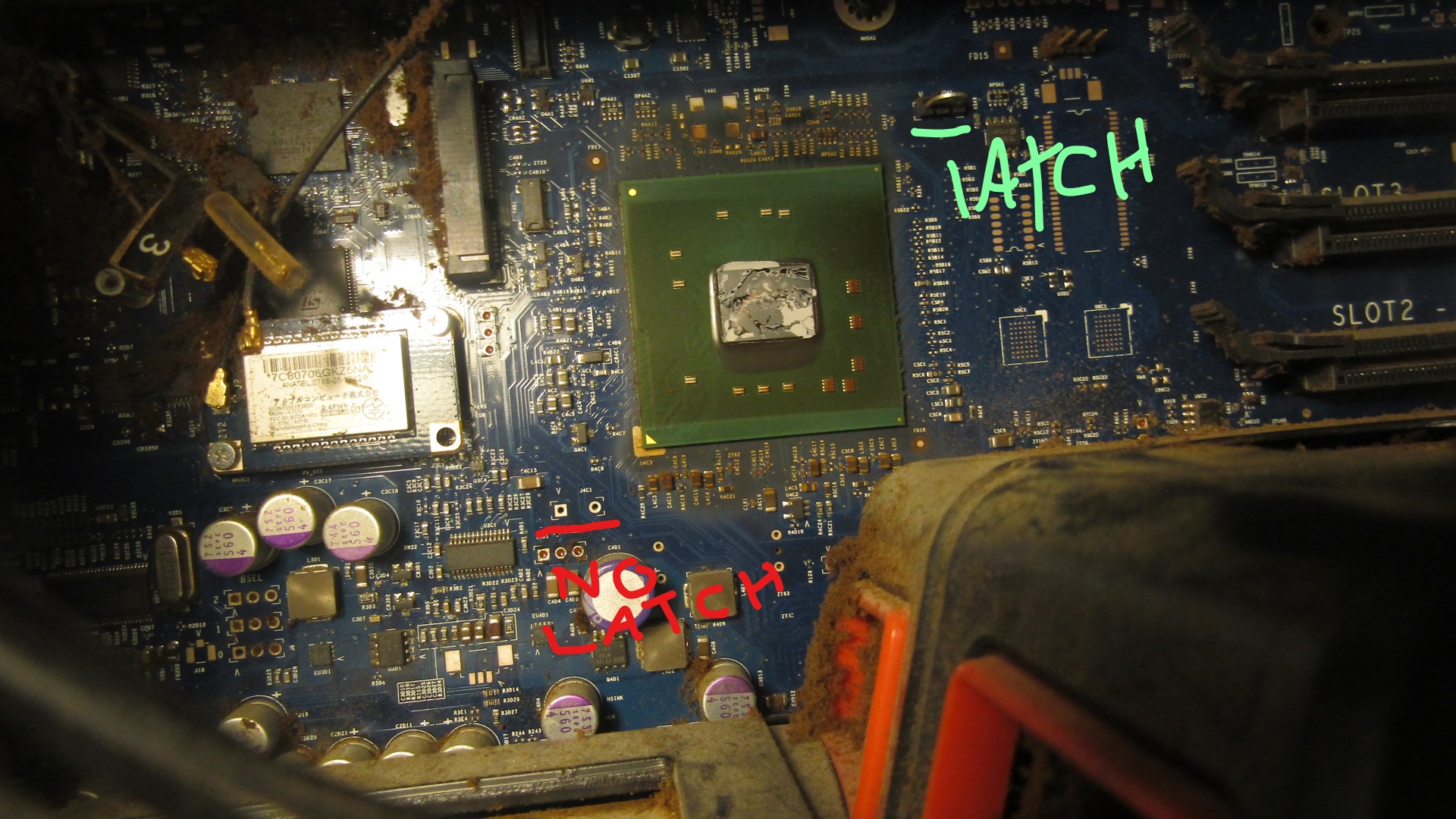

Last week my mac pro 2008 wouldnt wake from sleep, but after about 12 hours it randomly woke its self up and i was able to back up some files, but it fell asleep again and never woke up again. So, i opened it up and noticed that the dimm2 light was on so i googled it and switched my ram modules about and the dimm2 light is no longer on but the machine still not starting up.
Ok so then i noticed that this metal thing was at an angle lol and for a bit i thought thats how it should be, but the i touched it and it was just hanging on lol having a swing 🙂 So im thinking that this has to be the problem right, but i dont know what it is. So i cant google how to fix it and the mac repair place wants £60 just to look at it.
Also i cant see a second latch for the bottom hook but it maybe covered up by the graphics card, and the arms with hooks almost have like 90 degree difference, so it dont even look like it would fix to anything but the is some holes 🙂 that the latch may have been in.
So i need to know the name of the metal radiator looking bit and the latch.
Thanks

First things first that machine needs a dam good clean, its disgusting in there. and the latch your missing must be in there some where? most likely buried in debris. dont try and start the machine with out the chipset heatsink fitted with fresh thermal paste. Or you may fry the logic board.
long time since ive seen a machine looking that bad.

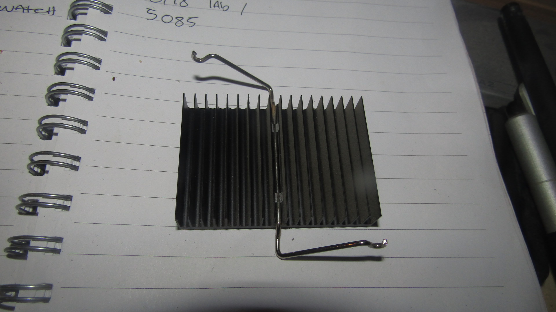

Its a heat sync, and like a radiator, its used to move heat. It appears the latching mechanism broke and thus without a firm contact your system over heated and shut off to protect itself.
Since the latching mechanism is made of metal, I would definitely look for it in the case, that metal debris could short the system out.

Thanks for the replies guys but how do i buy a new latch if i cant find it ? dose it have a name ?
This latch thing that is missing can be easily replaced. During manufacturing process it is basically treated as a normal electrical component, although it serves only a mechanical purpose. This means it is soldered on the back side of the board just as any other component. Sure, it would be great if you could find the missing original component in the case, but since you vacuumed it most likely is Gone for good. Now you have two options to fix it. Either you go the original route and look for a single solid metal wire (such as paper clip), form it in a way that it has the same size dimensions and solder it on the correct location. Problem will be the fact that you have to disassemble the main Bord to reach the backside. The othe quick fix I can think of is to clean everything on the chip and heat sink and glue it back on with thermal glue. (Yes there is a thermal compound glue). This would be the easiest to do.

I figured out a guitar string would work well cause it will fit through the holes and is bendable and strong enough to work with, but i found an old machine on ebay and it has the same latches and heat sync as mine inside.
