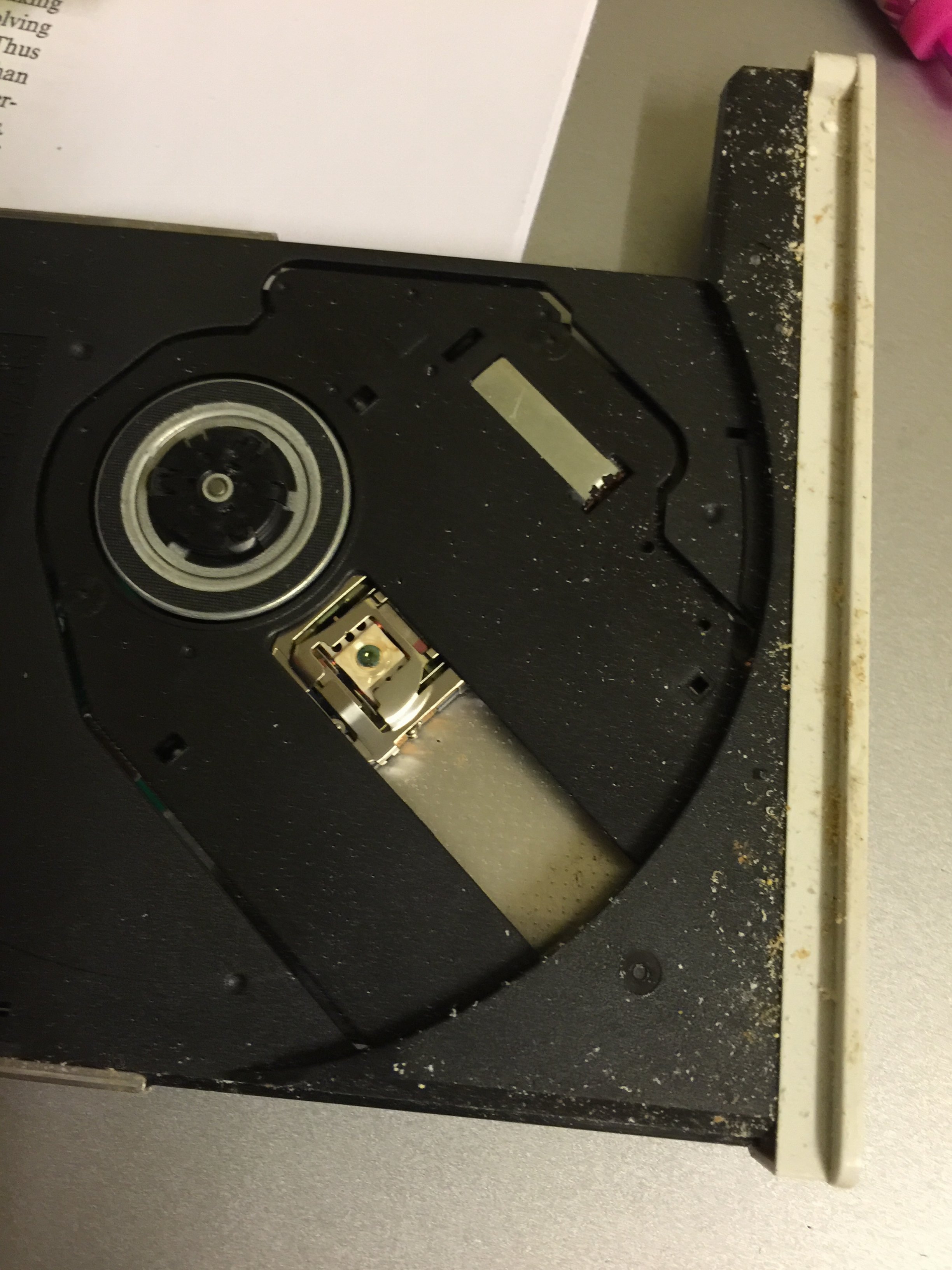

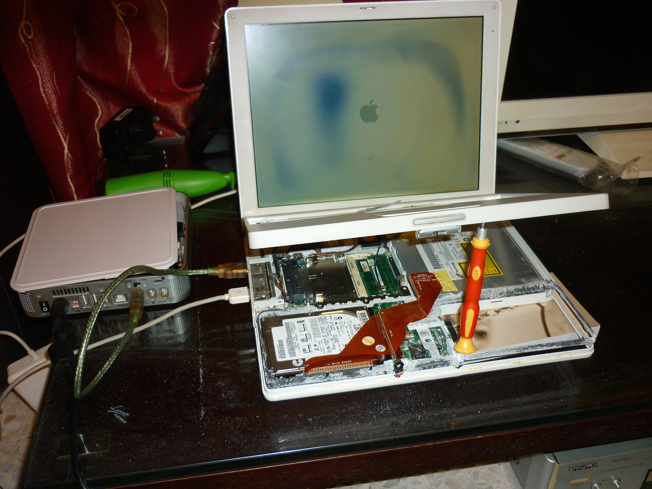

Guys, anyone came across such an experience ? Its like beach sand or coarse power, keeps coming out... At the battery, on the table... Its leaking with this !!
No hdd detected, track pad fine, Need to teardown i guess.

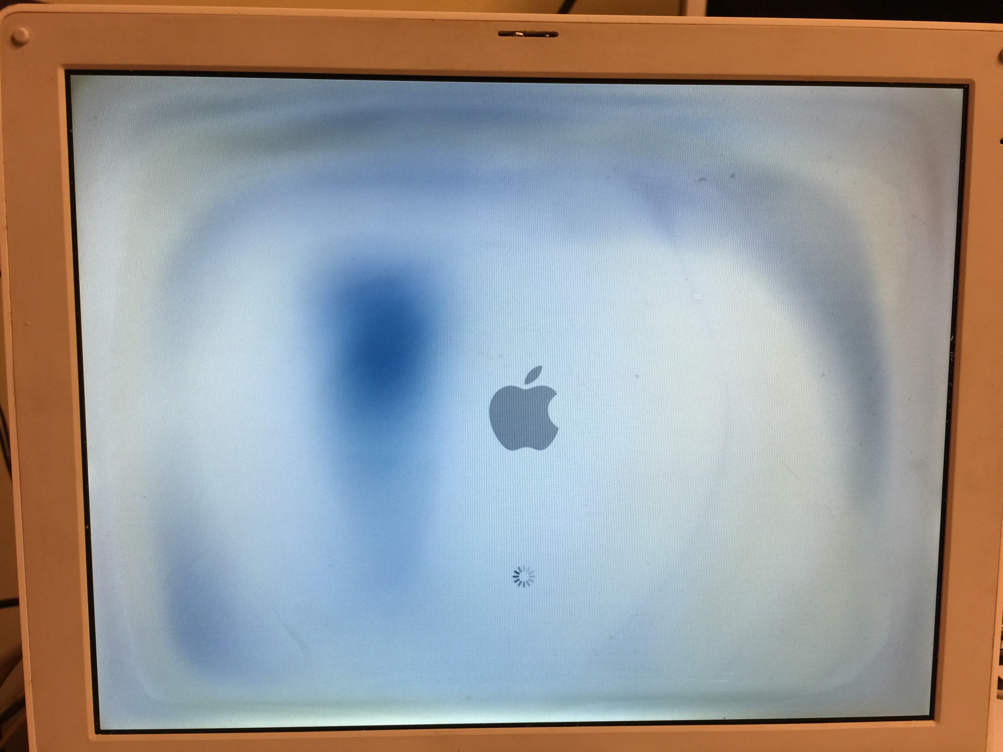

Also, in your experiences ....is this the LCd or gpu ? Tried an external screen but no image at all.
With reference to the debris issue, although not stated, I presume this is an iBook you have just acquired rather than one which was in use by yourself previously, and known to be clean and functional.
If recently acquired, it's highly likely that it has been used on or near a sandy beach. Time for a strip-down methinks.
For the first issue, there is probably something inside of it, second, that is definitely the LCD
Ohhh that sounds spooky, something inside of it 😛 i wonder wht it is...
If its the lcd, then it should be fine. But i think that the gpu issue may follow up, the screen kinda has horizontal lines, if viewed from another angle.

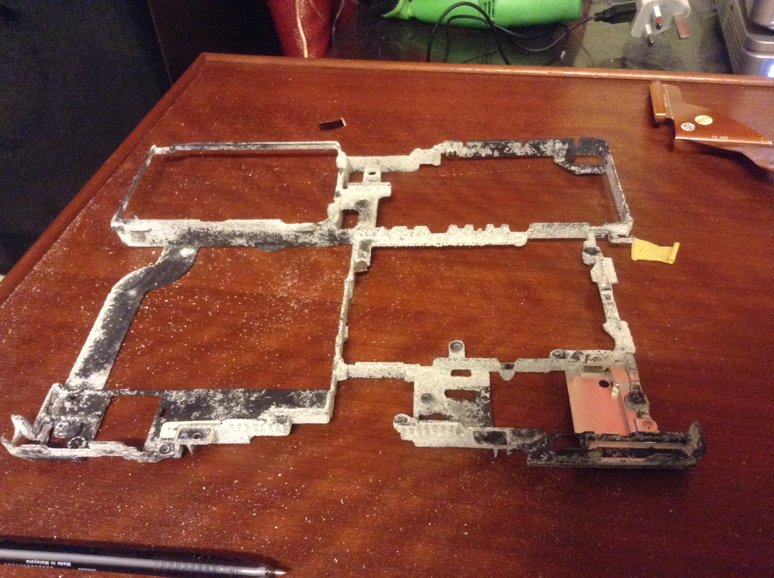

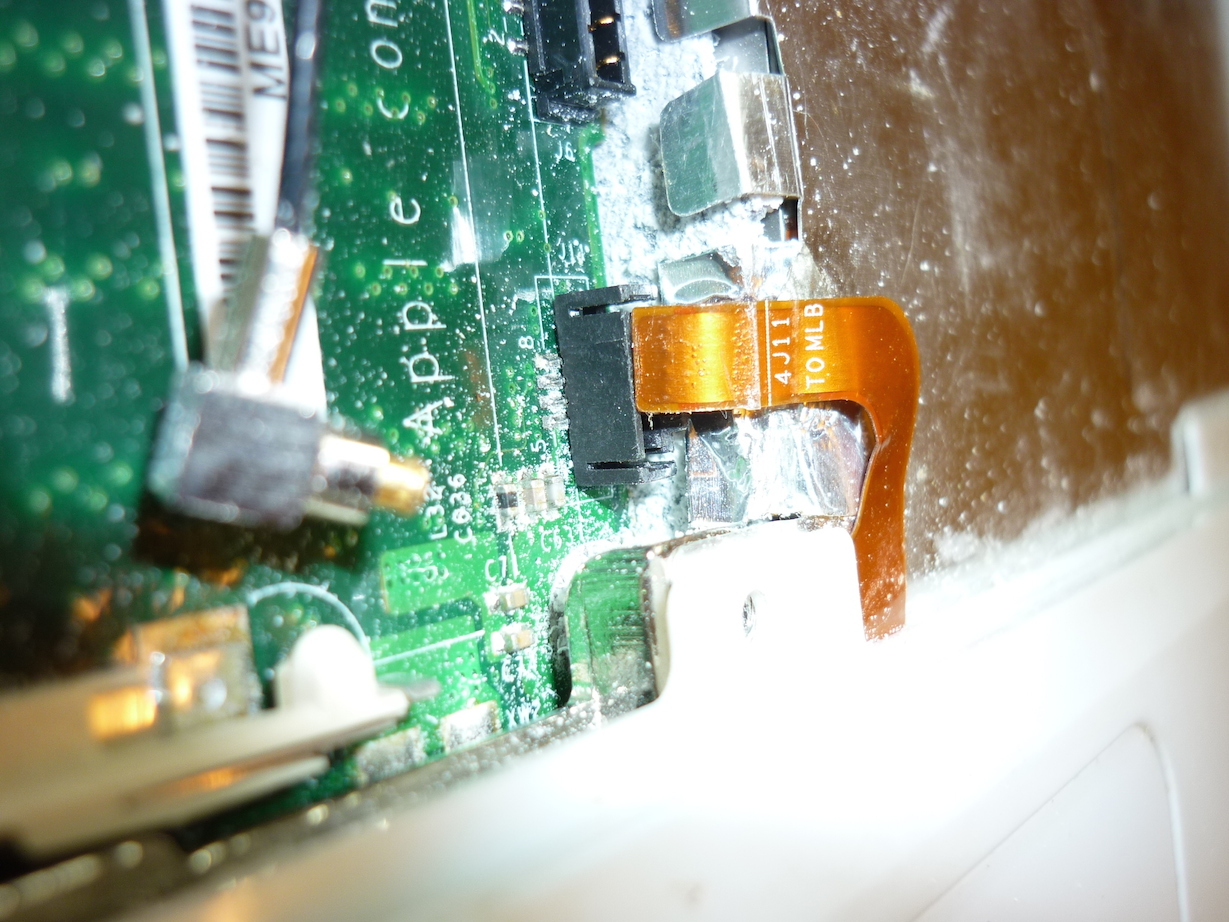

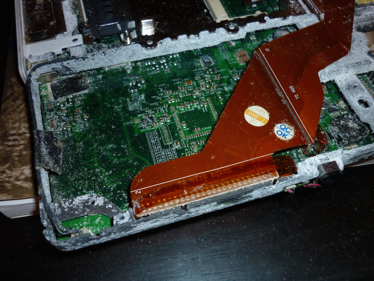

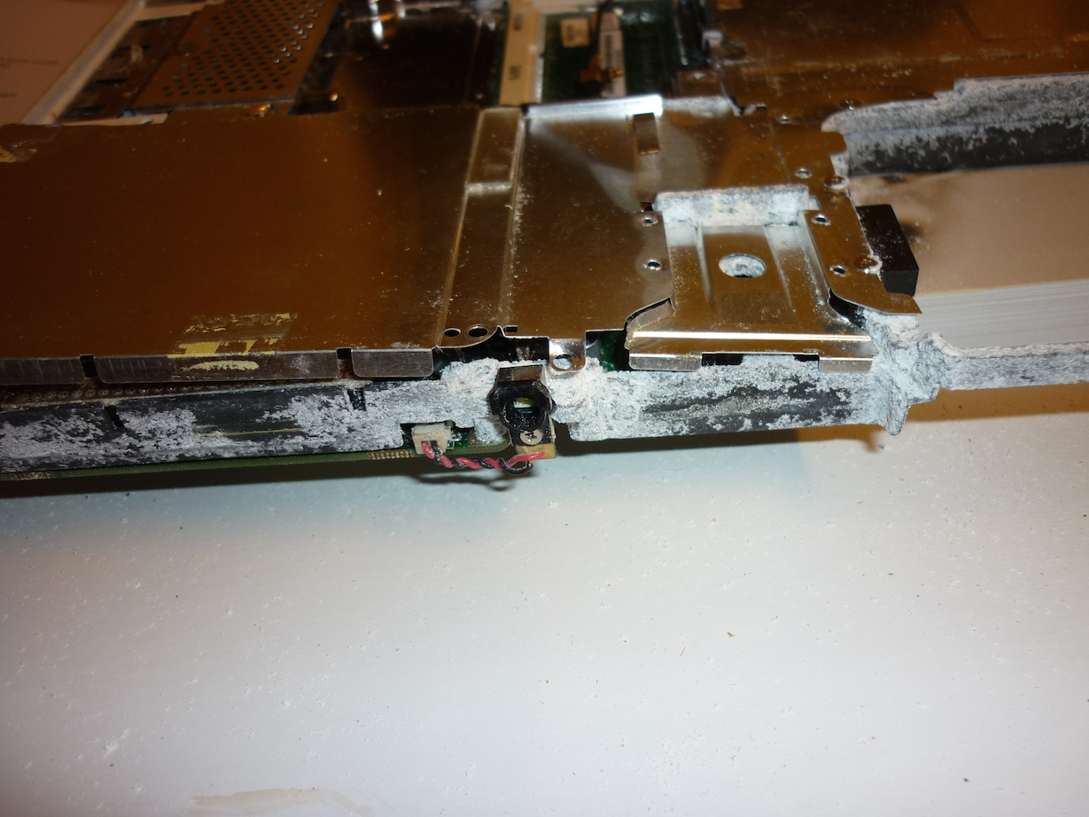

Under the keyboard it is fine... But then i took a closer look at it today, once the battery is removed, in the inner part, its like corrosion. Its grown like fungers !
I think this corrosion must have grown all over in the inner part.
Dows this happen due to non useage for a ling period ?

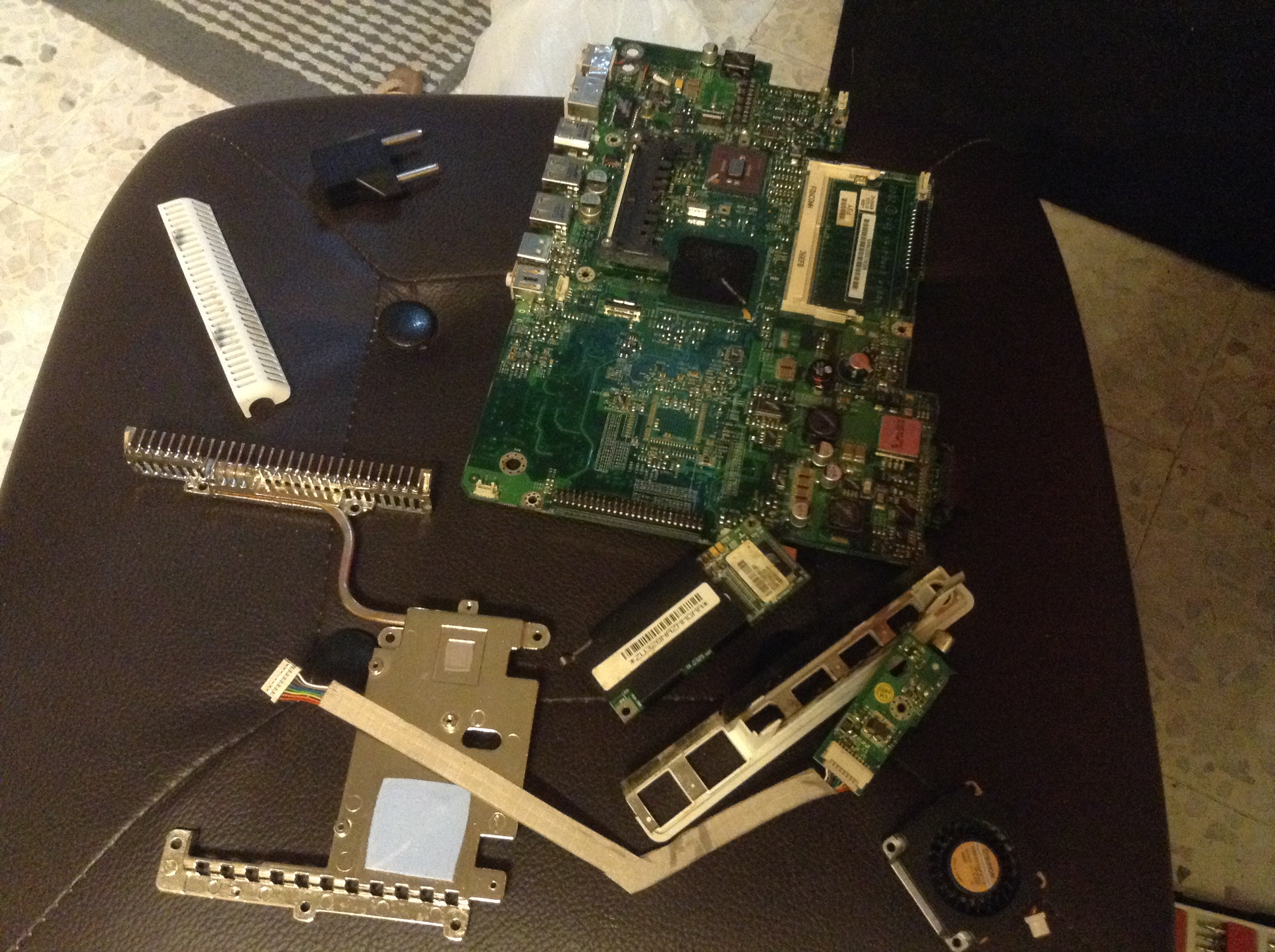

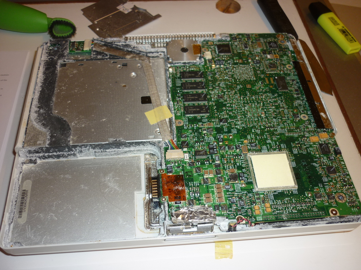

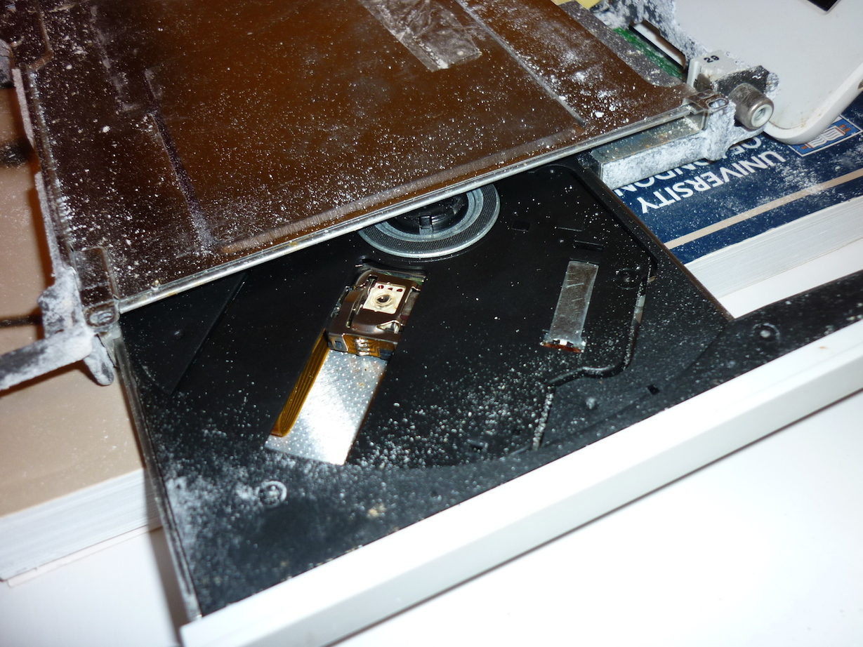

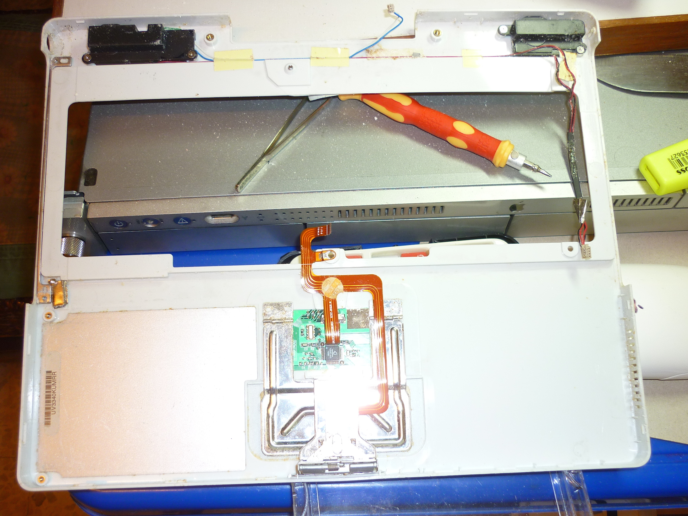

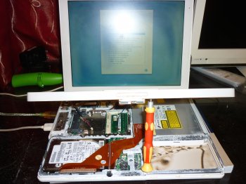

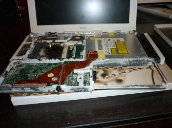

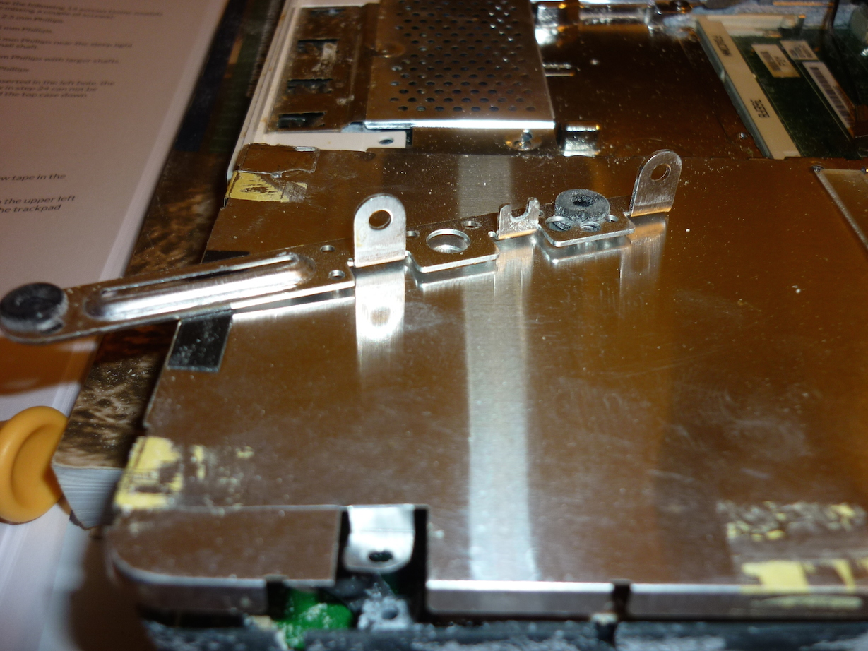

this is what is inside it........
This was a tricky one, i thought i had broke the connector !

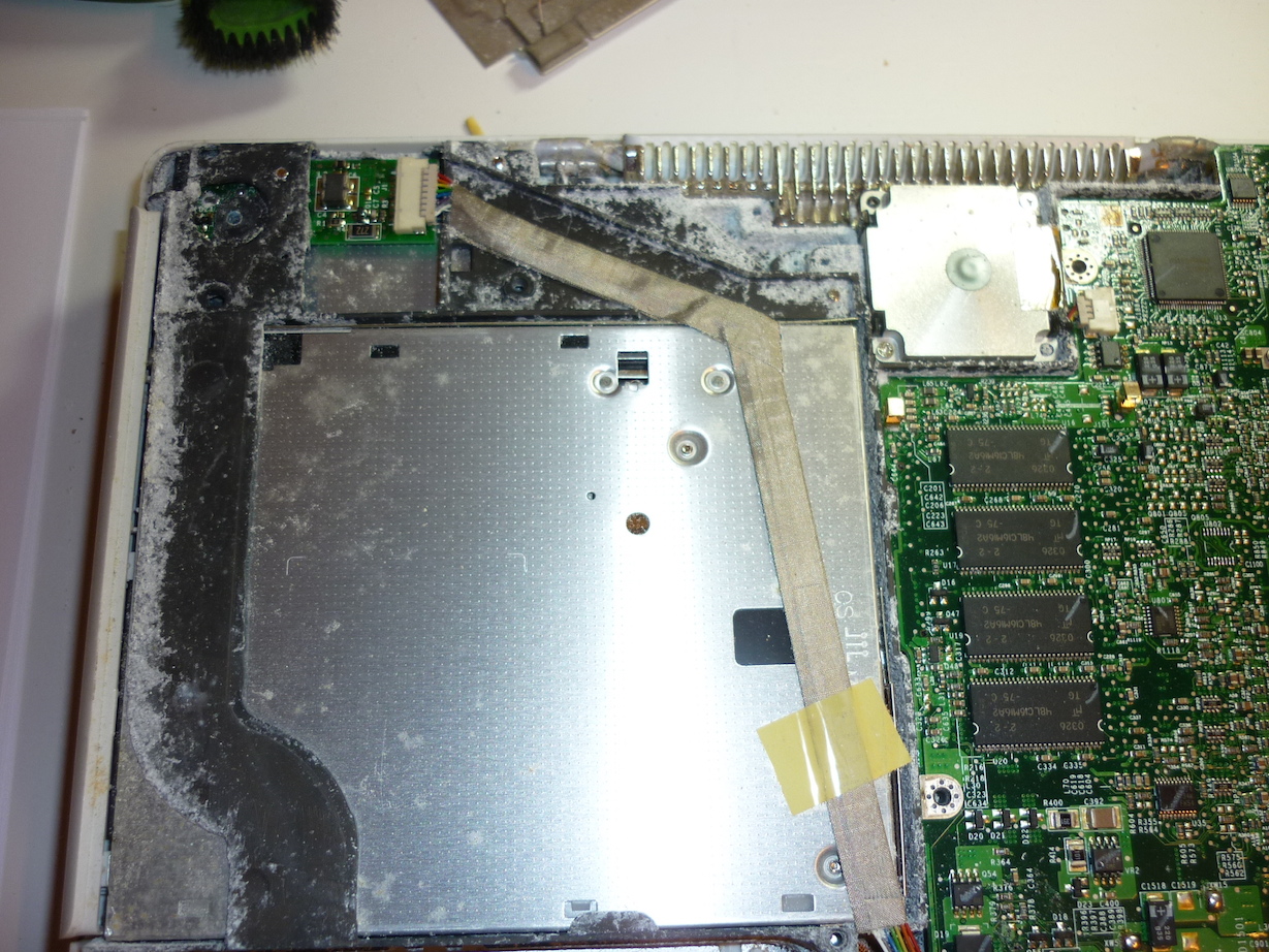

Its all over, the fan does not seem to spin. i pushed it a bit, it spanned a little and then stopped again.
Now we know where this substance came from.
Reactions: Goatllama

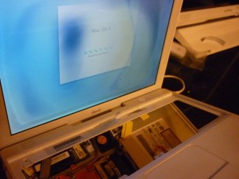

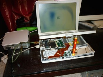

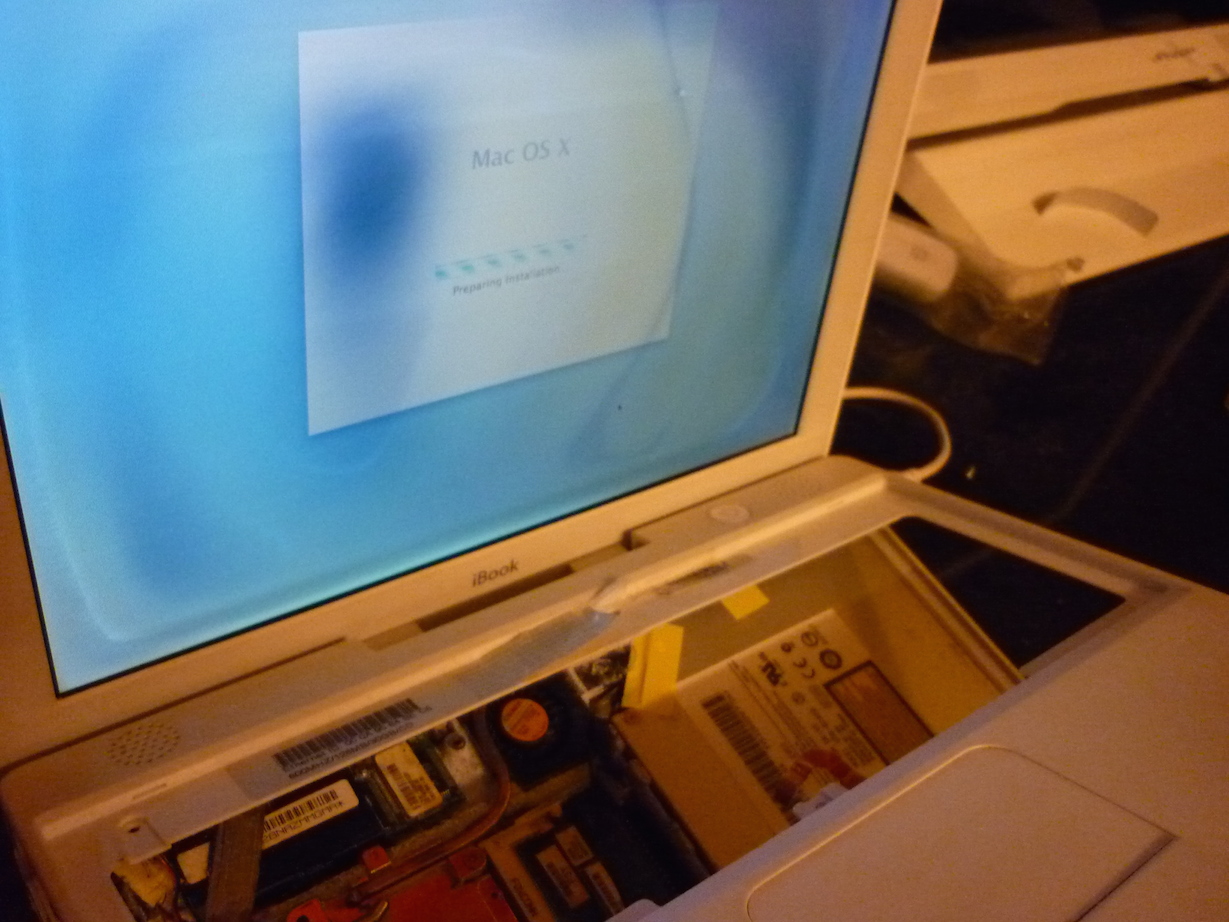

its grown on the chassis all over, so not being sure that it'll detect the HDD, tied slotting in a hdd, it did kick in.
but could not get pass the initial boot screen. thought maybe the ram wasn't sufficient..... Actually ether was NO ram in it, i kinda ddnt notice it, even though it was just in front of my eyes....

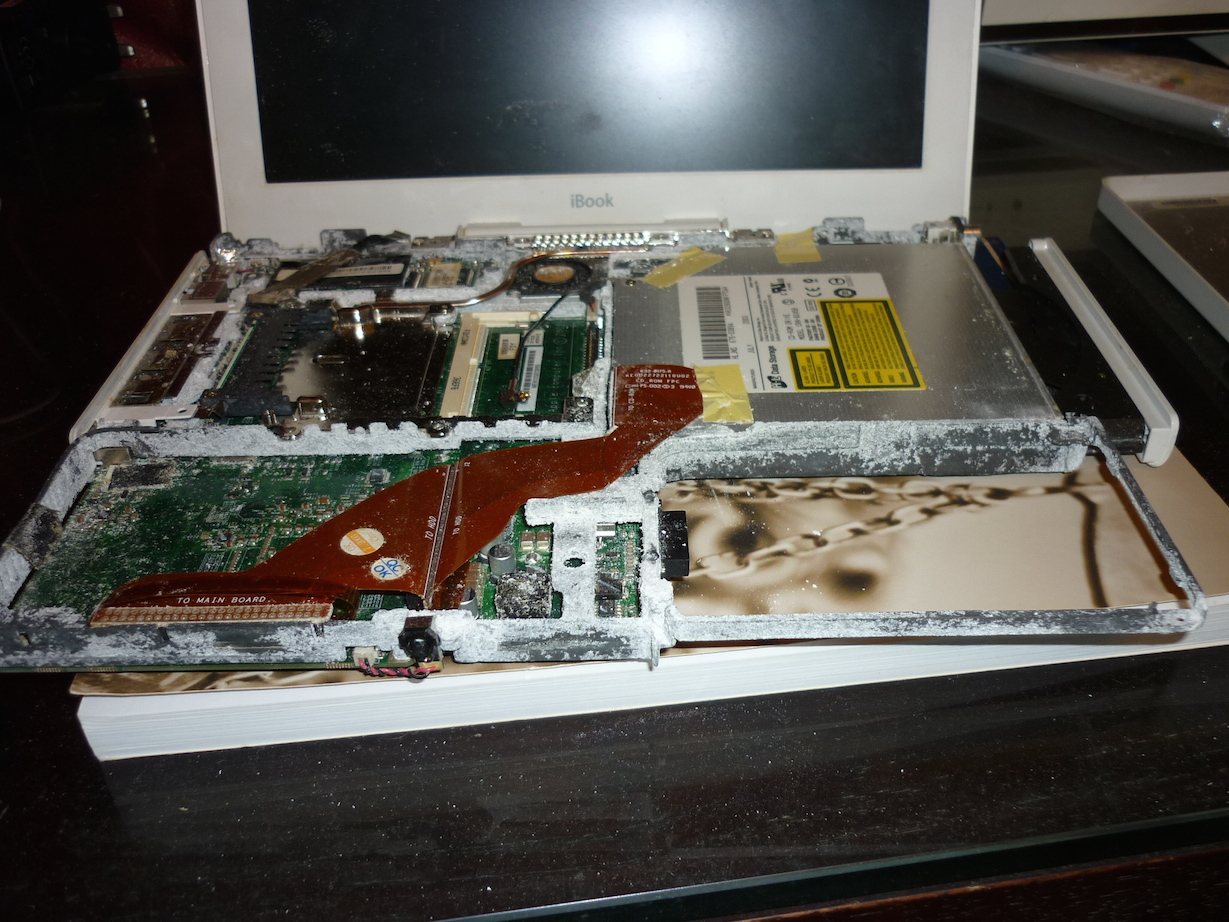

So what do you guys think ? is this mess worth cleaning up ? I certainly want to !
Will the fungers grow again ? Also the fan, dont know how to deal with it !

Tear the entire iBook down, buy some 91% or higher isopropyl alcohol, and scrub it all down with a toothbrush. As for the fan, the substance got into the bearings which is preventing the fan from spinning. I am not too sure if these fans can be taken apart to clean, but if they can, try it
The fans are cheap to replace in any case. It looks like some of that mutant vegetation has got into the LCD. That probably isn't fixable.
Ugh, that's just extremely nasty. Where did that iBook come from?! I honestly wouldn't bother, the nastiness and potential health risk aren't worth it IMO.

Looks like old cat spray. It gets crusty after a few years like that. Maybe the previous owner of the iBook had a lot of cats and didn't keep the place clean so for years the iBook just inhaled it and now, this.
Also the LCD looks like a cat has been laying on the lid and the pressure over time made it do that
Cat spray ? U mean its urine ? Owgh.$&@@>££¥€€, u just made me puke dude !!!
Me n cats are a no go! But if it was what u mentioned, there'd at least a fur or two in or on the ibook right ? There was none though.
Please undo wht u mentioned..🙁 I am having second thoughts now !

I was going to say that it looks like some sort of liquid spill to me with sugar "crystals" growing in it. If I wanted to salvage it, I'd probably be doing a complete tear-down(with gloves on!) and cleaning every part to death. Honestly, though, my inclination would be to junk it, and I say that having salvaged some pretty bad machines.

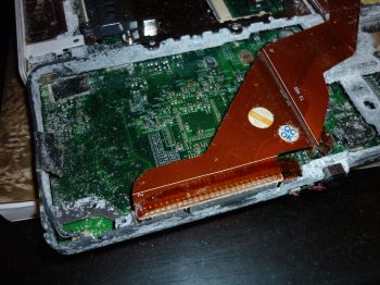

If it was a liquid spill, there must be something on the keyboard and the logic board, at least some rust. The logicboard and keyboard is speckless.
Also i saw a service sticker backdating to 2012, i broke the seal, which means this ibook must have been sitting around doing nothing for four years, the hdd must have been removed back then. Given its age and the non use, must have generated this funger !

Looks like it's from battery leaking, the current battery may be a replacement of that one.
Possible, thats what i initially thought.

I am just worried that if this thing is contagious and gets to another mac of mine.... That would be a disaster !

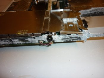

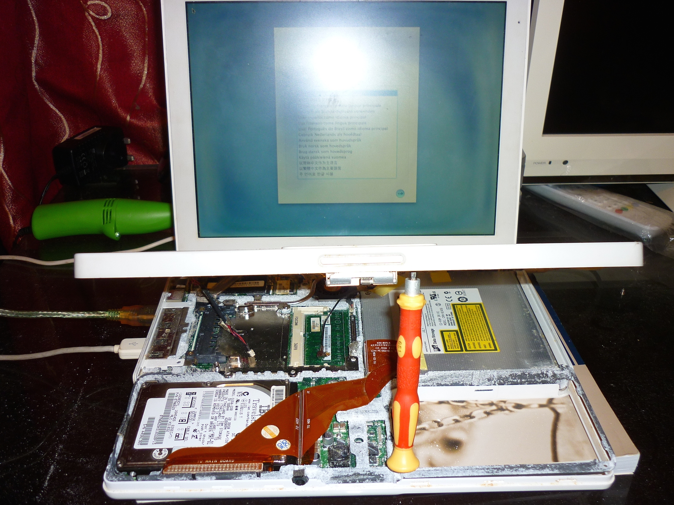

This is how it looks now. Feel like wannna soak it in some bleach! It is stubborn, using isopropyl first is not gonna do it easily.
