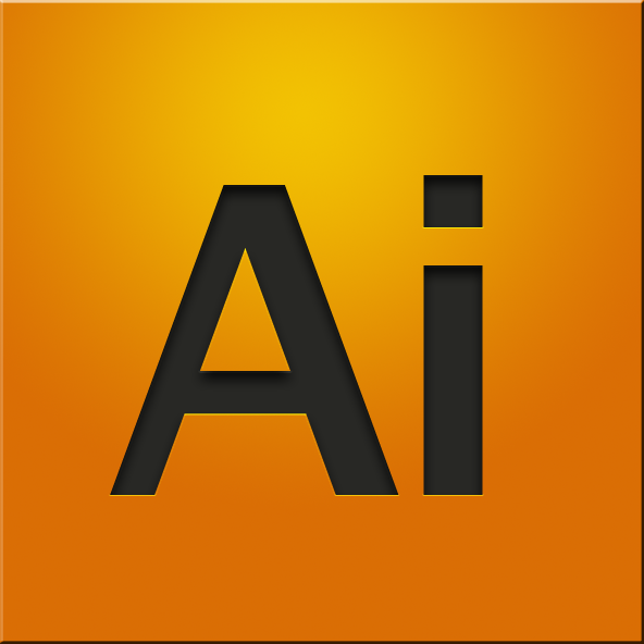

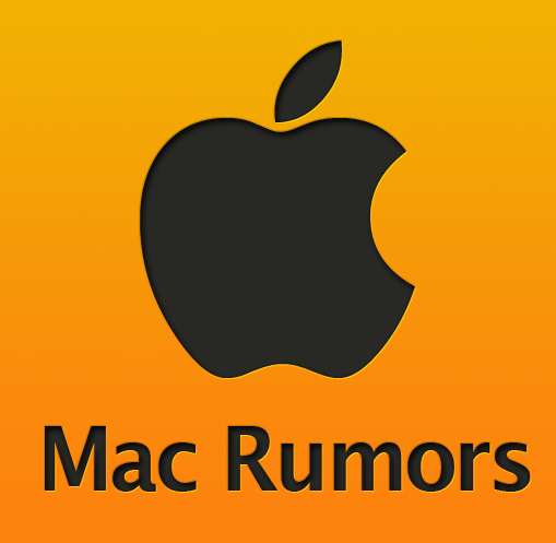

Would someone be kind enough to explain what the embossing technique is called, that Adobe use in their CS4 suite apps?. I know it is embossing, but it is as if the letters are embossed but also cut out, and there is a dark, transparent gradient behind them. Very nice, and I should like to use this idea.

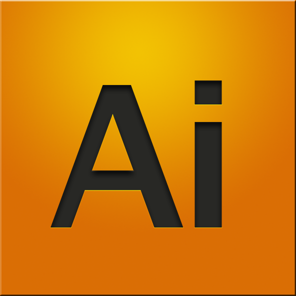

There's more going on there than just a drop/inner shadow. I had a few free moments so I took a stab at it:
It's all about the details, such as that tiny little hint of depth along the edge of the letters. Obviously, my recreation isn't entirely accurate, but I think it's passable.

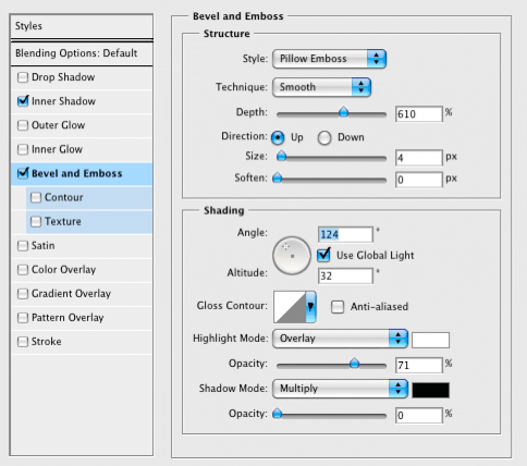

And just for reference, here are the bevel & emboss settings I used on "Hi". The inner shadow is pretty self explanatory so I won't post that:
Edit // Global Lighting isn't necessary. In fact, I turned it off for the inner shadow so that I could have it facing more downward.

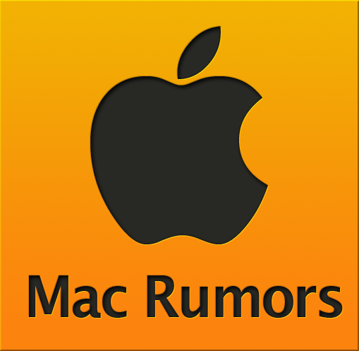

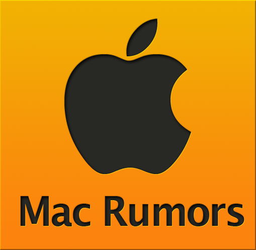

Here is my interpretation. I think Adobe used a RADIAL gradient to paint the foreground, to give the illusion of the logo being slightly curved... so I shall post that once I complete it 🙂
AS near as I can get to Adobe's badge; don't know the font, but oh well:

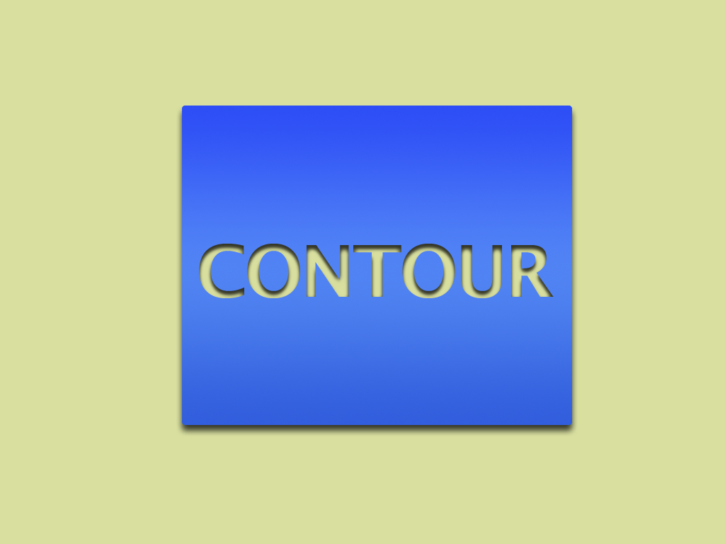

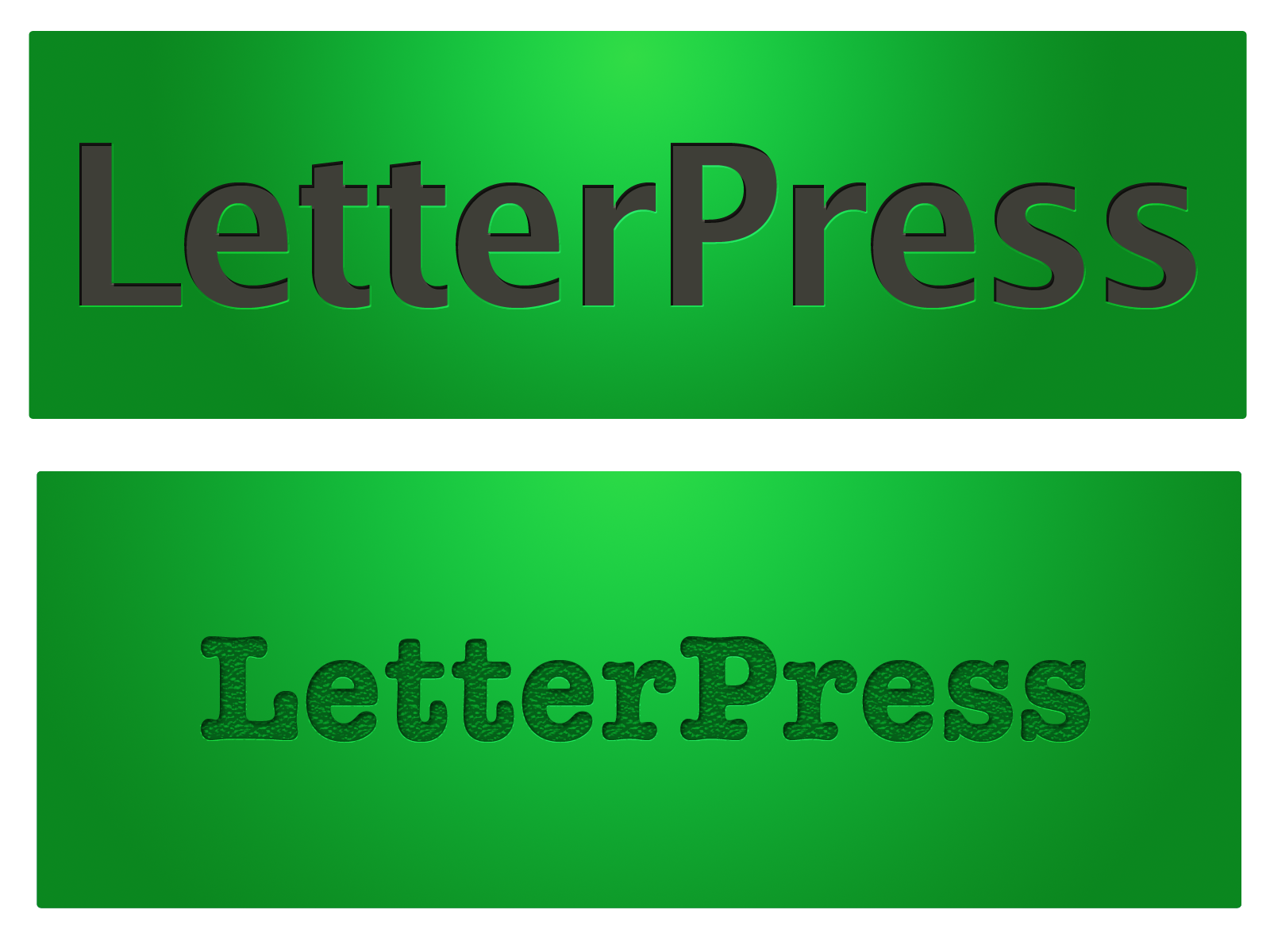

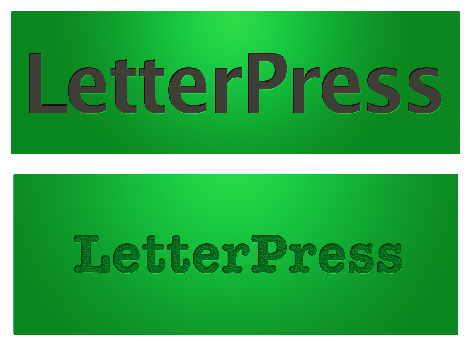

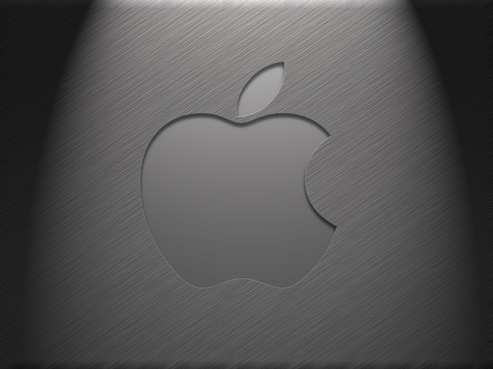

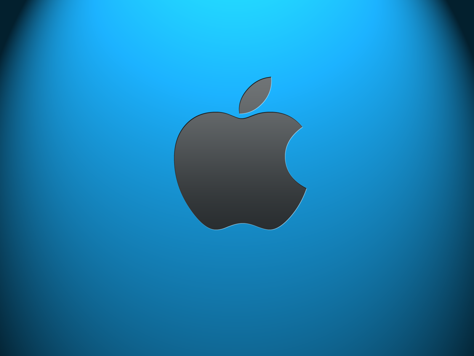

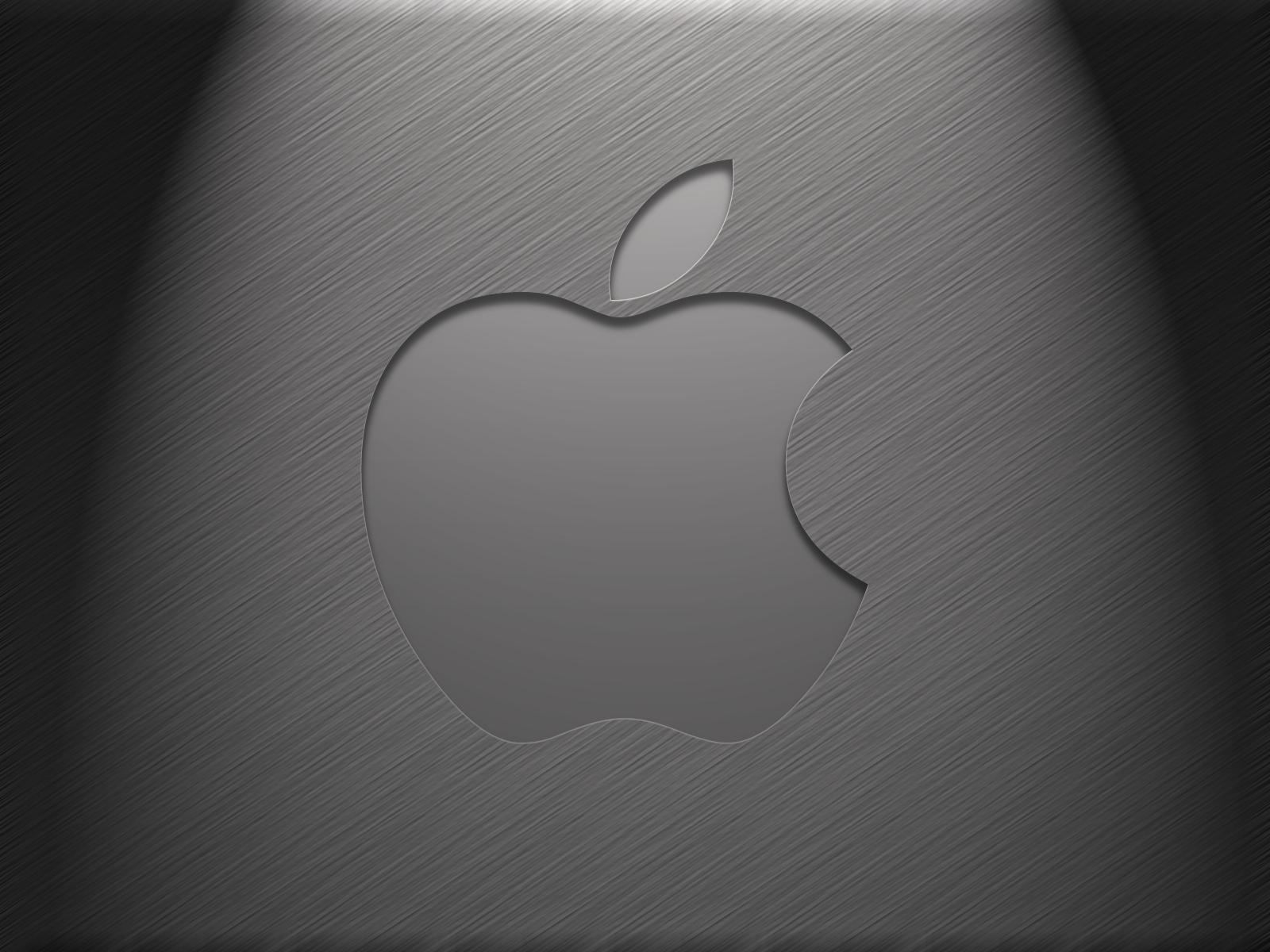

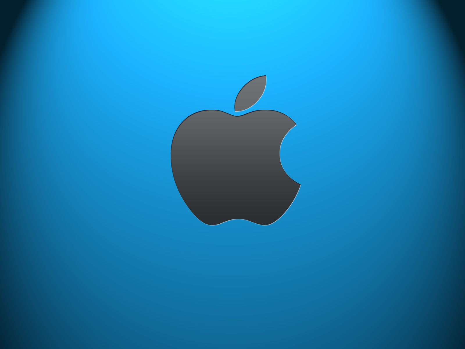

Another demo:
