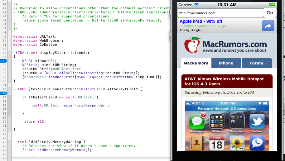

The code seems to work fine, see attachment.
What exactly is it doing that is not working on your end ? Since you just provided your IBAction code, there's not much to go on here to give you pointers.

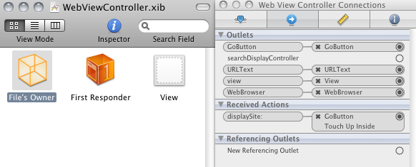

EDIT : Are all your connections in IB made ? I attached a screenshot of what I had to connect up. Also, you did declare the IBOutlets in your class implementation of the view controller ?
