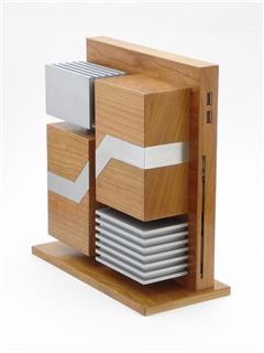

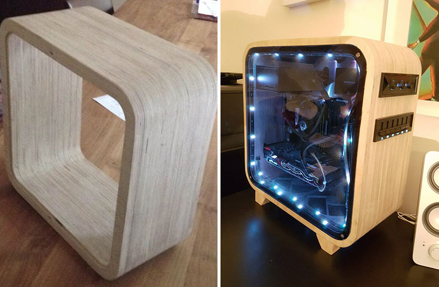

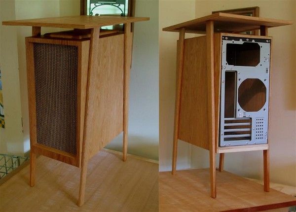

AESTHETICS
One way to escape the hideousness of PCs is a bit of custom craftmanship.
Custom PCs are a sounder economic value if not aesthetic value, unless you are ready to step up and become the poorman's Jony Ive. Or you can, as Frank Sinatra would say, (by way of Phil Hartman) 'Just put a bag over your PC and do your business.'
