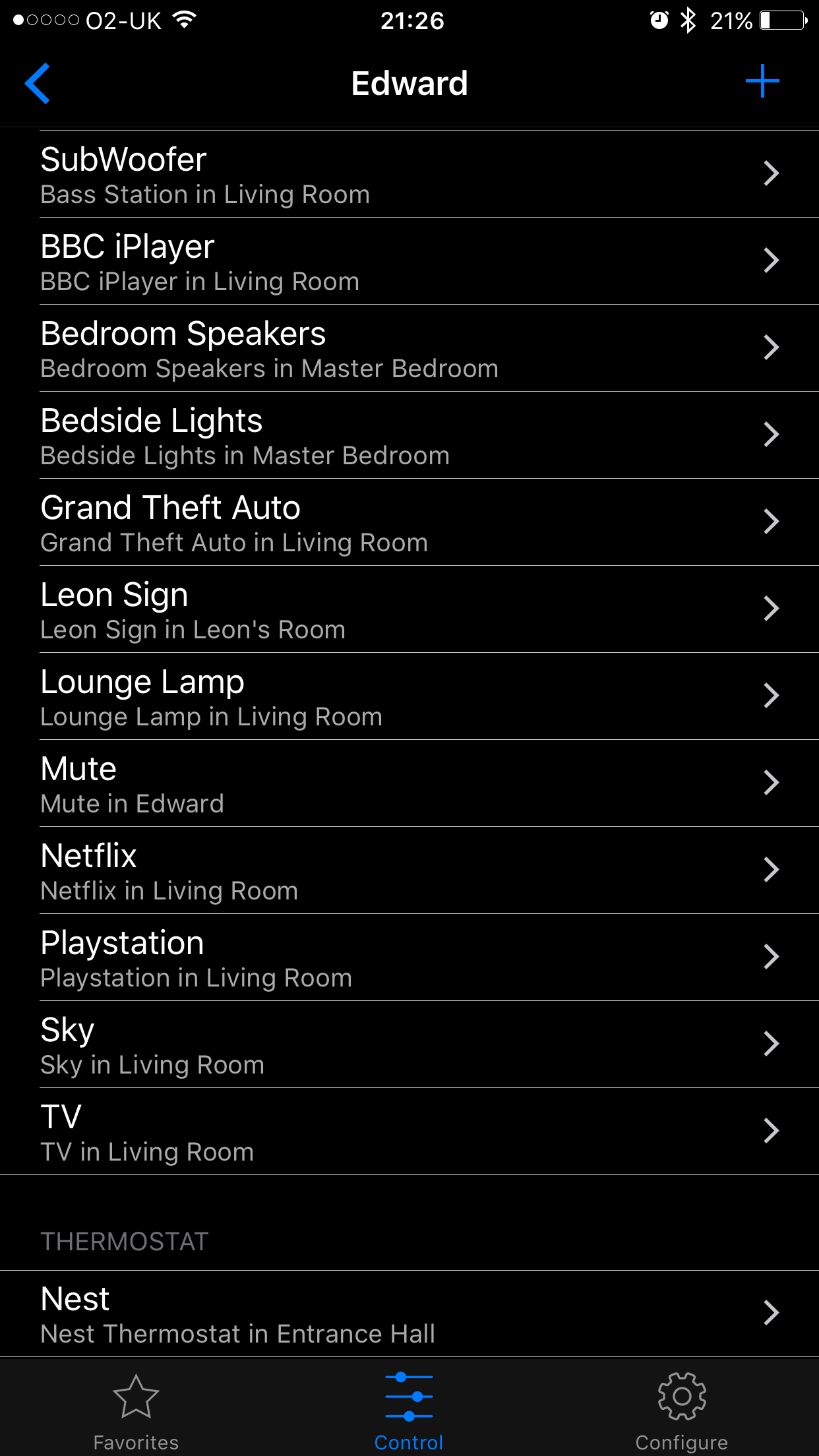

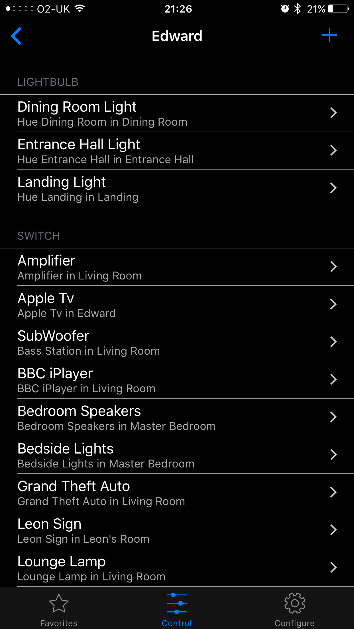

Easier to post a screen shot of my HMCatalog app :)
I have:
Philips Hue (New bridge)
2x Wemo Switches
Nest Gen2 Thermostat
Raspberry Pi2 running Homebridge
RedEye wifi infrared transmitter
433mhz plugs.
Loving the cmd plugin for Homebridge. Let's Siri execute command lines on the Raspberry Pi.
View attachment 621366 View attachment 621367

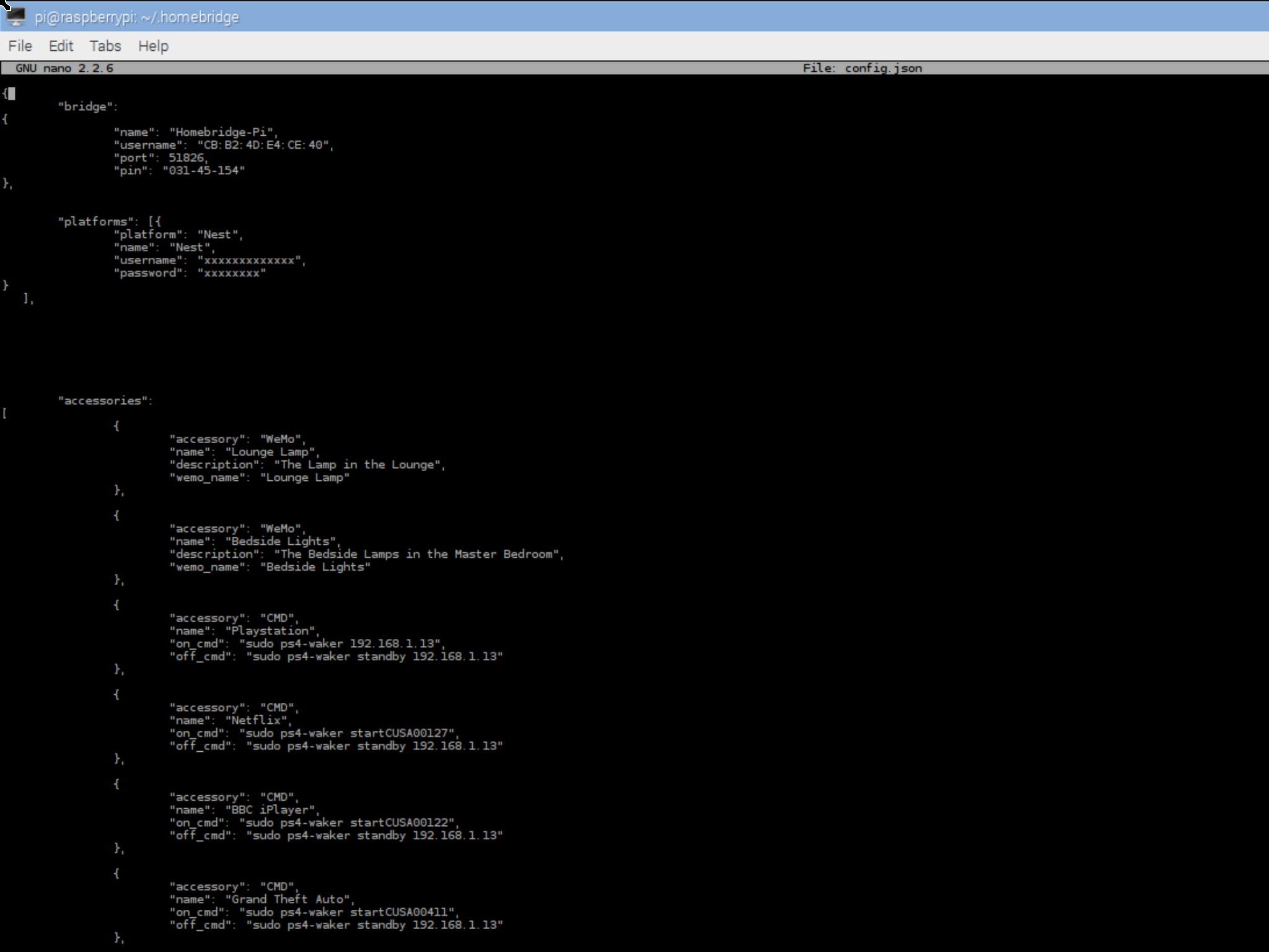

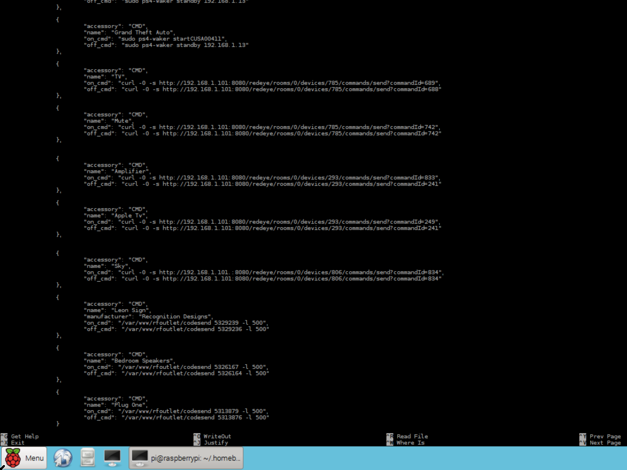

Here's my config.json file which might help explain some of this!
View attachment 622533 View attachment 622534

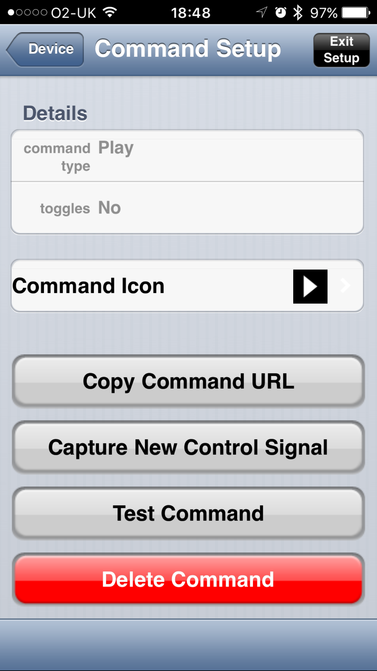

The HTTP commands can be found from within the RedEye app.
This is the code I use to turn my TV on/off using the CMD accessory and the RedEye:
Code:
"accessory": "CMD",
"name": "TV",
"on_cmd": "curl -0 -s
http://192.168.1.101:8080/redeye/rooms/0/devices/785/commands/send?commandId=689",
"off_cmd": "curl -0 -s
http://192.168.1.101:8080/redeye/rooms/0/devices/785/commands/send?commandId=688"
