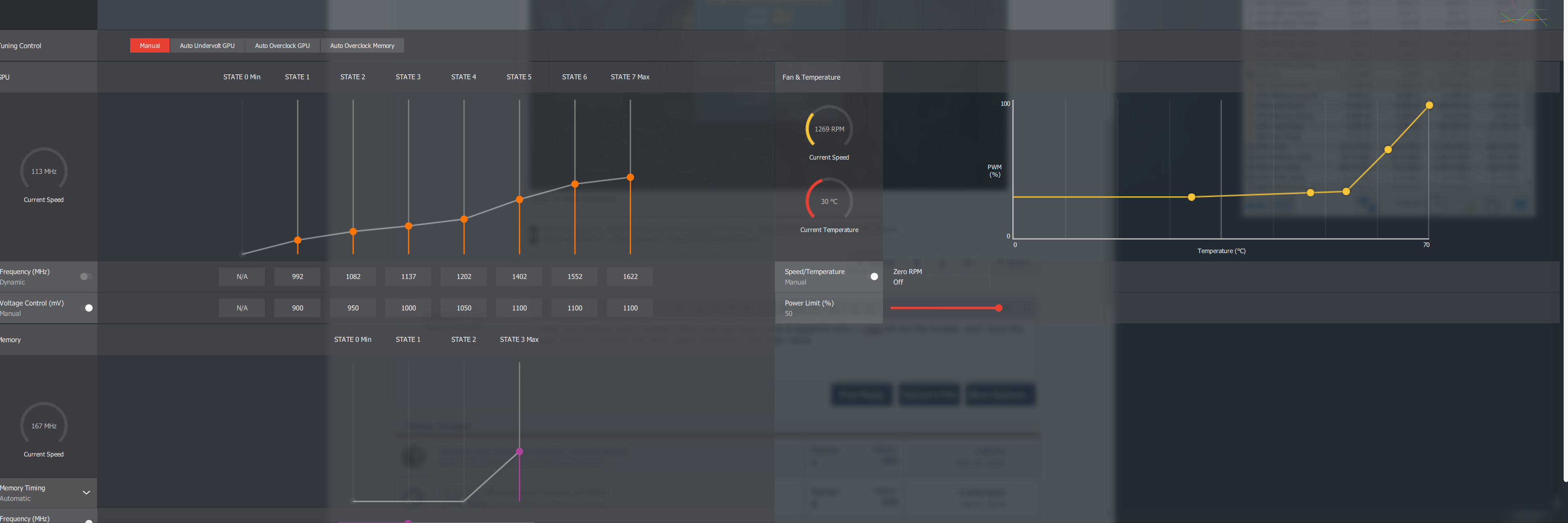

can you share your settings on wattman, to me is crashing when I overclock.

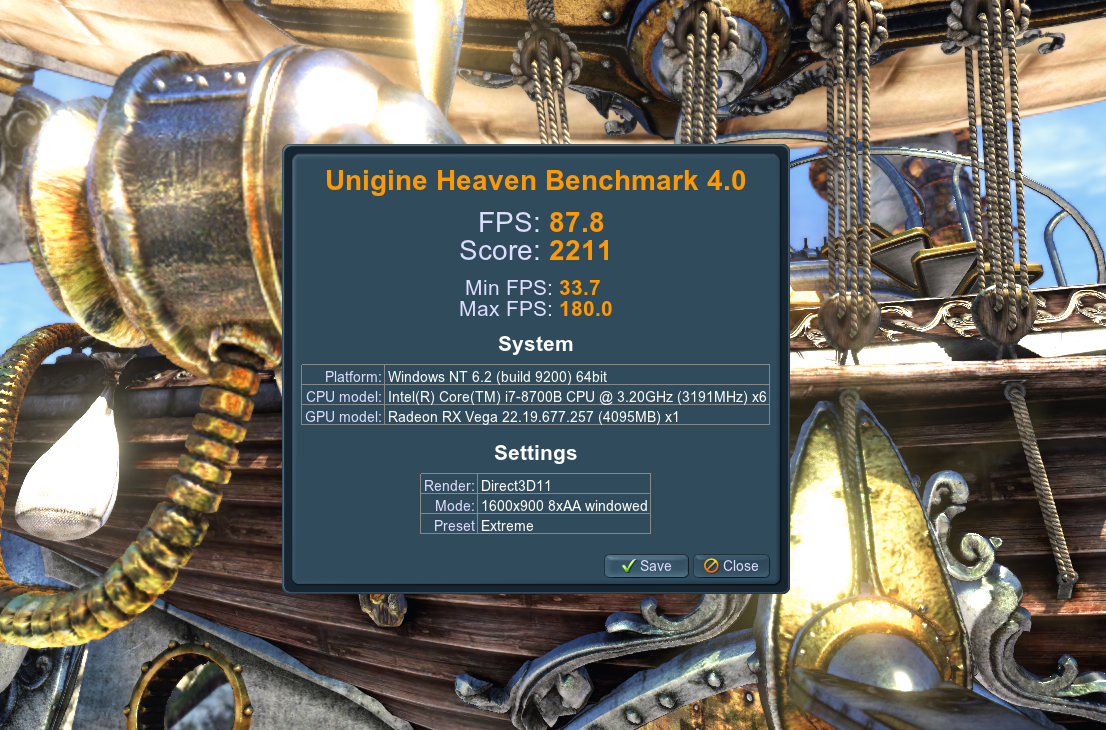

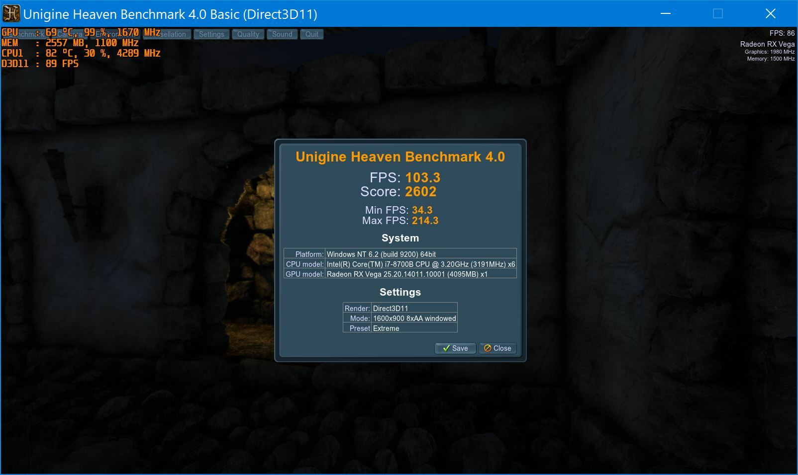

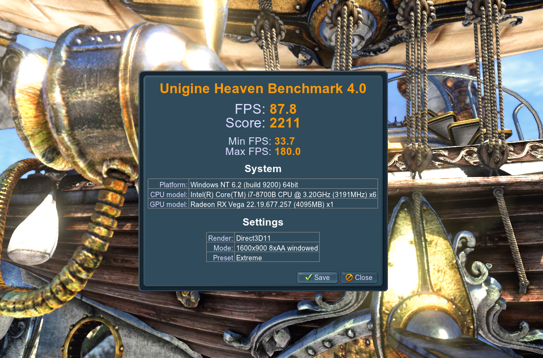

Unigine Heaven Windows10.png What are you guys getting with Unigine Heaven, I have a Vega 56 and with Extreme setting I get 1600 in Mac and 2200 in Windows. Mac score seems low?

gpu: 1602mhz 1050mv / 1702mhz 1150 (this is the two step clock curve in the old drivers, I'm currently on 18.12.1.1)
vram: 1100mhz 1050 mv
fan speed: automatic
temperature: automatic
power limit: +50%
vega 64 and windows

i tried your settings and i crushed. What card you have; mine is sapphire nitro + vega 64 not the limited., and i have the latest drivers. Currently the most stable overclock is this that i have.

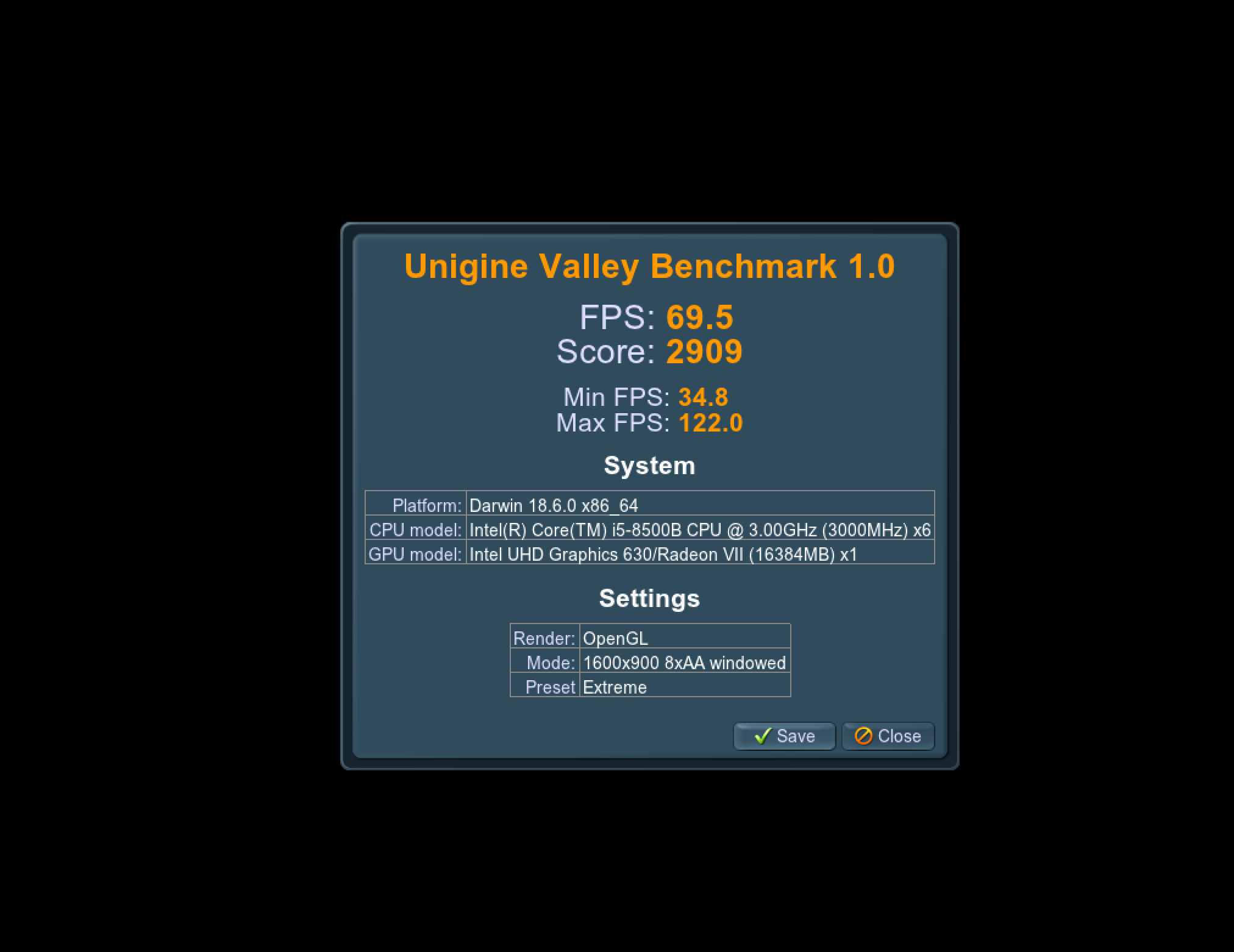

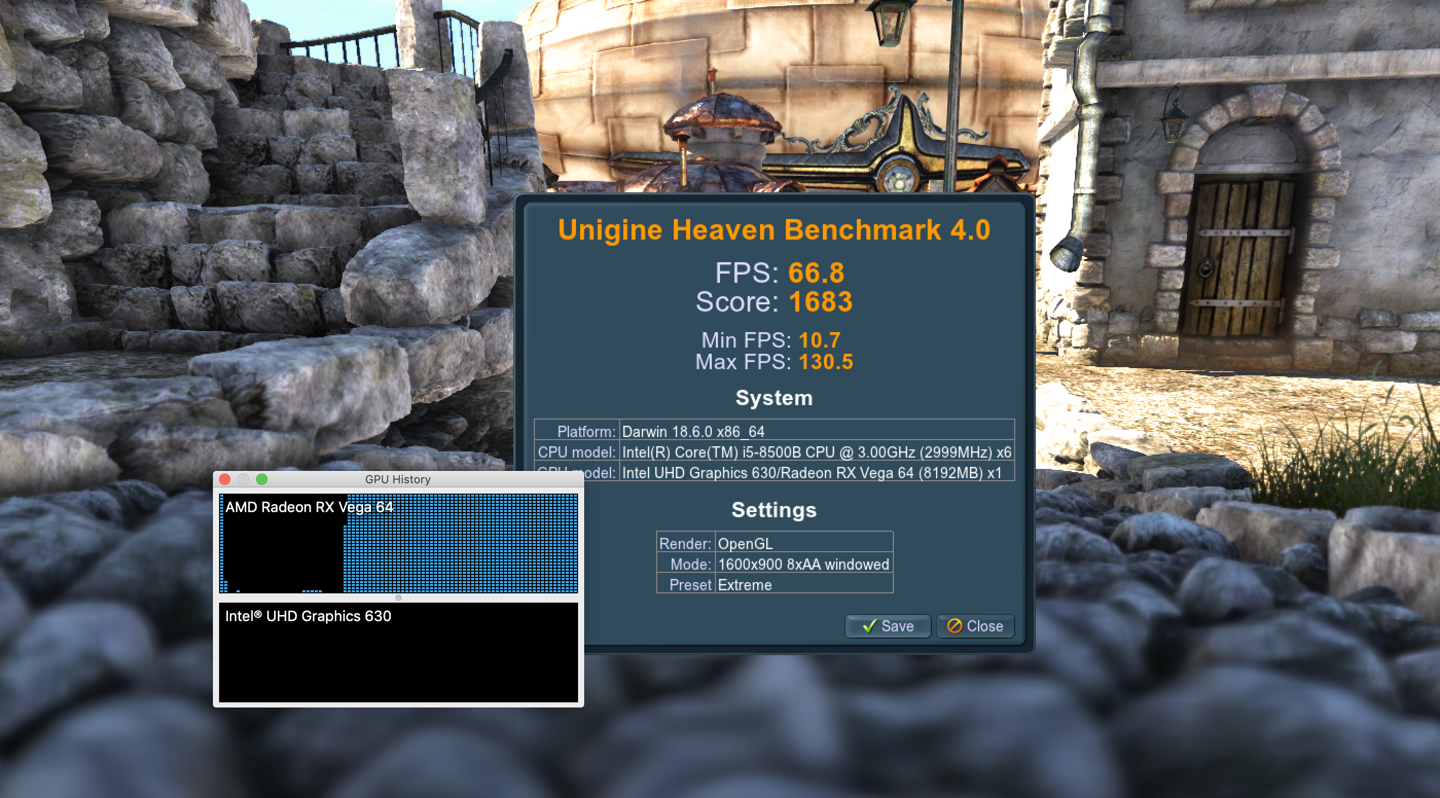

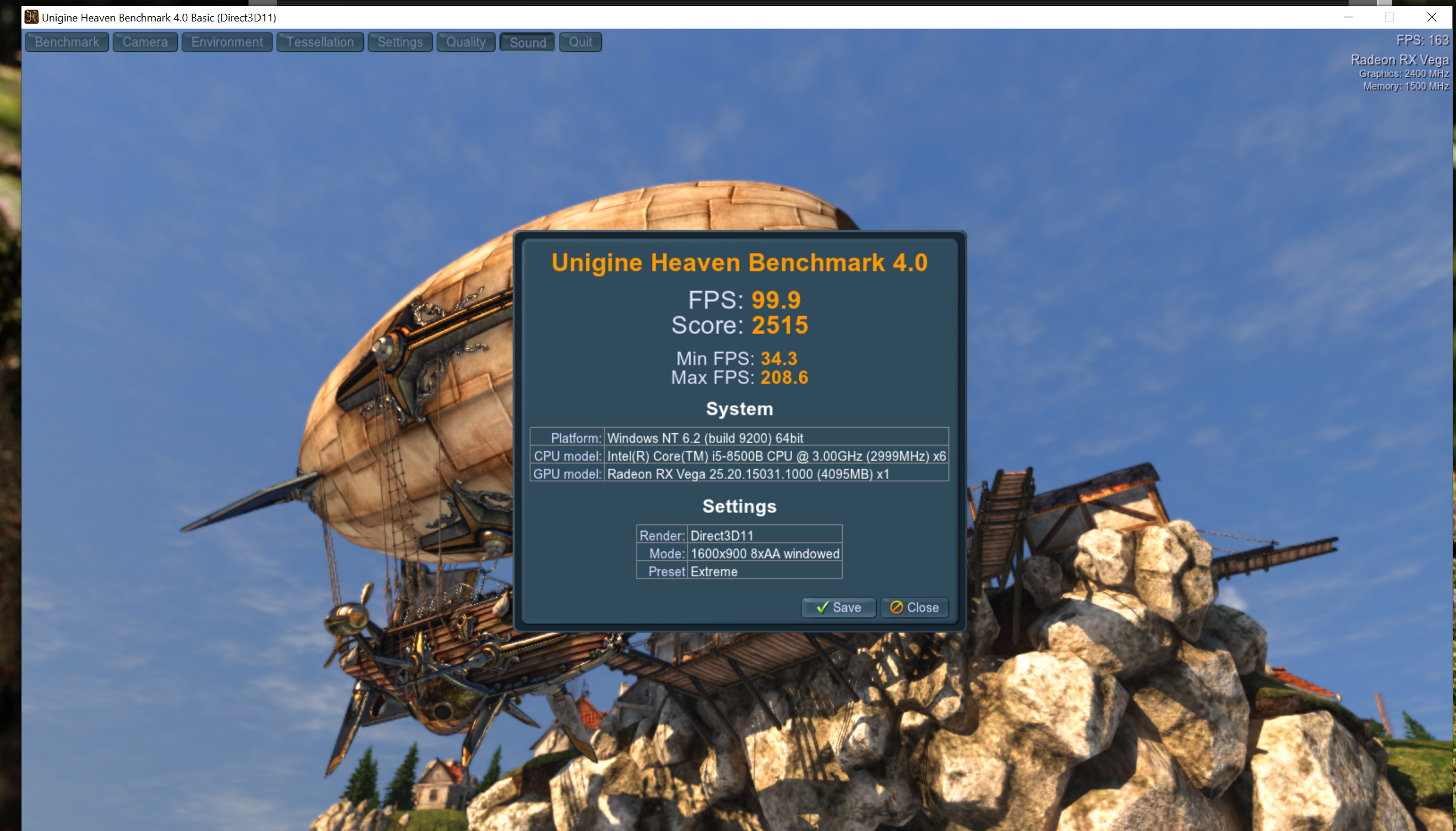

I don't know what I messed around with change the cards after the Vega 64 put it back again I have now low score on heaven.
Well looking at your pictures, your original run of Heaven was using Direct3D11 and your newest run was with OpenGL. That probably affected the results.
edit: Your Radeon VII score was also with OpenGL and it's only a bit higher than the Vega64 score using OpenGL. Did you try the Radeon VII using D3D?
Now I see, I was running the test on Mojave’s for this reason I have low score. No valley I rant only to Mojave’s on Radeon VII and as I can see has aLmost double from Vega 64. Anyway on time spy was very disappointed with 7200 only score plus was getting too hot 80 c and 113 on core. The Vega oc 66 and 83 on core.

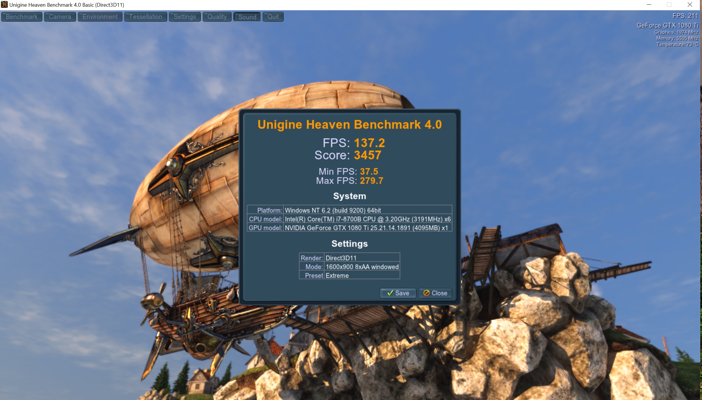

Well I installed Unigine Heaven and ran it on my system (in Win10).
This is at default clocks for my card (MSI GTX 1080Ti Gaming X 11G), which I think has a slight overclock OOTB. It turbo'ed up to core 1974/5505 effective memory.
Also tried with more of an OC at 2125/6000, but didn't really make a difference at this resolution as the FPS/score were virtually the same, only the min. FPS and max. FPS went up slightly.
Good score, Gtx 1080ti is a good card but i wanted to have something power for both windows and mac os. Was difficult to install the 1080ti on windows bootcamp or plug and play like amd?
