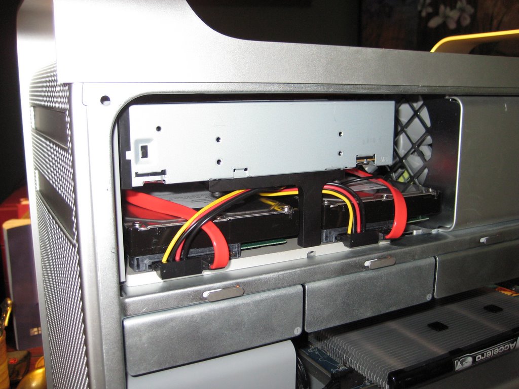

I'm assuming you need an adapter, does the maxupgrades kit come with one?
I believe it comes with the enclosure, 2 SATA trays, and 2 SATA cables to attach to the motherboard - in this configuration, you still use the ATA connector for your SuperDrive, so I will lose out on the ability to install a SATA DVD burner (Blu-Ray) in the future.
I'm not concerned about that - it's much more important to me to have 6 internal drive bays. I'll post pics soon.

Pics and review are up...
I got the MaxConnect kit installed yesterday, if you're curious. I now have 6 drives installed with good ventilation. Pictorial install guide and review here:
