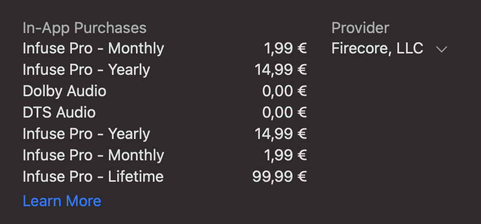

Can I play Dolby Atmos mkv files with AirPods Pro 3 by any chance on Sequoia 15.7? Alternatively through the 3.5mm jack?
QuickTime won't play it and VLC doesn't support it. Is Infuse the only option? Will the lifetime license give me access to Dolby or will I need to subscribe? I see in-app purchase for Dolby listed as 0.00€ in the Mac App Store
