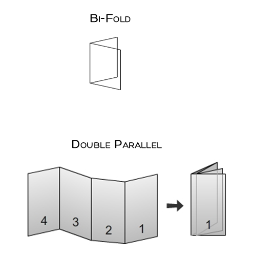

Sorry citizenzen have to disagree with you on this one, been in the printing industry 39 years and a double parallel is certainly not a bi-fold, nor does a double parallel fold create 3 panels but it creates 4 panels when unfolded.
I'm always up for learning something new.
So his bi-fold brochure is a letter-sized piece of paper folded in half ... I'm assuming to create a 5.5" wide x 8.5" high brochure.
