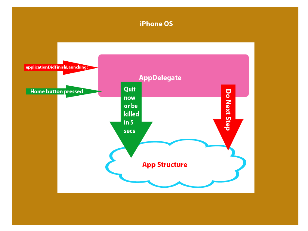

    BRILLIANT analogies!. I can feel the mental fog lifting with every post; clarity is enhanced as I absorb more, so please do carry on. I think I'm going to draw us a diagram of how I interpret this, so you can tell me if I am correct or not.
    Thanks for the time folks - appreciated a LOT.
    [EDIT] This is how I perceive what you have taught me - please correct me:
    [​IMG]
