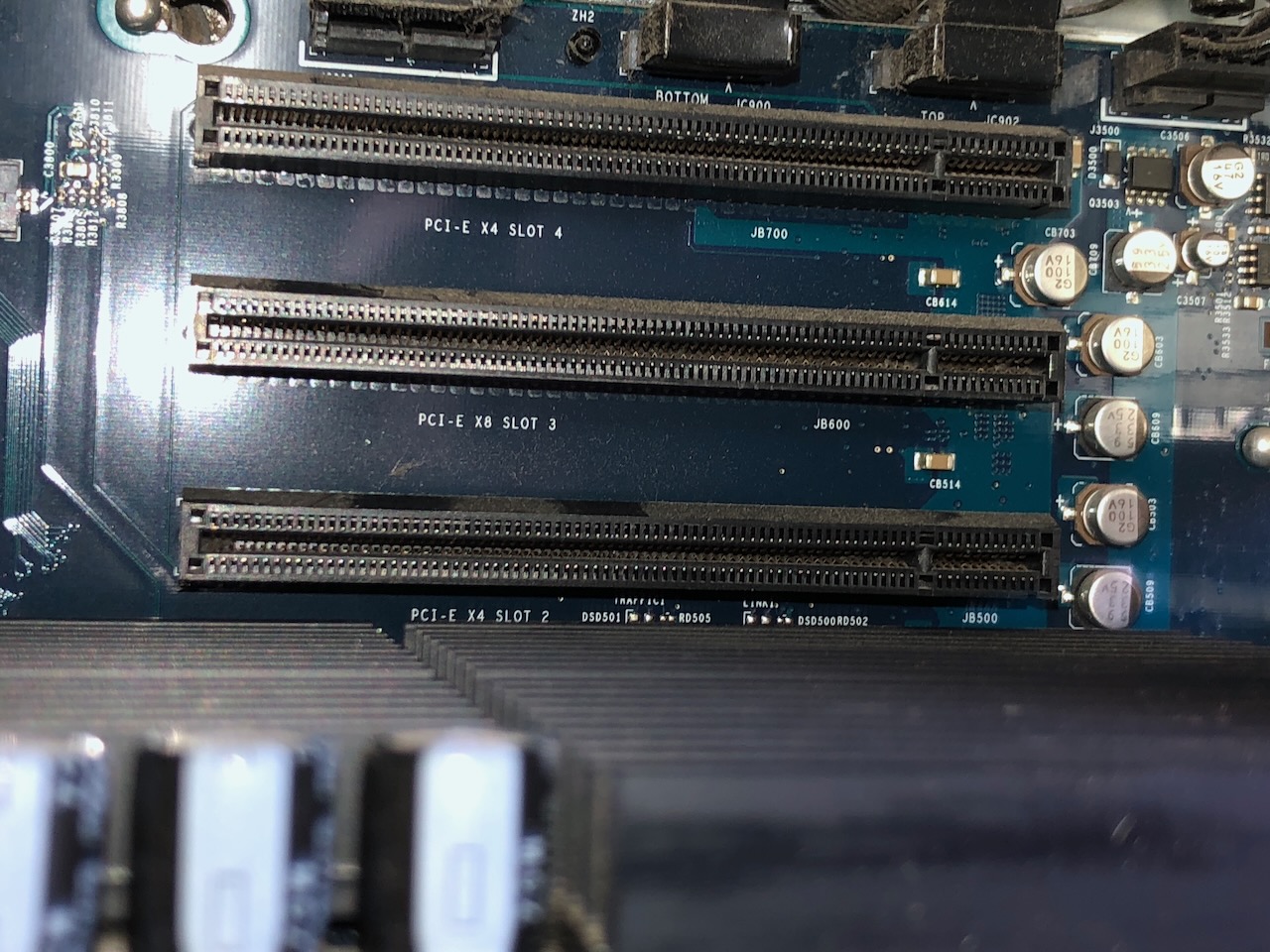

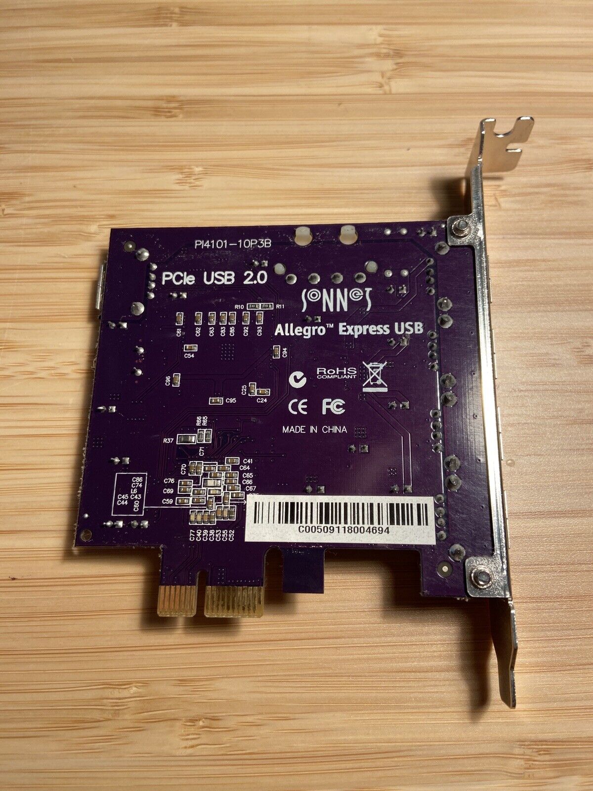

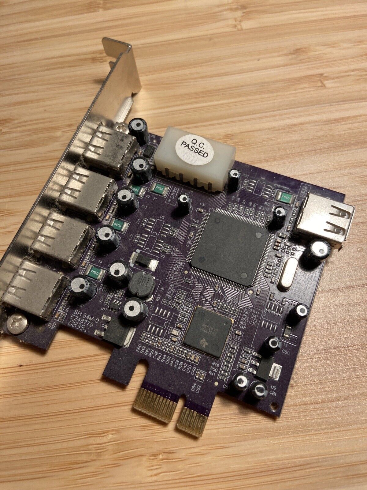

I'd like to add more USB 2.0 ports to my Powermac G5. I've tried 2 PCI cards already, but they both don't fit. Does anyone out here know what card I can buy that actually fits (and works)? Slots say: PCI-E X4 and PCI-E X8 ...
