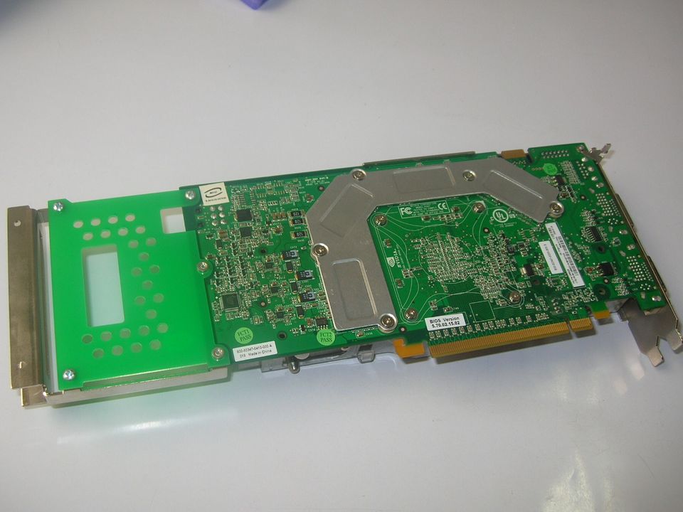

MacVidCards, you are the expert: Do you know if anyone has had success in flashing a Quadro FX4500 to work in a PCIe G5 if the Quadro does not have the silver metal on the bottom (with and without metal demonstrated in pictures).
With:
Without:
As far as I know, nobody successfully flashed model without RAM chips on both sides. Silver metal is heatsink for memory chips on that side, and that is model you want to flash.
What bax2003 said. "Single sided" for MP, "double sided" for G5.
