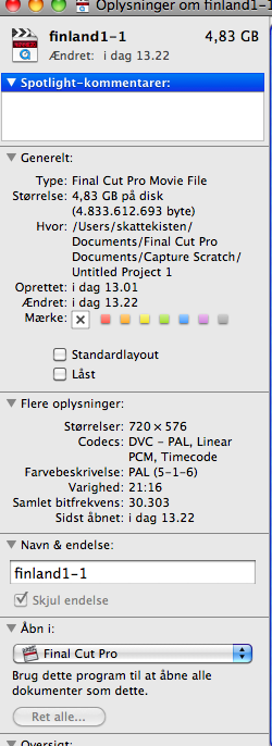

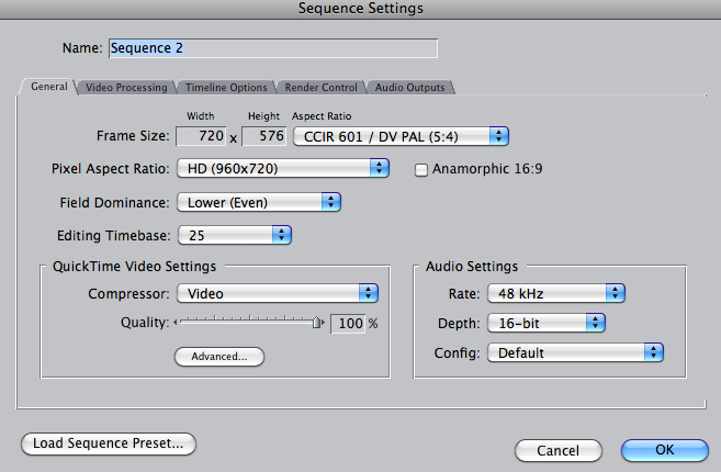

I'm new to this forum and might be a total idiot. Well, i recorded some footage on this Sony DV camera and want to begin editing it. But i really can't find the sequence settings for my clips; the frame is way too big or way too small no matter what i try. So im kind of stumped.
I've attached a screenshot of the file info and a screenshot of my current settings (which is very random). Perhaps some FCP wizard in here can help me out.

Edit: Oh yeah, and sorry for the file info being in danish.

the settings in the camera are shot in 480 and maybe your viewer in FCP is either 720 or 1080. You can make the image bigger but it will be pixelated.
Open up your sequence settings and hit the button in the lower left called "load sequence presets". From the menu choose DV PAL 48kHz. That will change the sequence to the correct settings for your footage. You footage might still looked messed up though. If it does select everything in your timeline (command + A), right click on any selected clip, choose "remove attributes" and check "basic motion" and "distort" then hit okay.
In the future you can just use the DV PAL Easy Setup to properly setup your project for DV PAL footage.

In your home made sequence Setting you have screwed up the Pixel Aspect Ratio.
As mentioned before, simply use DV PAL from the ready made presets. If you don't see the warning that your footage doesn't match your timeline settings, check your FCP preferences (can't remember which tab). You might have set the warning to "off".
