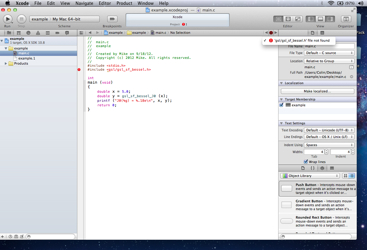

Thanks for your example. I am following what you did in terminal, does it look like it is installed?

But I still get an error within the editor saying file not found. I am attaching a screenshot what I am seeing in XCode.
I think gsl is installed, when I try "info gsl", there is the manual.
But my question is, where is gsl inside my computer? I guess it comes with Mac Port? So, do I just go into Mac Port copy and paste the file into my code?
So, do I have to just set the directory? I am kind of lost.
