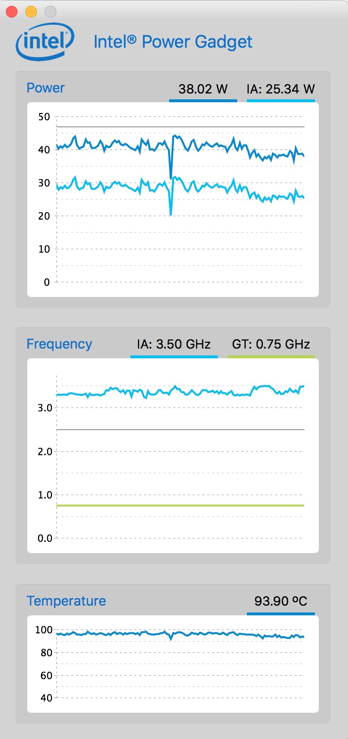

This is running a Windows 10 Pro x64 VM with "4" 2+2 cores to the physical and "4" 2+2 to the virtual while I was crunching some numbers (so mainly this is CPU heat as the GPU wasn't doing a tremendous lot given it was a VM and the UI was stripped of all of the visualizations that normally eat up resources.) I did not expect it to hold quite at 3.35-3.5, but the temps are about maxed at this point, and both fans were at 6200 RPM. If I was doing work that caused significant GPU heat (or if the battery wasn't already charged and hence I was getting some charging heat), I assume I would then see more of a scale back with the CPU in order to reduce overall heat...?

Those graphs actually look pretty good to me, Zap. My 2016 will run 3 GHz for well over two hours with all cores maxed while running Handbrake. At no point did it switch from the integrated 530 graphics to the Radeon 460 I have, I watched closely to see if it would utilize the dGPU, it didn't. Perhaps that's unsurprising, given there was no real computational work taking place. Also the GPU temps didn't go up much, only the CPU did.
Without getting more actual CPU speeds from 2016 owners, it's hard to deduce what might be going on with my system. What's clear, though, is that it will easily run at it's rated 2.9GHz base clock for extended periods of time, fully loaded on all cores. Temps will go as high as 93 Celsius and the fans will spin to just shy of 6,000 rpm. The left is always 300-400 rpm faster than the right, too.
However, given that your 2014 unit will not only turbo higher, but also sustain higher turbo speeds than my 2016 will, clearly shows that heat is a factor. What upsets me is the thought that perhaps a base 2.6 i7 might just as easily have gone to and sustained 3 GHz for such tasks, making my upgrade a complete waste of money.

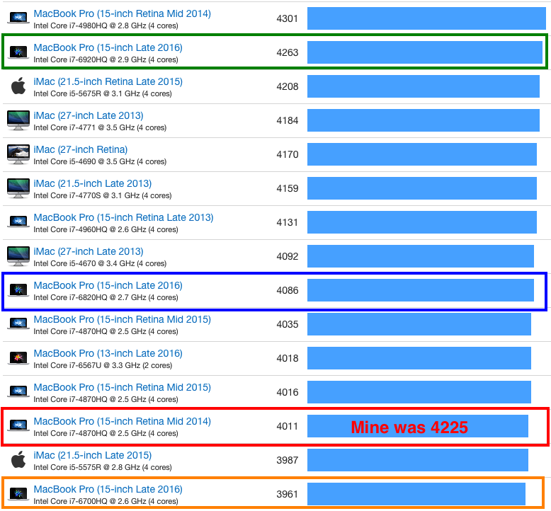

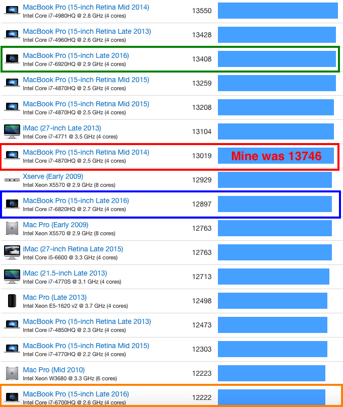

At least looking at GB averages, there appears to be a pretty significant difference between the 2.6/2.7 and 2.9? I also noticed that my scores are different than the average on GB, especially the multicore score. Assuming that GB results are automatically set to drop any sample where something is clearly outside the theoretical peak for that system as well as drop any sample where the results are so low it indicates a major problem with that specific system's hardware, does that indicate binning variations among individual specimens?

Yours has more L3 cache. There's more to speed than clock. The one you should compare to is the 2.7, which has the same L3 cache. Chances are high that yours is still faster, though.
Fair point
Mine is actually benching well above those indicative scores, on the single thread test anyway, so yeah I'm guessing there is a fair bit of variation, not only between various chips, but also from run-to-run, I've seen my own scores fluctuate a bit too.
I have always scored higher on GB MAC average listings. From my iMac to my MBP's. I am not sure how they calculate the average but if some users perform the test while the MAC has many open processes or it is indexing from new it will produce a lower score, which you can see on many registered scores for the specific model.

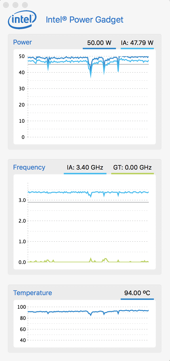

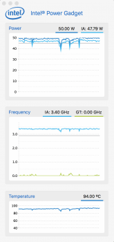

I've tried various benchmark tests and real world tests but absolutely nothing will make this machine go over 3.4 - 3.45GHz, which is its max turbo speed for all 4 cores being loaded. Disappointing that with even single core loads it will not go any faster, though.
