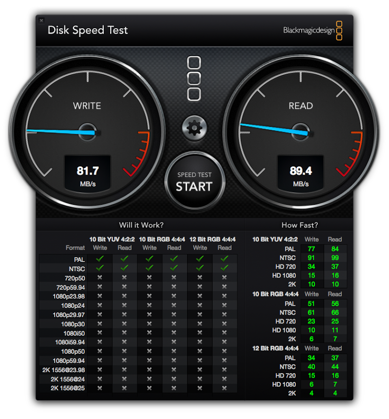

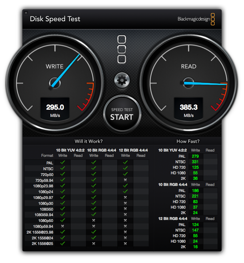

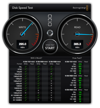

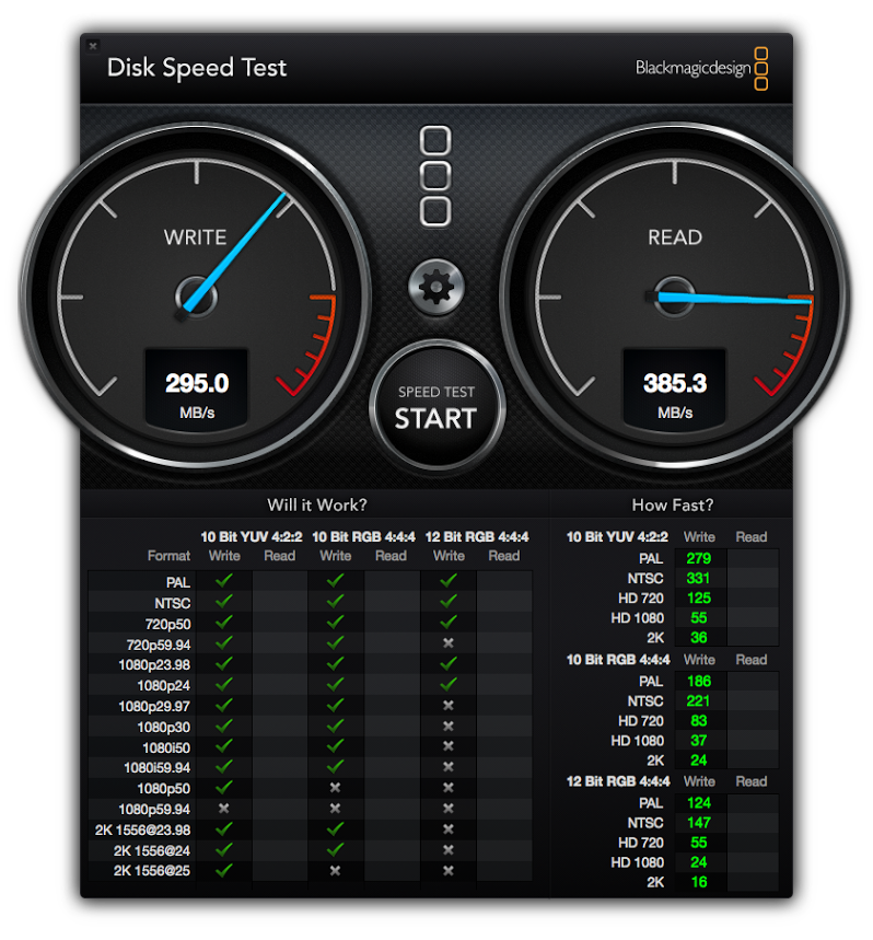

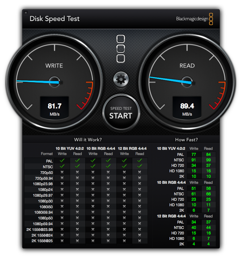

Just to follow up...thanks again for all the info. I received the transcend 250GB drive yesterday and its up and running. I first tried a clean install, but it appeared it was going to be tedious moving all the data I wanted to move without losing track or messing something up. I was able to us CCC and deselect my larger files (which ended up being photos and surprisingly my iphone backups among others). I ended up with a relatively small clone of 60GB or so (from a 1Tb HDD with 550GB of data). Boots are very fast and apps are opening faster, but my most used apps tend to have the larger libraries which are still on the HDD so some of them are still slow though not the fault of the drive itself.
I think I'm going to keep the internal as is for awhile to make sure there aren't any issues. I like knowing I can always go right back to where I was.
Read/Write speeds of HDD vs SSD are attached. Cannot comment on heat yet as the drive has yet to see much use. I'll comment later on that I guess.
Now onto a USB 3.0 solution so I can offload my photos and run more effective.
