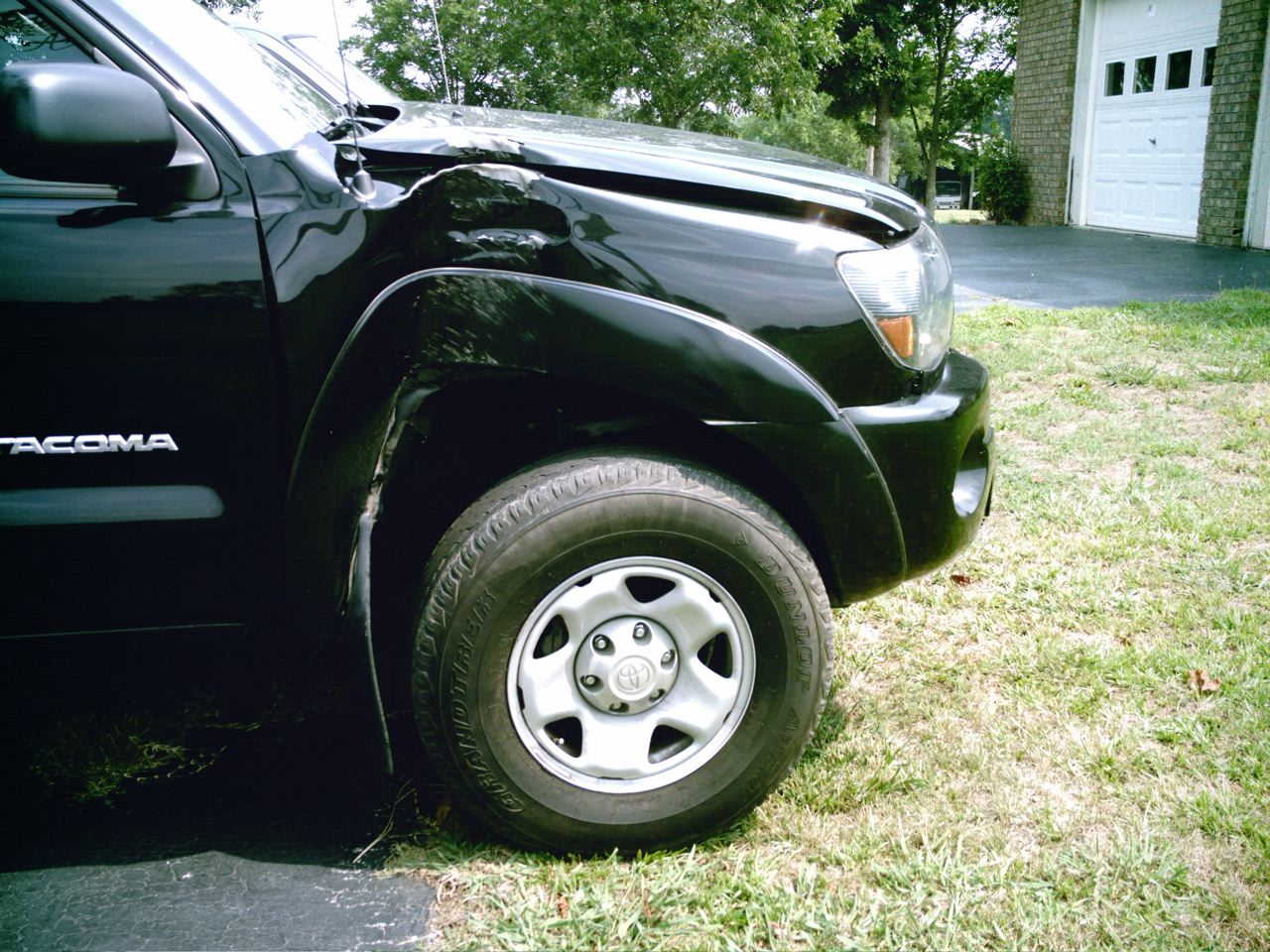

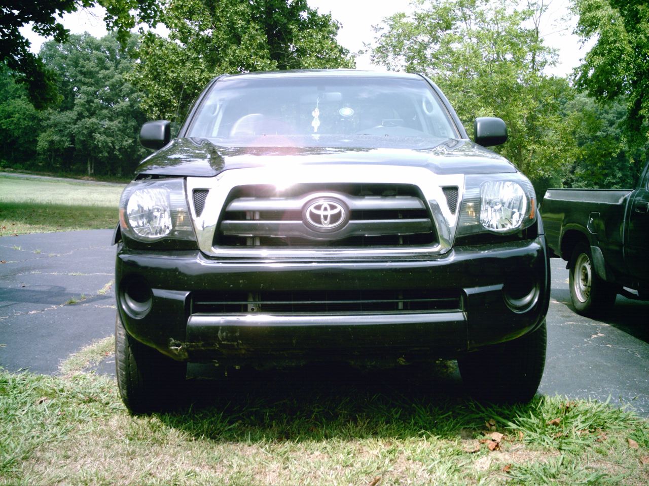

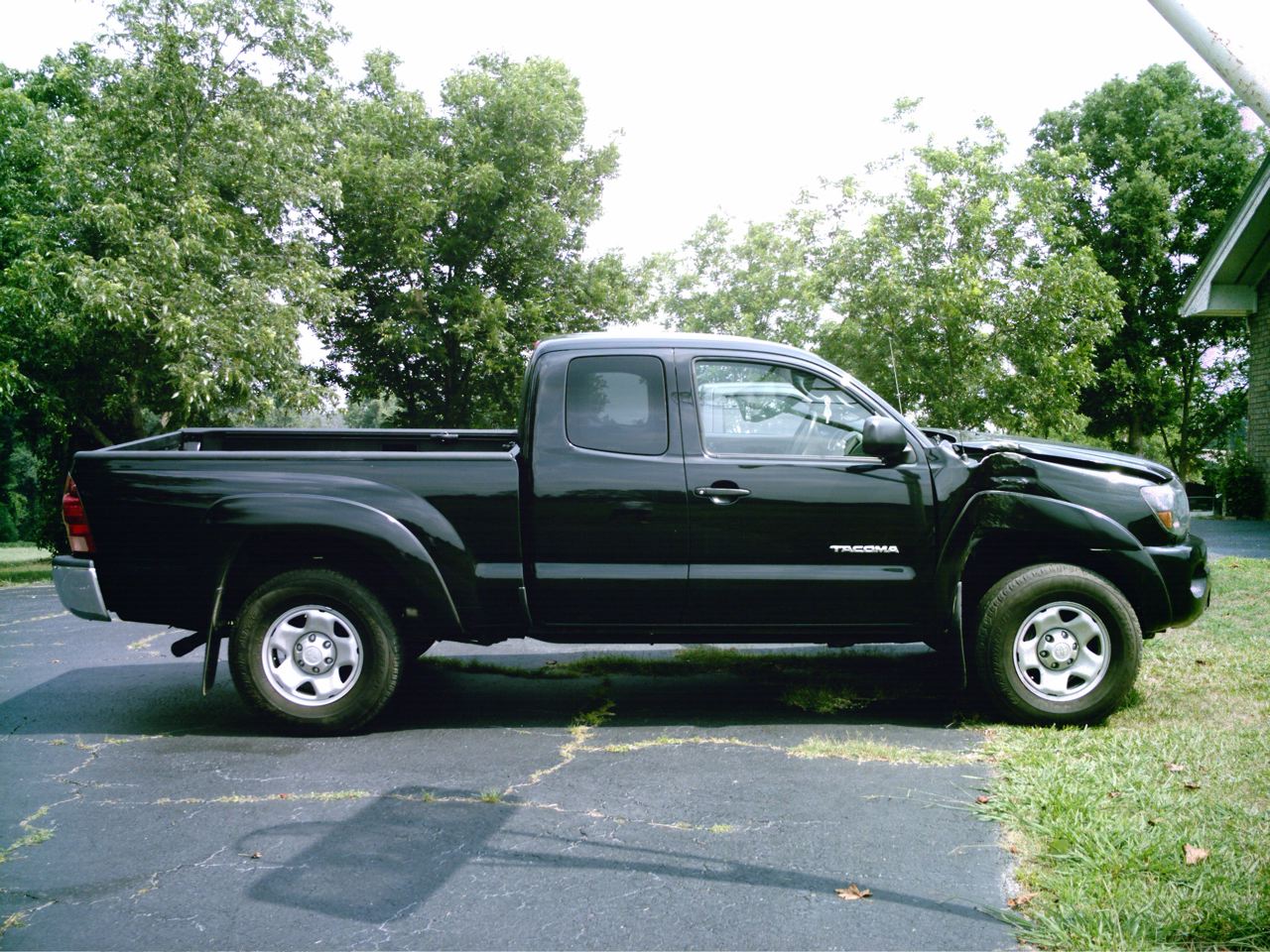

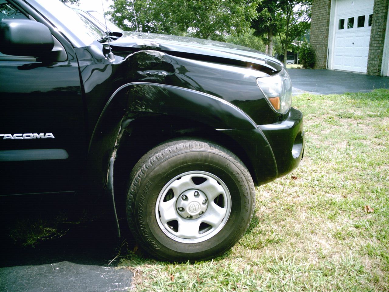

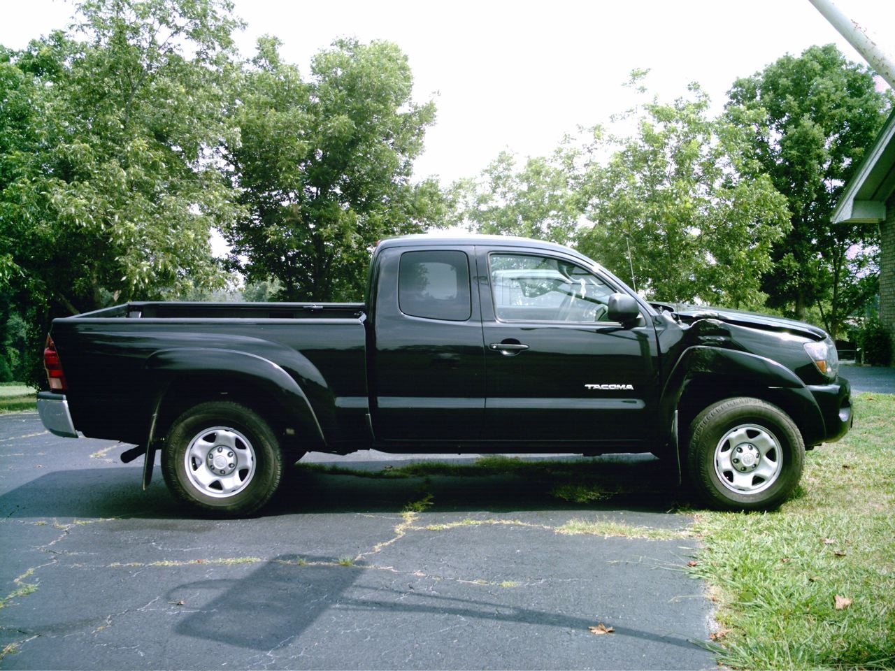

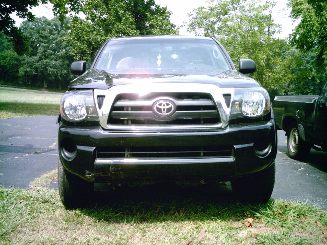

here are photos of the damage:

Doesn't look too bad. If there's nothing mechanical, I'd just drive it as is and save up for the repair. If you don't want to fix the cosmetics, then I say list it on Craigslist for $8000 - there are plenty of body guys who would take that in a hearbeat.
That side view makes your truck look like it's doing an Elvis impersonation.

thanks. the only thing really wrong is that i have to turn the steering wheel about 10 degrees to the left to drive straight.

Not good...Anything affecting alignment and/or the axle can be dangerous. And I upped it to $8K, figure you will haggle on price a little.

Even the dealer should have an unpainted fender in primer for 250, and a new hood for about 340.
Might get lucky and find a used black of each.
If they don't have them in the local database they can order a part also.
Heck if you have a friend who can paint you can probably get a hood, fender, and flare all painted for not too much. Though if you want color sanding and a mirror finish, it might cost a bit more.
As far as the alignment, you can take that to a shop to have them fix that all on its lonesome also. Probably have some good Toyota or truck repair shops around.
Though if you were nitpicky pulling the front off to fix the light can alignment would probably be a PIA.

yeah, it's not good. i tried to get another estimate, but this guy said that the frame was bent, and he didn't have a frame puller, so he couldn't give an estimate. the other guy said it was the 'knee' (part the attaches to the frame) so know i don't know which is right.

So your choice is lose $6k, aka and roll that loss into paying for another car.
Or take the truck to a full service front end shop or a truck shop to see what can be done on it.
If the lower control arm is bent replace it, then align it.
If a mounting bracket is bent badly I'm sure a suspension place could have it cut off and replaced.
Fixing the passenger's side corner wheel will probably be a lot less expensive that selling it and buying another vehicle.
If nothing is wrong besides the control arm, $100 arm + misc parts + labor and an alignment might be a easier pill to swallow than paying somebody $6k to get rid of the problem (aka, grab ankles and take the loss.)
Edit: and I've noticed on cars sent to unibody shops with frames, every frame vehicle almost always includes a bit of labor for frame repair which is hardly ever done. Someone backs into you and bends the rear bumper, cracks a tail light and dents the rear. You'll likely find an hour of "frame repair" on the invoice.
