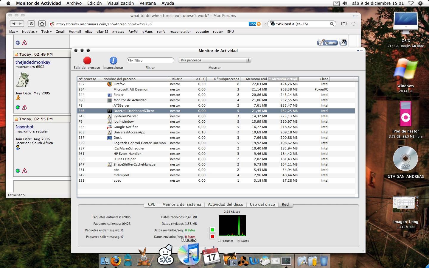

i tried that. this is how it looks. there's no itunes process shown on activity monitor but the black arrow below the itunes icon in the dock still appears. i can't run itunes and can't quit it.
Have you tried killing the iTunes Helper (258)? As a minimum, try repairing permissions when you finally kill iTunes, perhaps even doing it from the OS X Install DVD.
Maybe change "Mis Processes" to "All Processes"? I don't think that will help, but maybe. Next would be to list the processes in the Terminal... it is the 'ps' command but it is a little tricky to get it to list everything that is running/stuck ... i'll check the manual page and see if I can find it.
{edit ... good advice, skunk ... try killing the helper!}
killing the helper or showing all the processes doesn't help. reboot is the only thing that worked. hope this issue doesn't get common. thanks for the hints though.
