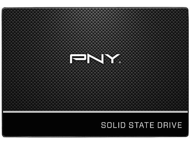

If you are looking for a name brand SSD, here is a 2TB PNY from NewEgg for only $138:
There are cheaper ones with good reviews, but with obscure brands that I never heard of.

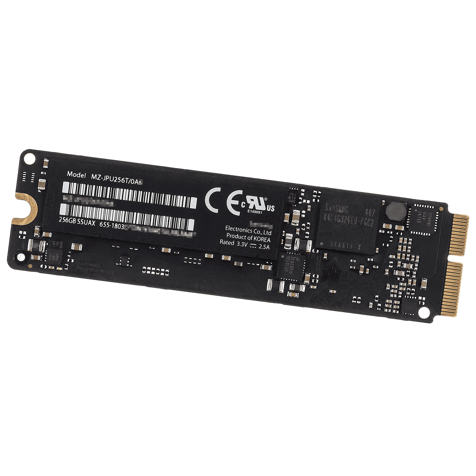

Blade SSD swap/adapter - More complex install due to removing the logic board. More expensive than replacing the HDD with a SATA SSD, but same speeds. Has TRIM Support. Not worth it on the Late 2013, imo.

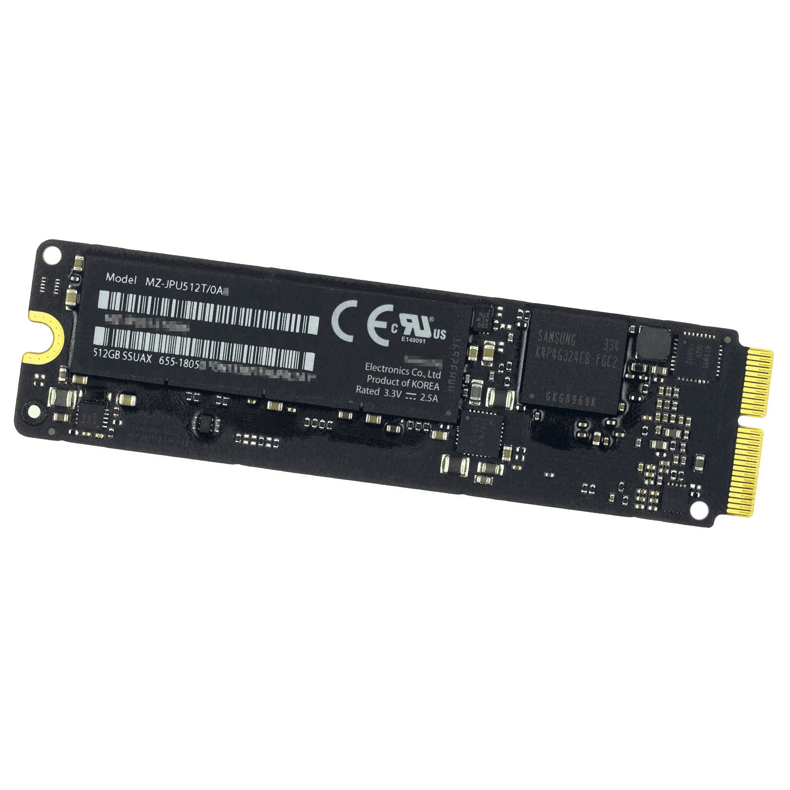

You have the following options for internal upgrade.
1. Replacing the 128GB SSD of your iMac with another blade from the same year model, but bigger capacity. It's pricey, but hassle free. If you choose modestly, it's still affordable.

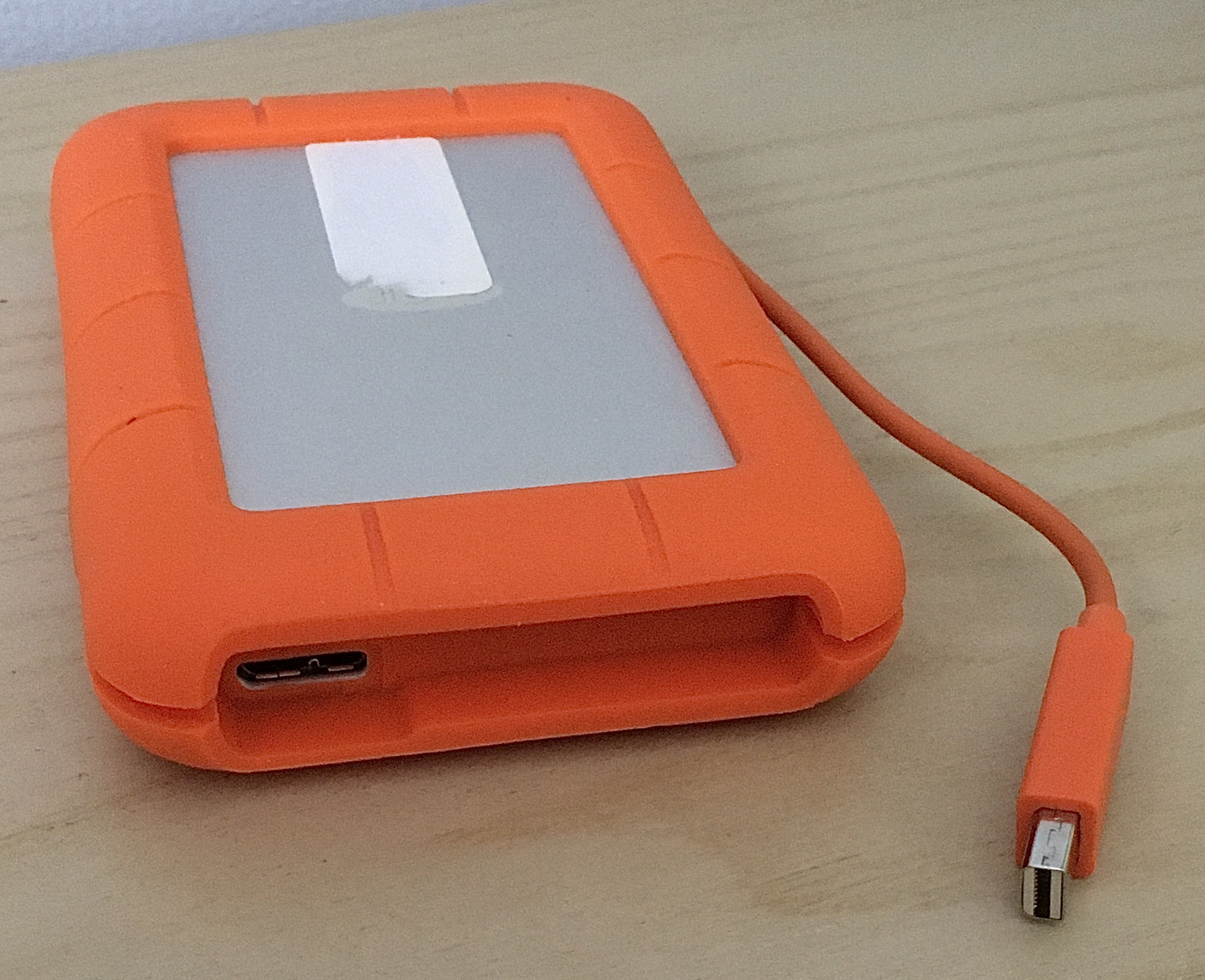

Another option that I used on a 2011 iMac was to purchase a used rugged Lacie hdd drive. The Orange one that has a captive Thunderbolt cable as well as a usb socket. Take the hdd out and replace with a Sata ssd. This supports trim. On my old 2011 iMac I attached it to the back of the stand. So it couldn’t be seen.
Reactions: pshufd
Ooh I like that idea, I've purchased a 1tb crucial SSD, which I could use internally or externally, but will take a look at this option! thanks for taking the time to post!
