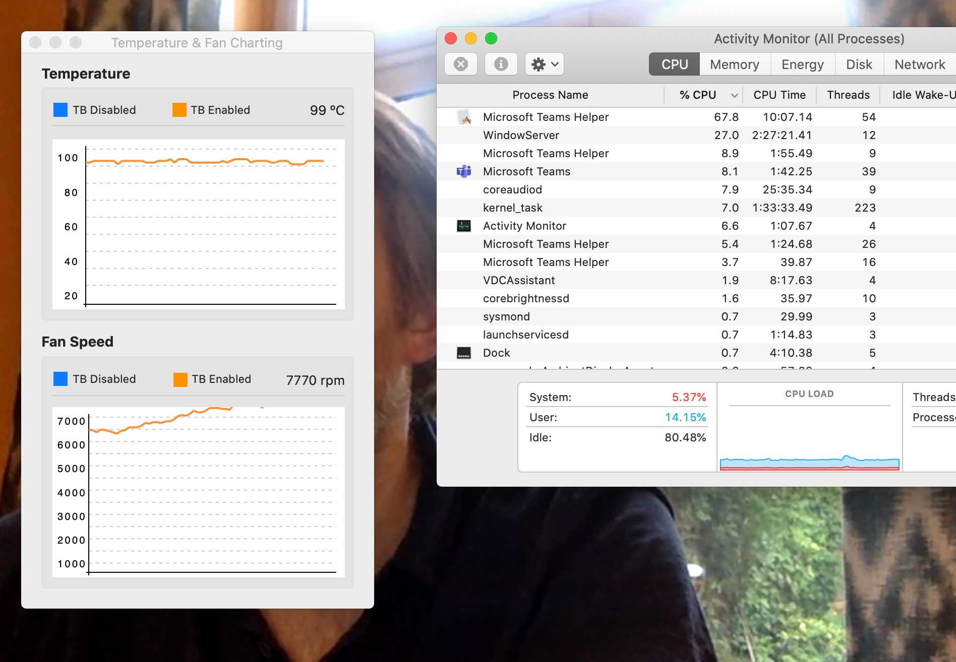

What's the Activity Monitor CPU and Energy tabs look like when you're in these meetings with the heat and the fan?
@deeddawg I attached a typical Activity Monitor screenshot from the 2020 MBA in a one-to-one Teams meeting. The other side of the meeting was a 2013 MacBook Pro which never went above 88 degrees/3500rpm. Small Zoom meetings are definitely better than Teams, but more than a handful of participants / gallery view leads to similar problems. The initial Spotlight and Photos indexing are complete.
Yowza, teams helper is definitely a resource hog.
I was curious to see if something else might be in there creating an additional load.
The 2013 MBP had a 28 watt TDP CPU as I remember. The Air is something like 9 or 10 watt TDP. So that's certainly going to be a difference.
If you have to stick with MS Teams, then sounds like the MBA isn't a fit for you - whether it's endemic to the system or something about the software or some mystery bug that maybe will get fixed - doesn't matter, if it's not doing what you need then send it back and go to the MBP.

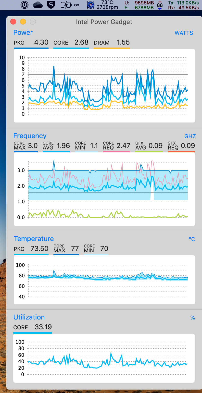

The mods have calmed my machine down, this is a teams call with backgrounds enabled which have been active for the last 45 mins, 70deg and 3k RPM so silent.
I will invest in the new MBP 13 shortly, I'm in no rush so I'll probably wait for the illusive 14" to surface unless I get itchy and buy the current model.

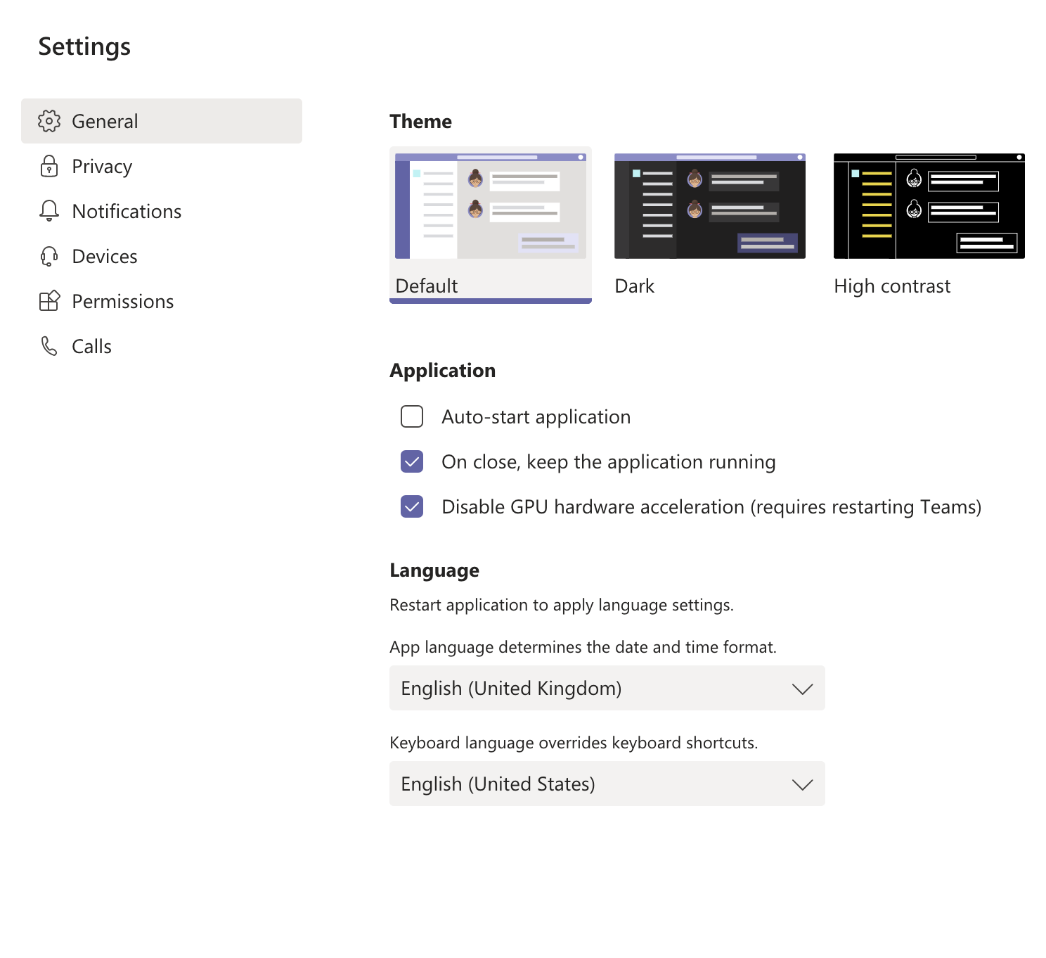

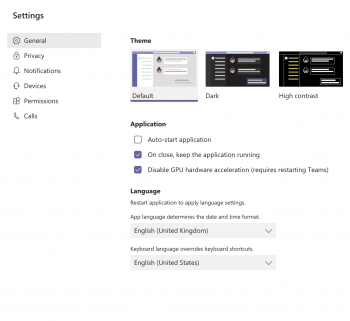

I've come to find that MS Teams by default uses the GPU which consumes more battery power and generate extra heat. I've turned this setting off on mine, I'll know more on how or if this makes a difference on Monday once I start to communicate with colleagues.
I've also found that when on mains power I have Time Machine that will run which when on Teams also makes the machine run a lot warmer and pushing the fans up a notch.
