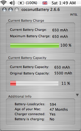

... Now i have a mac book pro, which doesn't work without a charger ( the battery icon shows a battery thats runs out 20 times more quickly than normal and the laptop shuts down when it comes down to something like 87%), Also no matter what charger i use now, it flashes constantly going back and forth from red to green.
Using a charger with the incorrect power properties will destroy your batteries capacity (I had a similar problem with a 2.33 ghz MBP)
Buy a new battery, a proper charger, and that will most likely fix your problems.
Also, 500+ load cycles on those old batteries is a lot!😀
@ deeya ...
hmm your probably right! i have been through 3 proper chargers (made for my computer) in this period! i cant beleive im gonna have to buy a battery AND acharger this sucks!
but this is showing load cycles for the charger or the computer (as in the battery inside the computer) ?
The load cycles coconut is showing are for the battery inside the computer.
The 11% number is showing the current capacity your battery has as a percentage of what a new battery would have, basically your battery is only holding 11% of the total possible charge.
