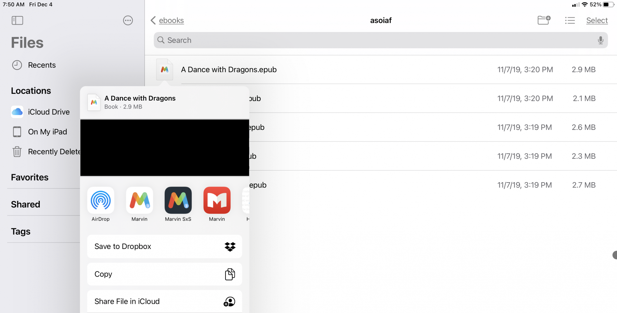

One more Q:
@sparksd - Its possible to use the USB3 to transfer on & off large ePubs & PDFs etc? Into Non-Apple APPS as well.
Marvin is what I was used for ePubs.
Considering which one to finally used for PDFs now; quite a many.
I hope its not just Pics & Videos
One more Q:
Yes, you can transfer any file type. But: I haven't used Marvin so I downloaded it to test. I couldn't see any way of getting a file from the Files app into Marvin - it doesn't show up in any Locations nor is it an option when I select an epub I loaded off an SDD and try to share it with another app. I could get it into Marvin from Dropbox, iCloud, etc. but not directly from Files. So I copied it to iCloud Drive and then in Marvin I loaded it from iCloud; there was no direct path to Marvin within Files. Maybe someone familiar with Marvin can chime in on this.
For PDF files, PDF Expert is a great option.
Edit: I found that within Marvin I could open any location in Files so I could directly get the copy from a Files folder. Marvin sould not see/access the external storage so I did have to initially copy the epub from the storage into Files.
Reactions: crashnburn

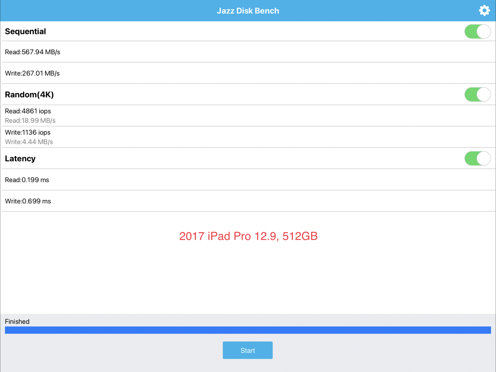

Makes sense. I recall the 2018 iPad Pros having NVMe level write speeds while the Samsung T5 maxes out at around 500 MB/s write then you've also got the exFAT overhead. Certainly would be interesting to see if the Samsung T7 will be faster.
I just ran Jazz Disk Bench app on my 2017 iPad Pro 12.9 512GB (88% full) and got the following with TestSize(Seq): 1G and TestCount(Random): 16384.
It's possible to add Marvin to the Share Sheet for EPUB in the Files app. Haven't tested if it also works for files on external storage but since it just copies files into Marvin, I'm guessing it should work.
I find it's a lot easier to use Dropbox with Marvin, though. The last time Marvin was updated was circa-iOS 10 so it simply doesn't have native support for features added in later iOS versions.
I'm seeing it as a Share option for epub in the Files app now.
