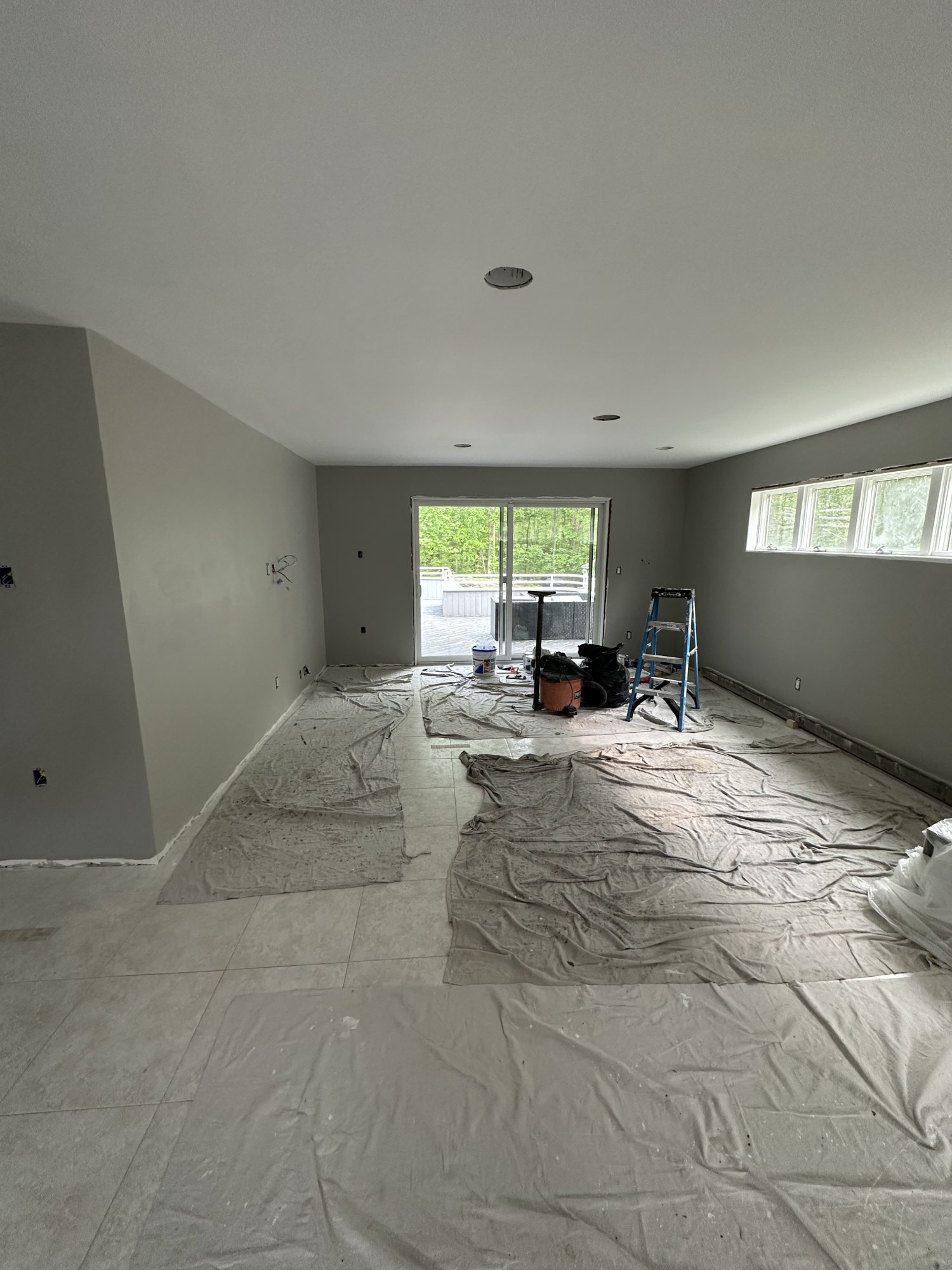

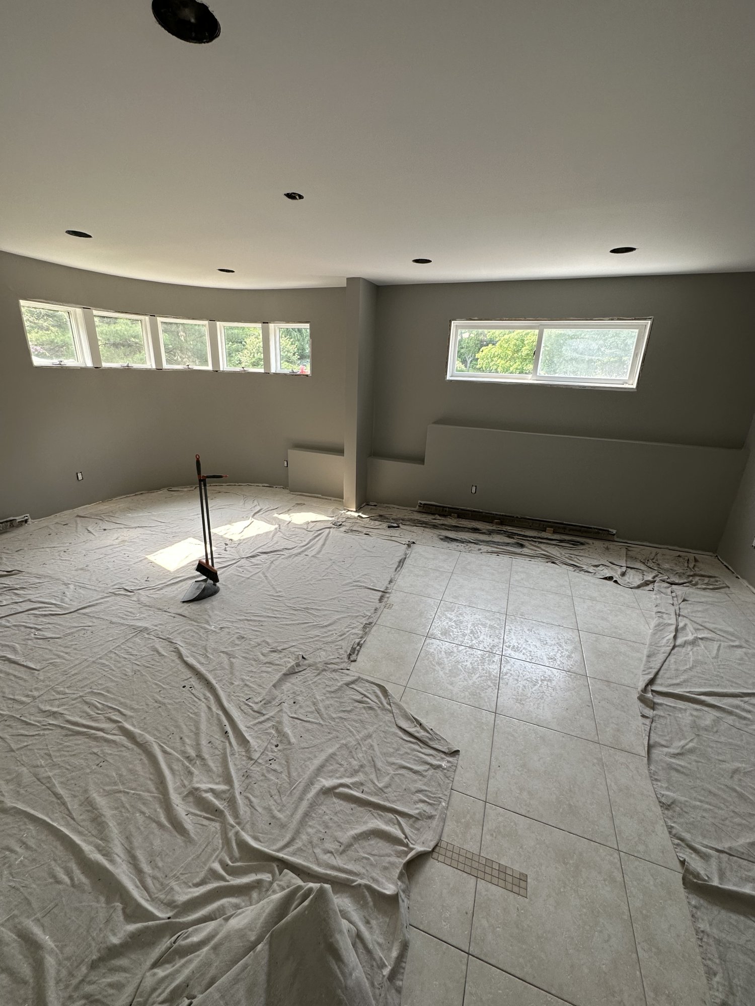

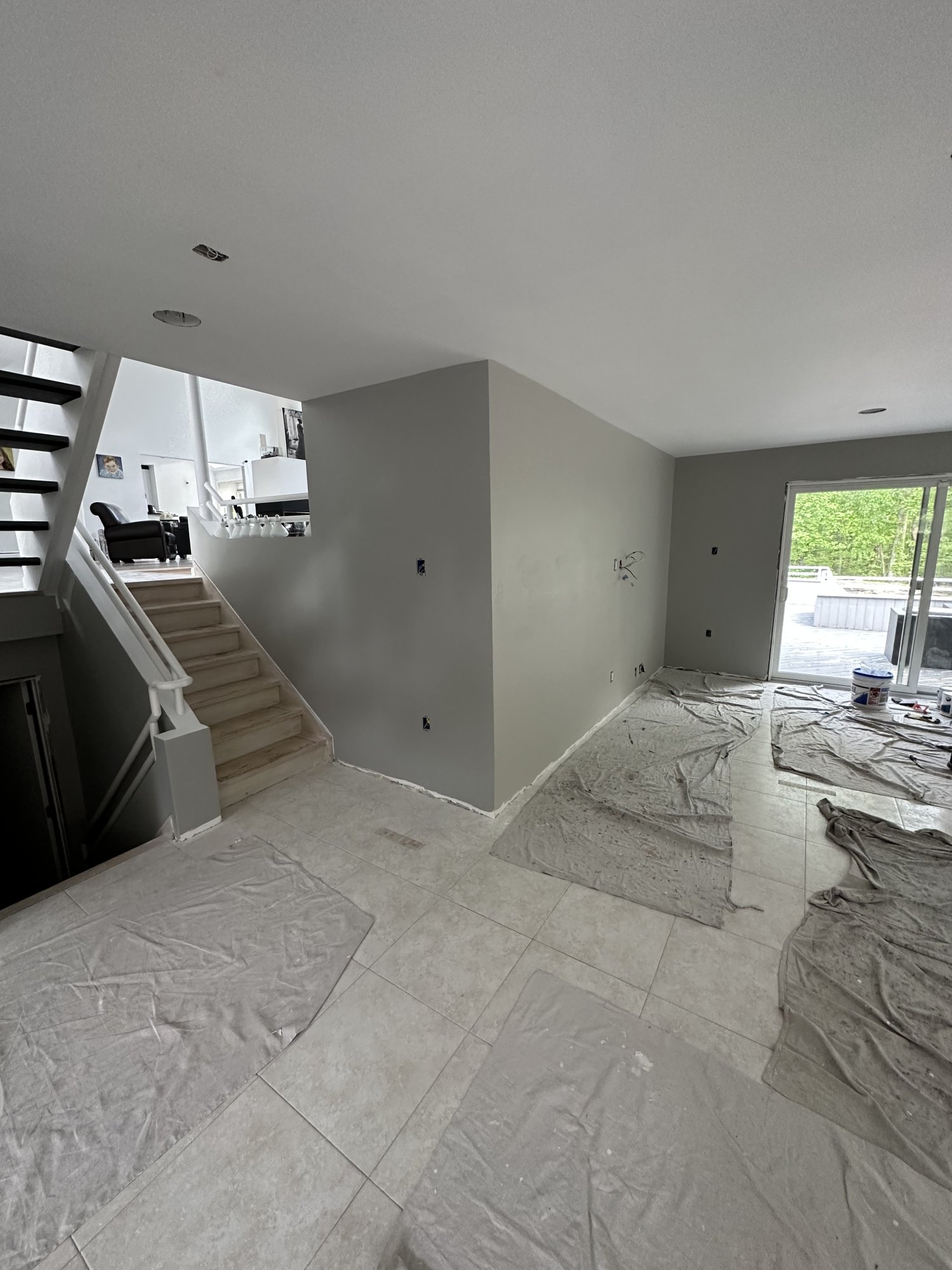

Hmm? You didn't mention the type and size of room the new system is going in? That can make a difference.
It’s not a symmetrical room but I’m splitting it up into two sections with no wall separating the two. A theater section and a game room section. The theater section is approx 177” x 157” (14.75’ x 13’) rectangular so roughly 192 sq/ft.
The game room section on the other side is larger but has a rounded corner.

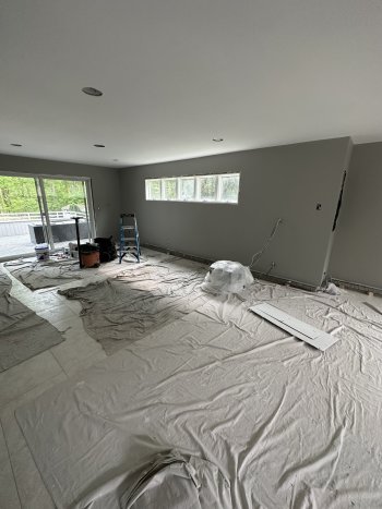

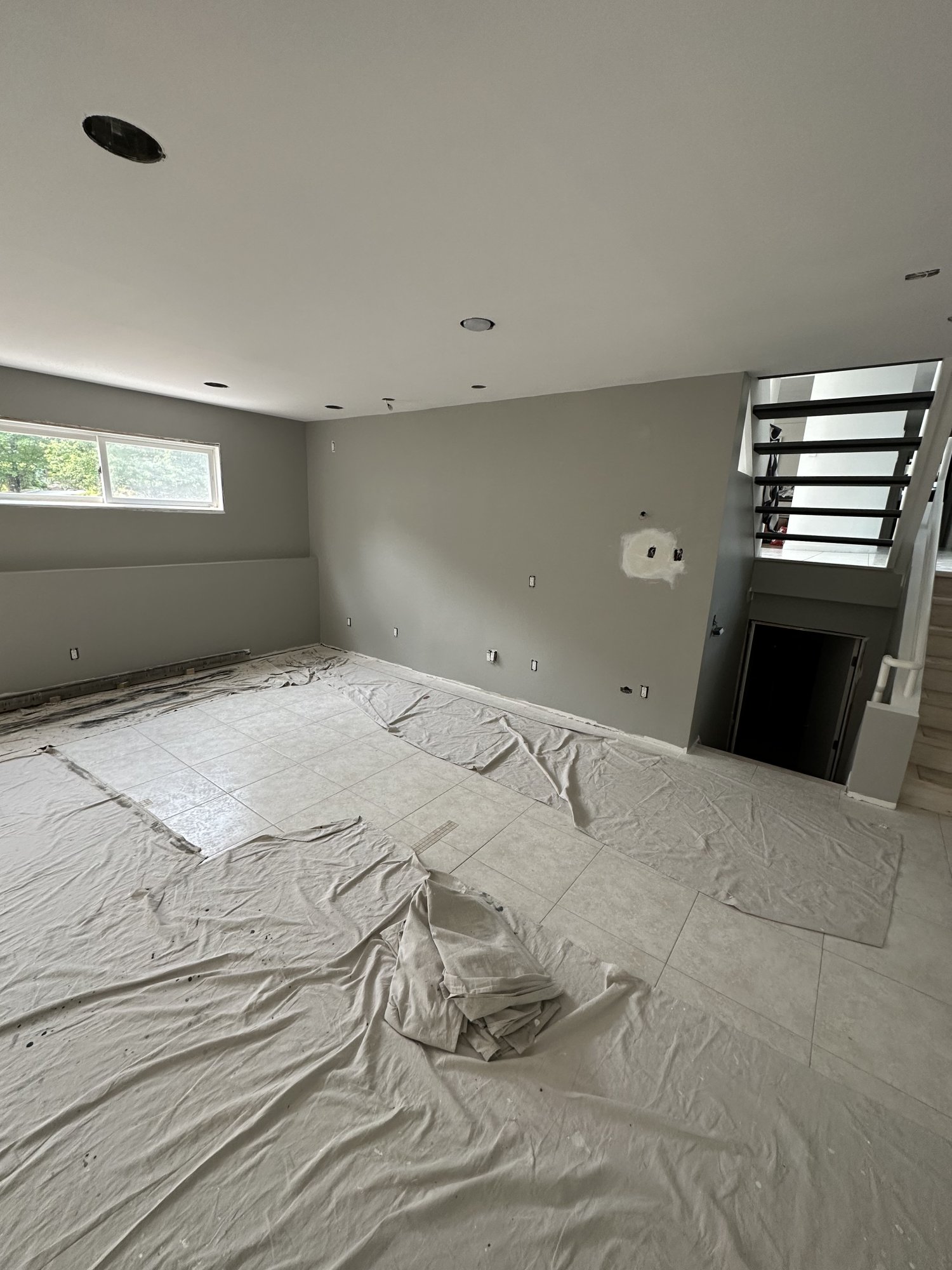

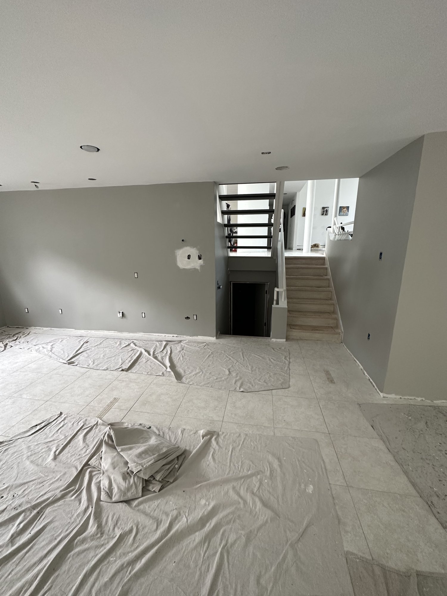

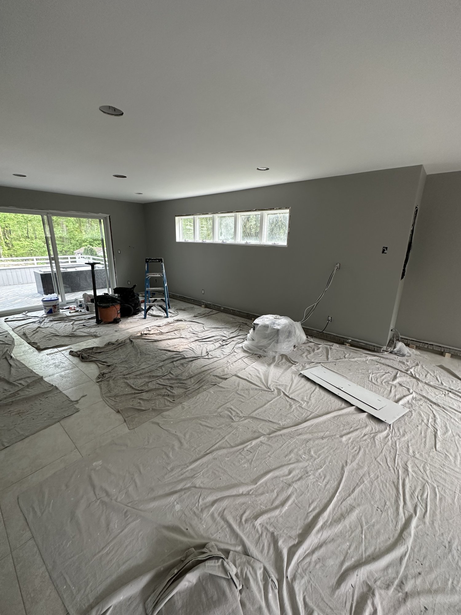

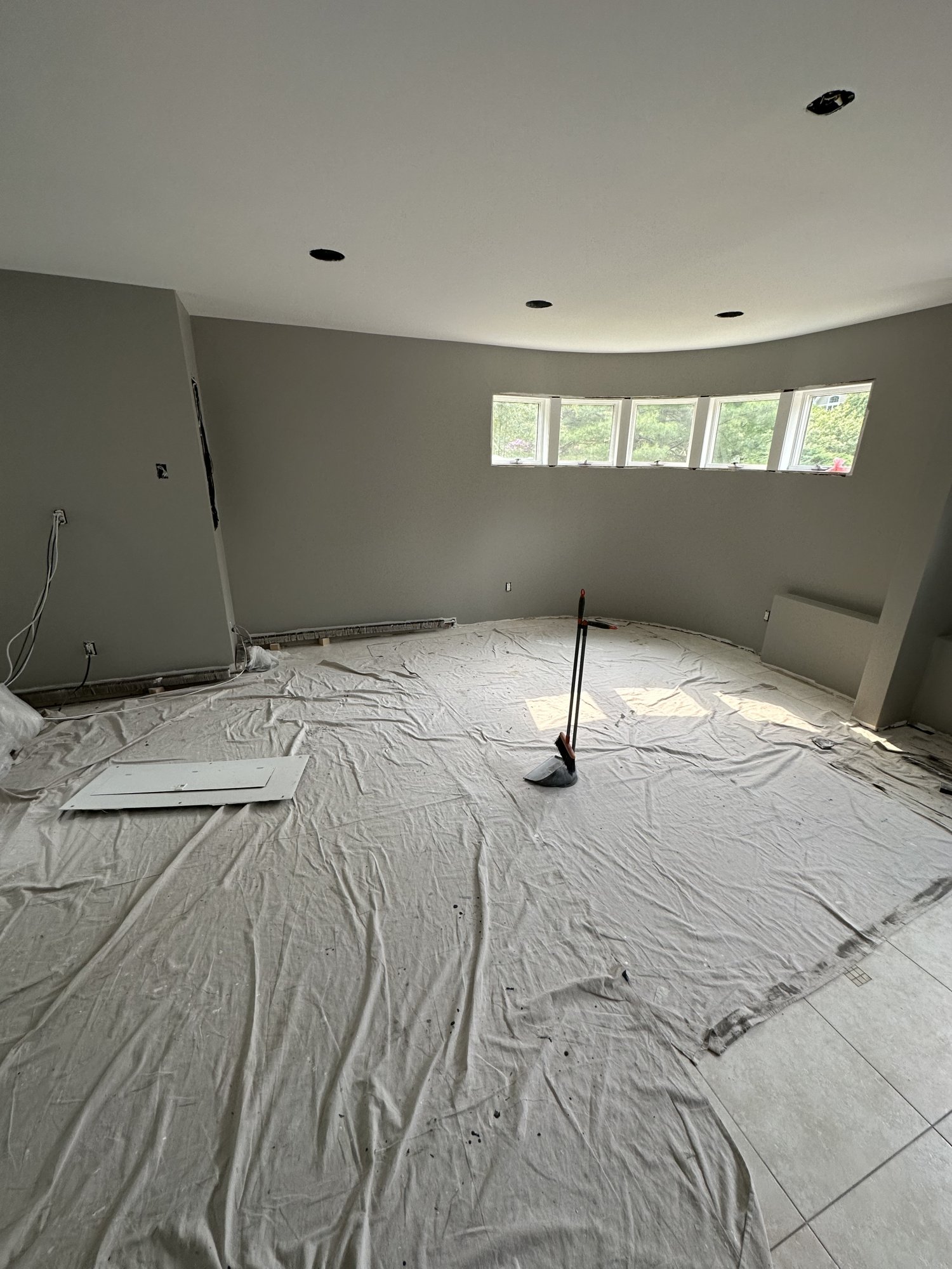

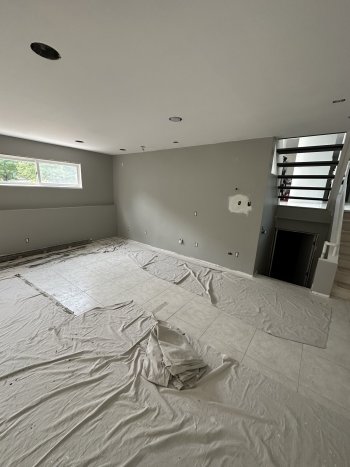

Here are some photos. The theater is on the side of the sliding door however, my wife and I are still debating if we should put it on the larger side to the right. This floor of the house is partly underground.
I was more curious though if the two stereo HomePods defaulted to the AppleTV and the Sonos system would be compatible together and not so much sound quality wise. I do understand that’s an important aspect though. Main curiosity is if the systems would allow the combination. Also keeping in mind, I’m not looking for earth shattering movie theater quality audio. Just something to watch some movies, NHL games and play Xbox with my son that’s better than just a stereo pair of HomePods.
PS- Pay no attention to the ugly flooring. It’s getting replaced lol.

The Sonos Ultimate will work much better in that space. If it was a 15x15 bedroom or something like that I would push two stereo pair of second generation homePods. That's gonna be NICE when done.
