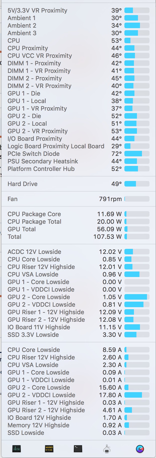

Well, right now it looks like this, in idle mode:
Anything that sticks out to you?

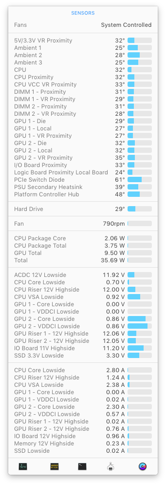

A lot does, especially your CPU temperature. Here are the temperatures for mine. Perhaps the ambient temperature is the cause of your higher temperature (seems unlikely).
Hmmm indeed, all your values are lower, it appears that something is causing the overall temperature to be much higher.
What model do you have?
Mine's an 8 core with dual D700.
Thank you so much for your assistance.
Six core, 16GB RAM, D300, 256GB
Mhhm well sure maybe my machine just produces more heat since it has more cores (8), more Ram (64), more intense GPUs (wich are working their asses off with my dual Dell 5k Displays) and the bigger 512 SSD. But maybe something else is wrong... Strange strange strange!
That's a reasonable conclusion. Though I would think the idle temperatures would be more comparable. Perhaps someone with a higher end configuration can provide their measurements.
Though it wouldn't explain why you're receiving high temperature warnings. I would hope that Apple has engineered the system to remain within acceptable limits even in a maximum configuration.
