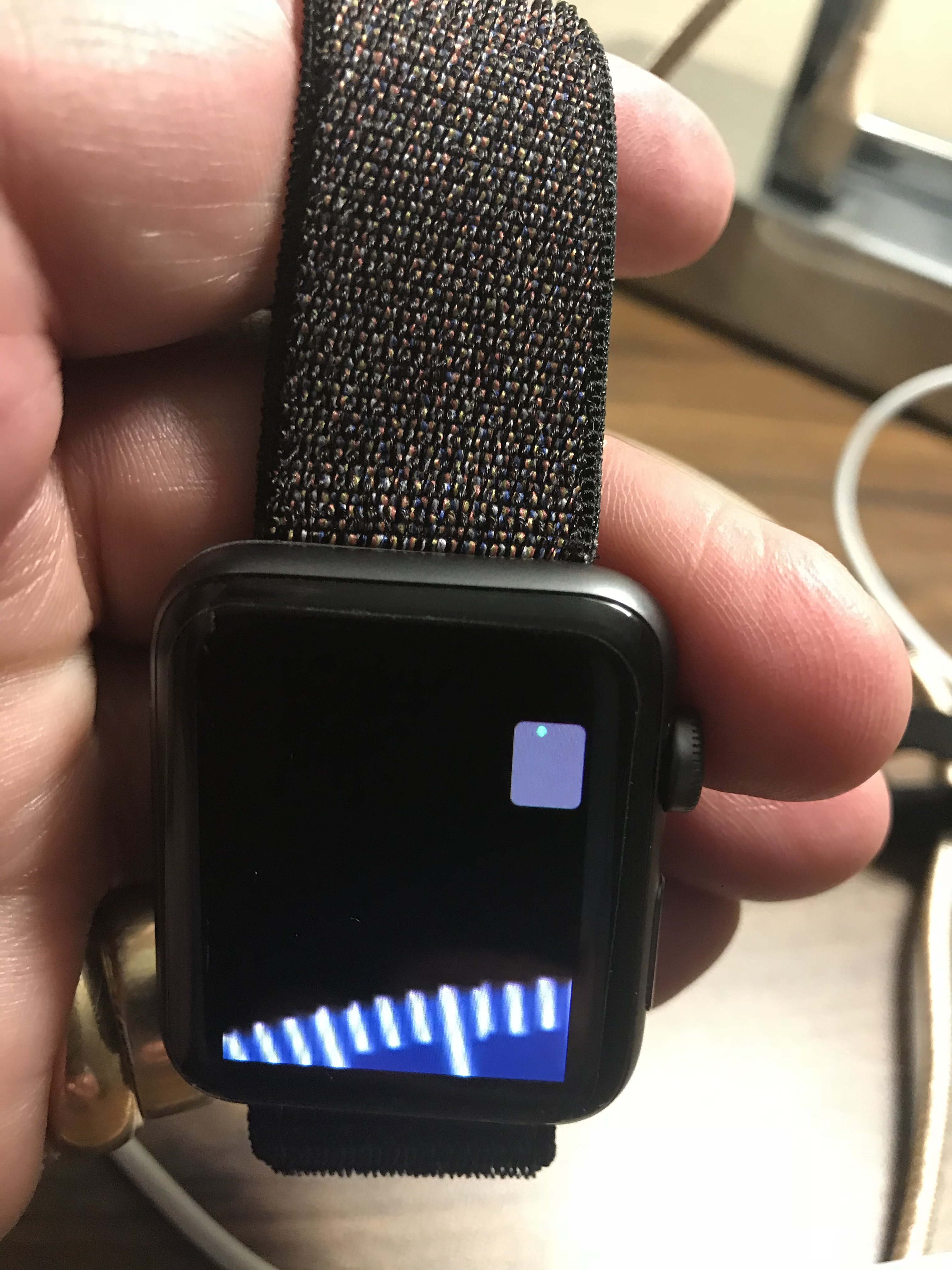

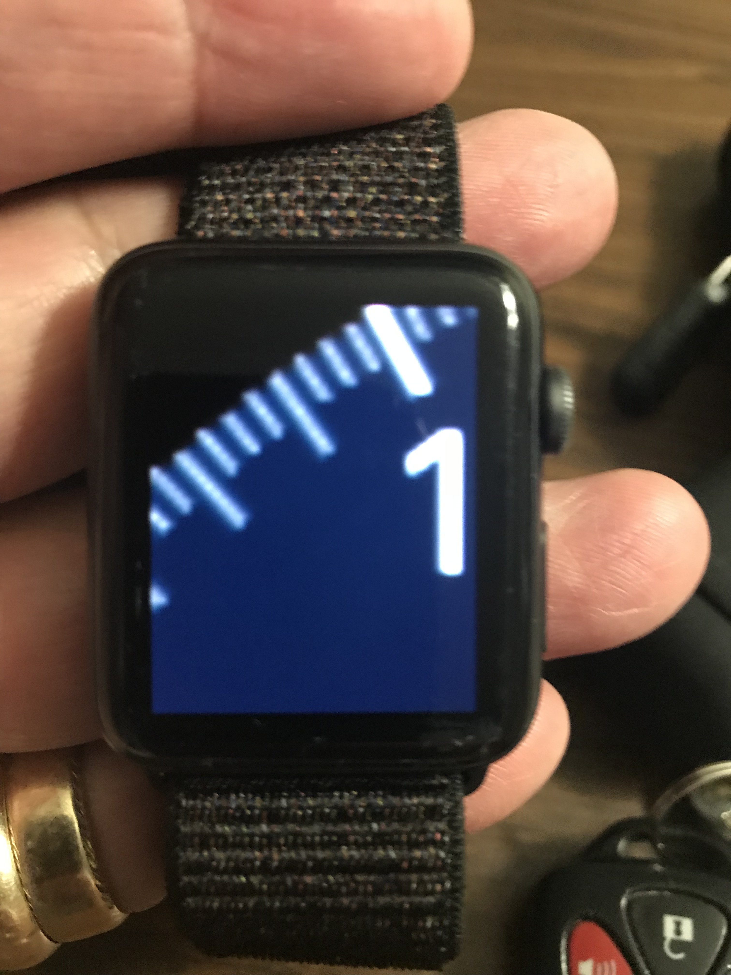

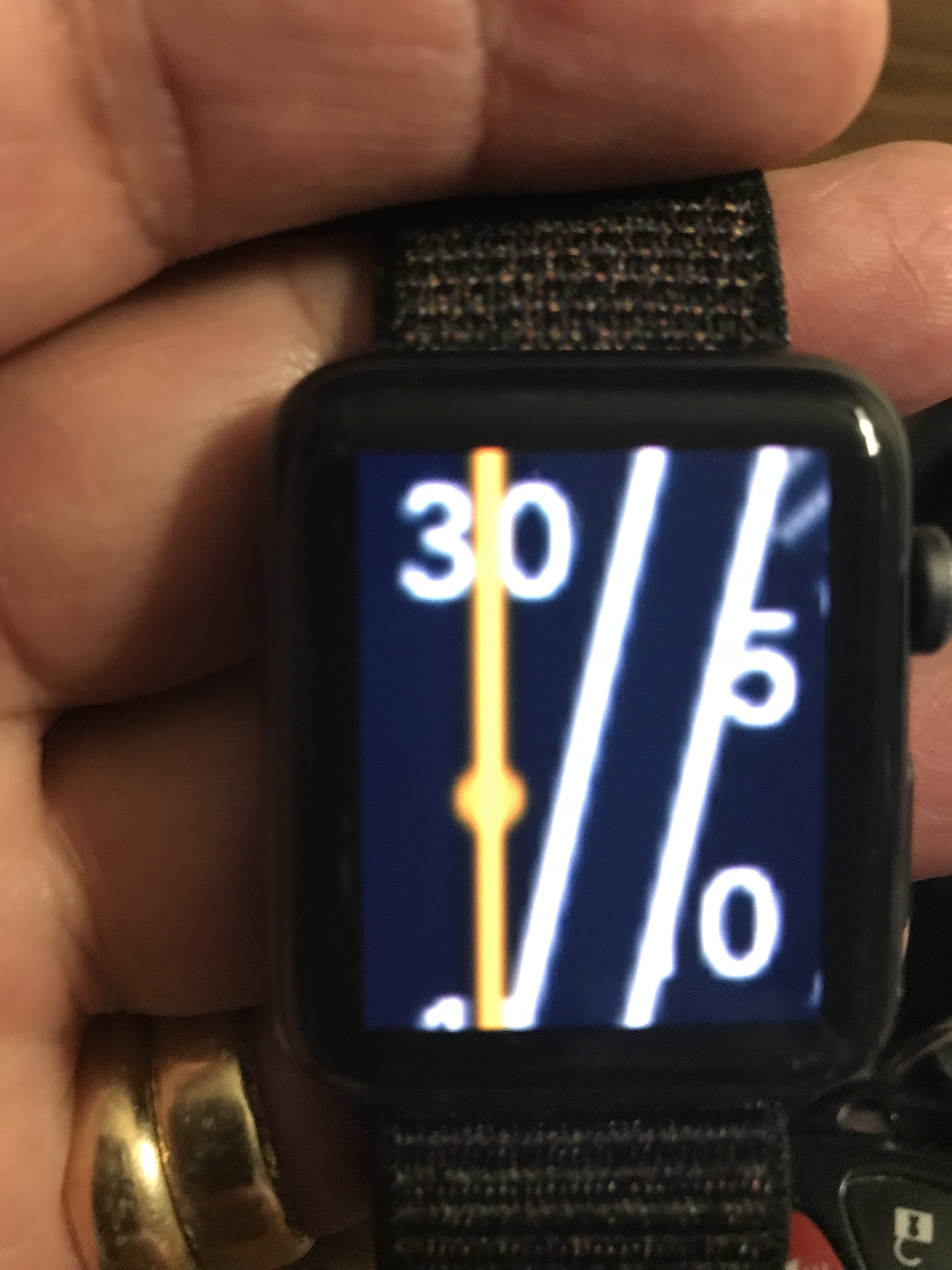

I am using Apple watch 3. Last week it started super enlarging the screen. It happens out of nowhere. I was able to reset it and was okay for a few days then did it again. This time I could not get into watch settings to reset. I had to drain battery and recharge to clear the issue. happened for times total. No new apps in last 3 weeks . Photos attached of the Chronograph face

Thank you zeusdawg. Problem I'm having is when the screen zooms itself out I can't reduce it back to normal size so I can't get to settings etc.. I tried double tap, pinching and turning the crown. I drained battery yesterday and recharged overnight. Everything seems to be fine now. I will double check watch settings on watch and phone. I may have missed something I thought I did right
Wow that's a bit rough... make sure the "Zoom" setting is off in the Apple Watch app on the iPhone under General > Accessibility and it should stop. That's also a good place to see how you may be triggering it. If I'm not mistaken you double tap with two fingers...
That was it. I had "Zoom" turned on so I must have done something on the screen to cause it to get so enlarged. I've turned Zoom off. I'll see what happens.
