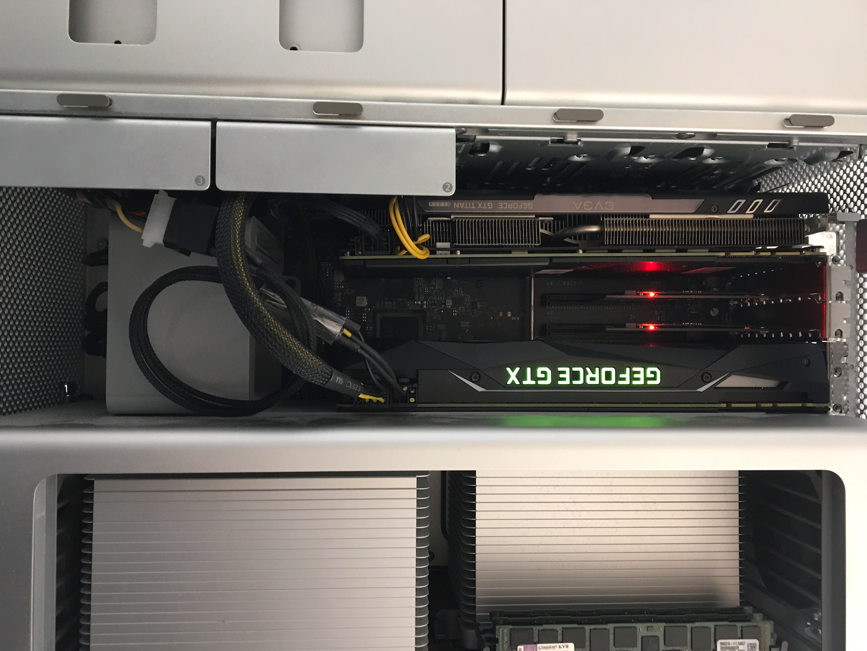

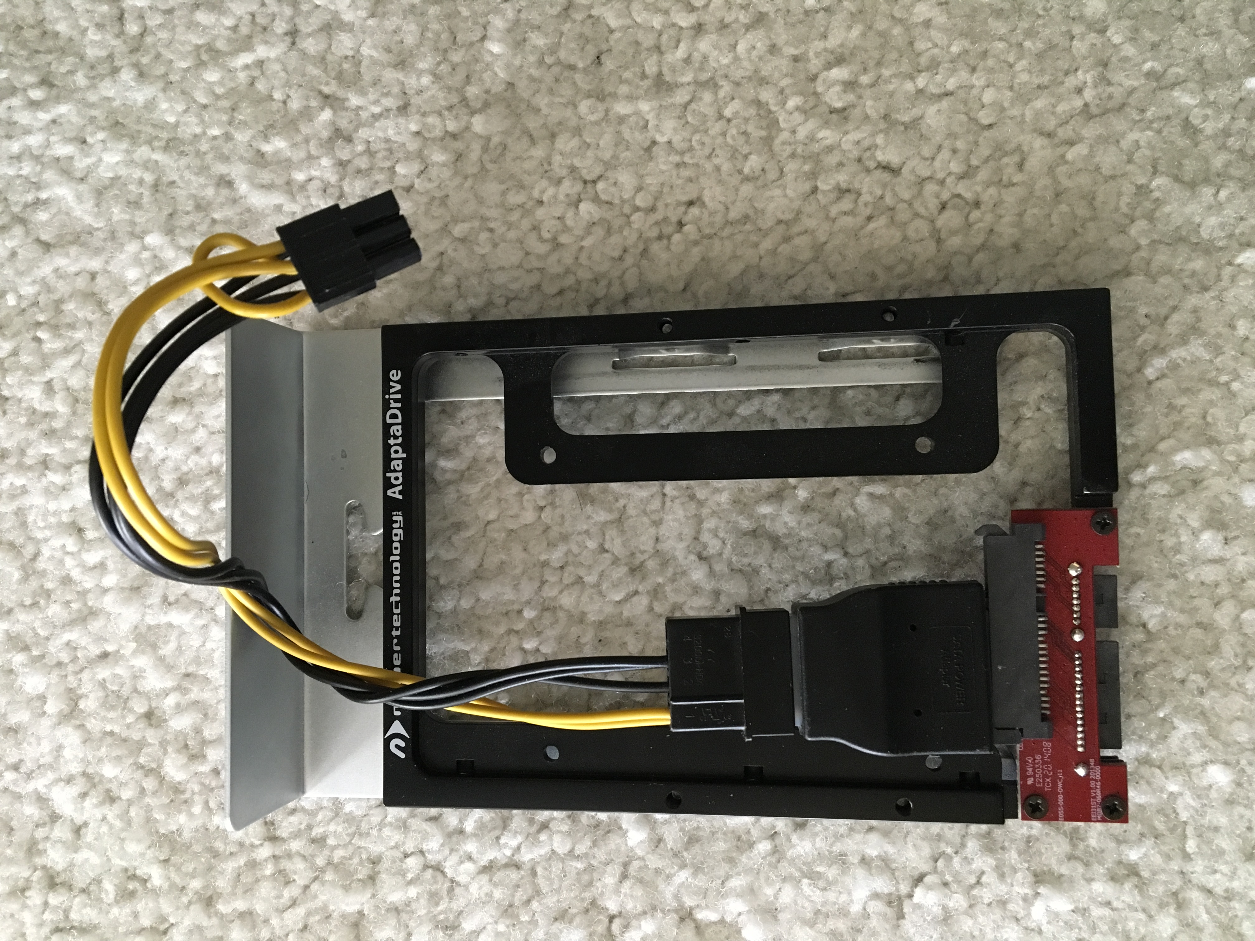

1. Titan X Pascal
2. SM951
3. SM951 Raid0 with 2.
4. Titan X Maxwell
Sata1 and Sata2 are used for 6pin power for both Titan X. Photo shows the cable and the rig. No external power needed.
As I don't have room for another Sata bay, I am looking for a solution to bootcamp windows 10 and MacOS between the two PCIe SM951s. There is another guy says PCIe ssd works in bootcamp, but I do not realize how he did. If some of you know more detail, please share.

There is no penalty by doing this. The two SM951s Raid0 at speed of ~1400GB both write and read. In the octane and LuxMark test, putting slot1 or slot4 gets identical result.
He wasn't referring to the SM951, but rather the GPU not having a x16 lane, that it normally uses. A single SM951 closely saturates a x4 lane slot, which is why using RAID0 in a x4 slot yields almost the same read/write speed.
Yeah I know, in my post I mean the Titan X in slot4 has no penalty either. Slot1 or Slot4 yields similar Octane or LuxMark GPU score. At least I do not notice difference whether being X16 or X4 in the synergy of CUDA/OpenCL compute power. The way I use slot 2, 3 for raid (size 512GB) is simply because cheaper. At same ssd size, $99x2 + 2 adopters are cheaper than $380 + one adopter.
It looks like a 2.5" 7mm SSD / HDD can fit in HDD bay 3 / 4. The SSD is so light that can just plug into the SATA port and leave it hang at there. Or a tape is good enough to hold it up.
If not, are both optical bay occupied? A simple solution would be plug in a SATA SSD into the empty optical bay (again, just leave it there with no mounting / support is necessary), and installs Windows in the traditional (easy) way.
Or why not get the power from bay 3/4, and leave bay 1/2 for HDD / SSD? It really looks like enough room for that.

There is no room for STATA bay 3, 4 because I used adopters. If straight plug in without adopter, maybe, but it's hard to make it firm without something and it may stop the movement of the GPU fan on card. I am kind of like to make the PCIe SSD bootcamp works if I could. I want to keep everything tight and neat.
