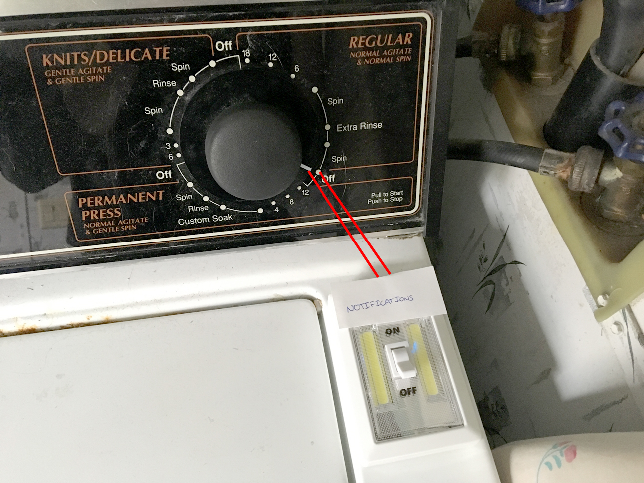

A friend of mine made a "remote sensor" for his dryer. The dryer has a little light that goes on when it's finished, but a very weak audio alarm. So he used a phototransistor with a little collimating tube to "watch" the light [1]. The transistor output is hooked up to the pushbutton half of a wireless remote doorbell. So when the light goes on, it turns on the transistor, which "presses the doorbell", and he then carries the "ringer" half of the doorbell around, or parks it in the workshop, or whatever. It's been working great for years, and is pretty economical on batteries.
[1] He did look into soldering the LED side of an opto-isolator in series with the dryer's LED, but the electronics were buried far too deeply inside the steel housing of the dryer for that to work. It also would have voided the machine warranty, which can be unwise.
That's a very elegant solution your friend came up with. Unfortunately, I lack the circuitry skills required to work something like that out, so I'm relying on my tenuous grasp of terminal and Python to get me through it. My current plan is pretty rudimentary; I only have a radial dial on my washer, so I'll tape on a couple wires that'll make contact when the dial is in the off position. I also have a cheapo light-switch-shaped flashlight, which I'll repurpose as a case for the Pi. I can use the switch on the flashlight as an enable/disable switch for notifications, so that when the Pi reads the state of its pins and detects continuity across the switch and the wires on the dial, it'll send an email to my phone's number (@ whatever domain forwards emails to text).
The dial can spin indefinitely, so I'll probably strip one of the wires and use it as a brush after adding a conductive ring so that the wires won't get twisted over time. I'm opting for text notifications because… I mean, to be honest, there's just something so asinine about getting a text from your washer that I can't resist.

I strongly recommend an optical sensor over an electrical one.
The primary electro-optical element is called a photo-interrupter. It's basically an LED and a phototransistor together in a molded case. There's a gap between the two, so if you put something like a piece of cardboard between them, the optical signal is interrupted, and the transistor turns off. Remove the cardboard and it goes on again.
The total circuitry is simple enough I could advise you on it. Start a thread, maybe in Mac Programming, because that's where some other electronic stuff sometimes shows up. If you have a soldering iron and a modicum of skill using it, it won't be difficult. If you don't, you can practice soldering on some inconsequential things first. It's a lot like using an Xacto knife: practice makes perfect, but plan to make some mistakes early on.
I'll even find a part for you at Digi-Key. Since your washer dial has 3 separate OFF positions, I recommend buying at least 3 detectors, so you can put one at each distinct OFF position. I suggest buying a couple extras, so if one dies from clumsy soldering or mistaken connections, you don't have to reorder.

Thanks for the advice. Why do you recommend photosensors over electric? Are they more reliable, safer, or both?

Both.
Exposed electrical contacts can feed undesirable voltages to things that touch them. The degree of undesired consequences depends on several things, including the voltage and the available current. Depending on what's actually providing the power, it could cause problems in the source of the power, i.e. the Pi's power supply, or more likely, the Pi that's being powered from the same supply (power loss, or damage to the supply and/or the Pi). The low voltage (5V or 3.3V) probably isn't anything to worry about in terms of electrocution hazard, but it could be a problem if it's short-circuited for a long period of time (overheating in supply) unless something is done to limit the current.
Exposed electrical contacts can degrade over time, especially in the presence of moisture, and sometimes more quickly than one might think. Degraded contacts can fail to register a closure, or can get stuck in the closed position. Also, wires can bend and get stuck.
If you really want to try electrical contacts, there are better arrangements that don't have a brush & wire on the moving part.
If you want to try something non-optical, there are magnetic sensors (reed switches are the simplest), which would need a small magnet mounted on the dial. Magnetic sensors may have proximity problems in this situation, because a magnet strong enough to activate a sensor is probably strong enough that it can't distinguish between OFF and the last 5 minutes or so of the dial position. Optical sensors can be precisely placed, and since the sensed element is a physical object (cardboard or plastic interrupter), it can be adjusted so it triggers only when the last mm or so is traversed.
