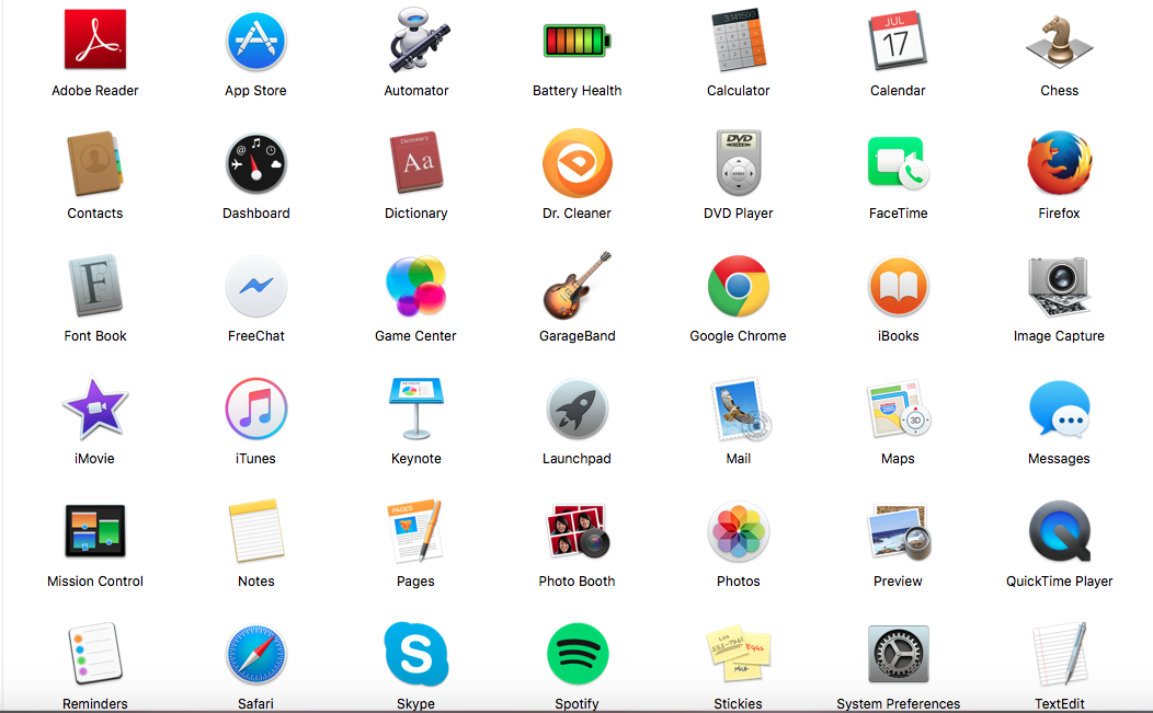

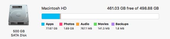

So, 77GB of apps, but these are the only apps I have installed on my Mac. Most of them are stock.. so how is it taking up so much space?
77GB doesn't seem like that much. Also included in that number is probably OS X itself. Mine is about 200GB.
Those numbers don't add up. In the top right it says 461 of 498 GB free. That measure shows you've only used 37GB.
Right, that's what I thought was strange. So do you think the only option is to do a restore? I have deleted a few apps but it didn't make a difference.
Sounds like some allocated space has not been properly de-allocated. Do you have any big files in your trashcan? Not sure how those would be considered/calculated by OSX, but you could empty it just to be sure. Next I would run the filesystem integrity and permission rights validation from Diskutil before doing a complete re-install.
NO! Do NOT restore! The problem is fixable with must a few minutes of work!
The amount of space used in total is less than the amount it says that applications takes up.You need to re-index the hard drive to fix this. This is a common issue and can be fixed easily!

I've done re-indexed about 3 times in the past year or so, and it is the actual process that Apple will tell you to do to fix the issue! 🙂
