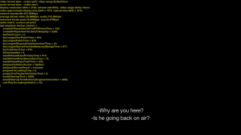

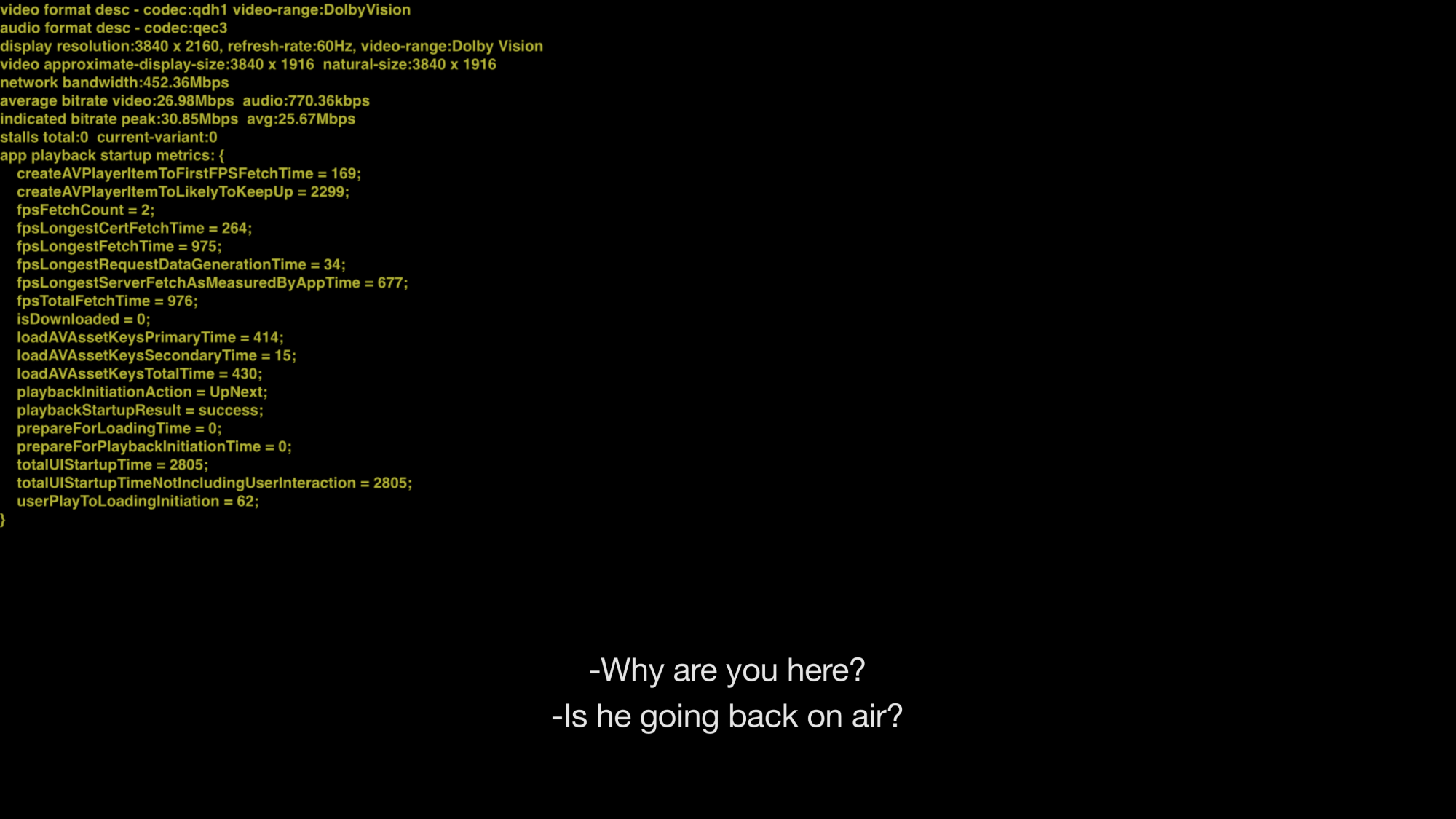

If you install the Xcode Developer Playback HUD on your Apple TV you can see things like the video and play back specifications and bitrate numbers (bandwidth available, average video/audio bitrates).
To enable HUD on the ATV, you need to connect a Mac to the ATV via Bluetooth, install Xcode on the Mac.
