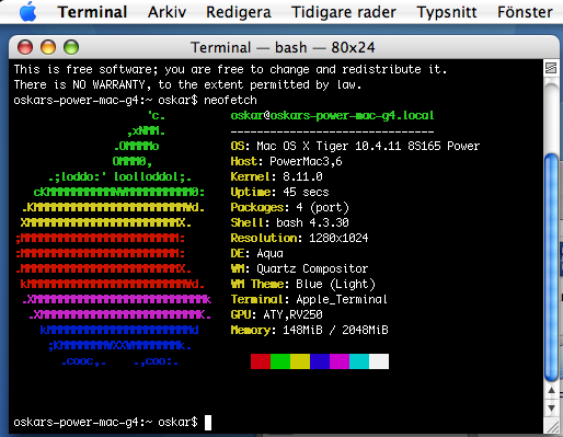

I encountered the same problem on my MDD G4 1.25Ghz and after a bit of frustration and googling I found a solution in a discussion here: https://macintoshgarden.org/apps/infoppc. Indeed it is the old bash version as suggested earlier that is the problem, and a newer (compiled!) version (4.3.30) can be downloaded here: http://tenfourfox.blogspot.com/2017/11/the-security-blanket-blues-revisited-or.html
That is handy... now we just need the latest gcc (gcc12) and the libs compiled 🙂
