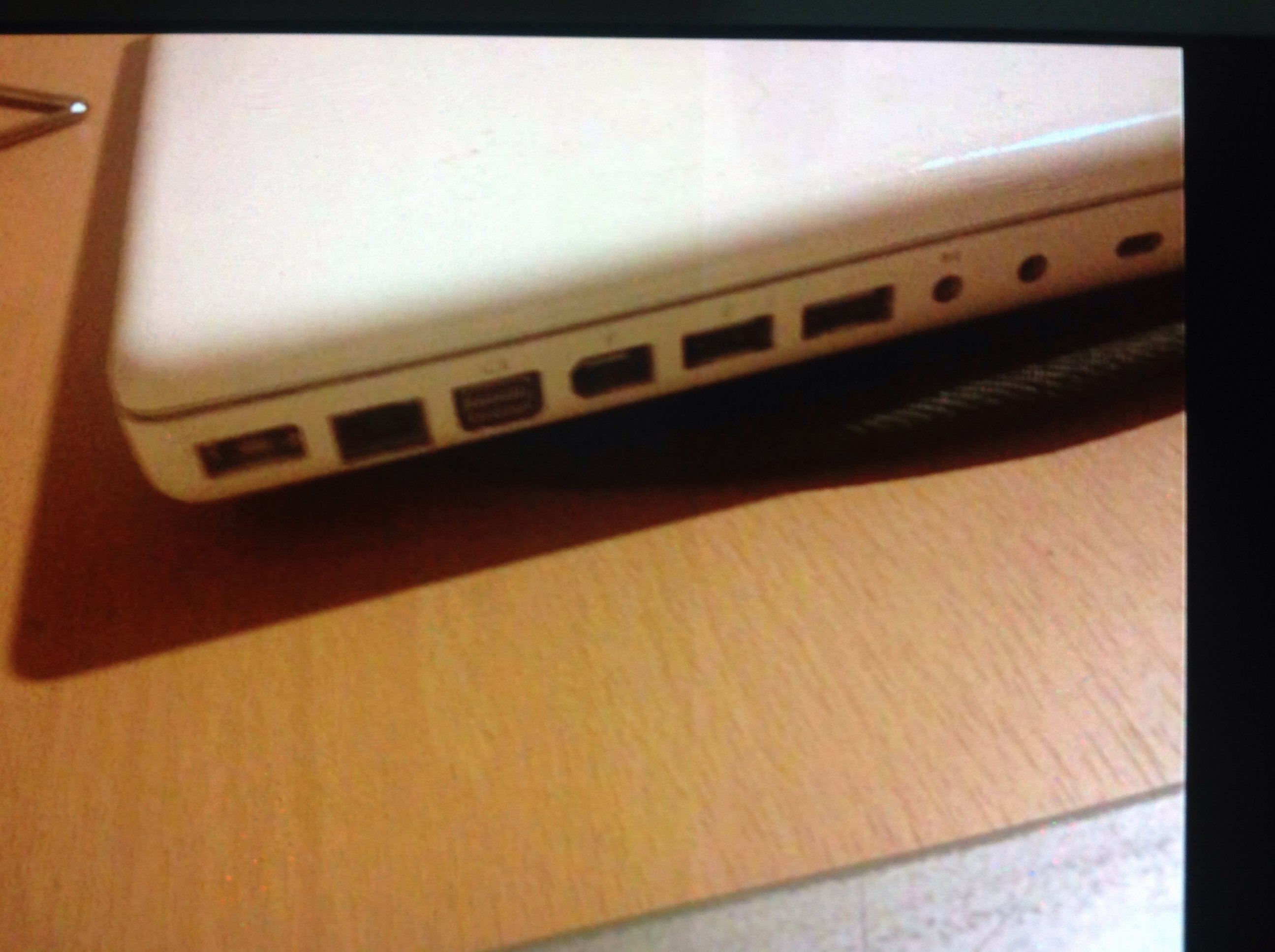

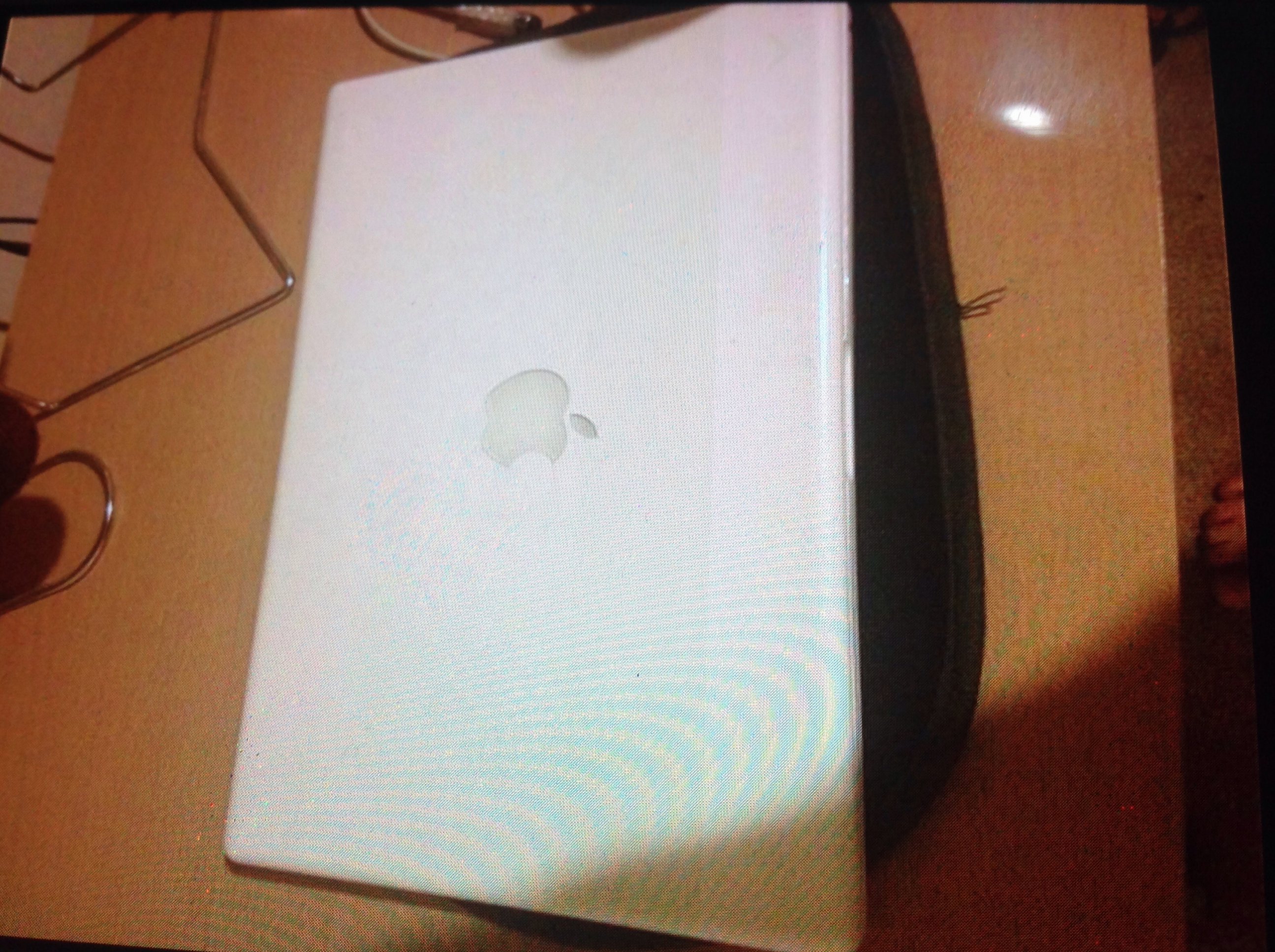

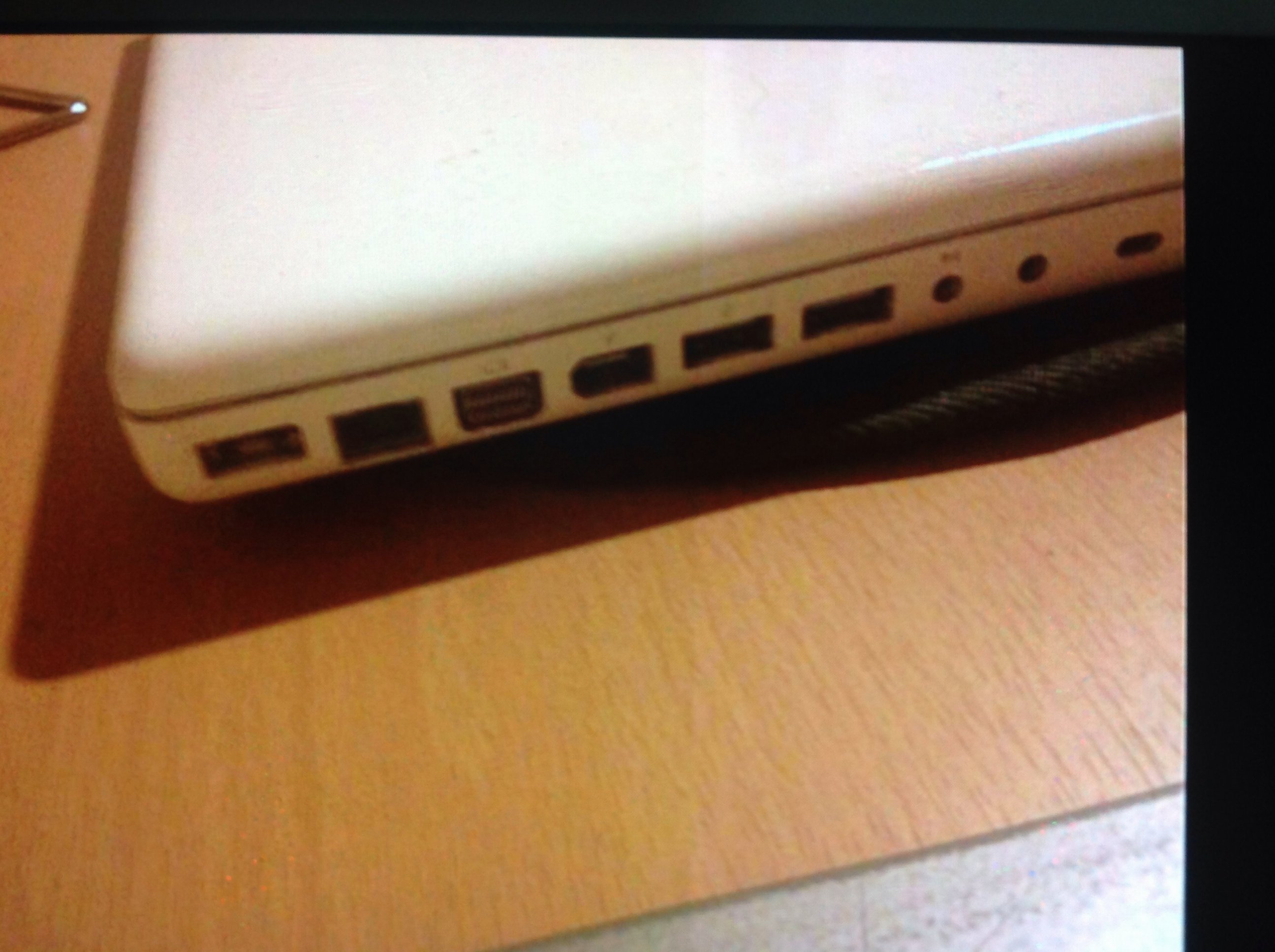

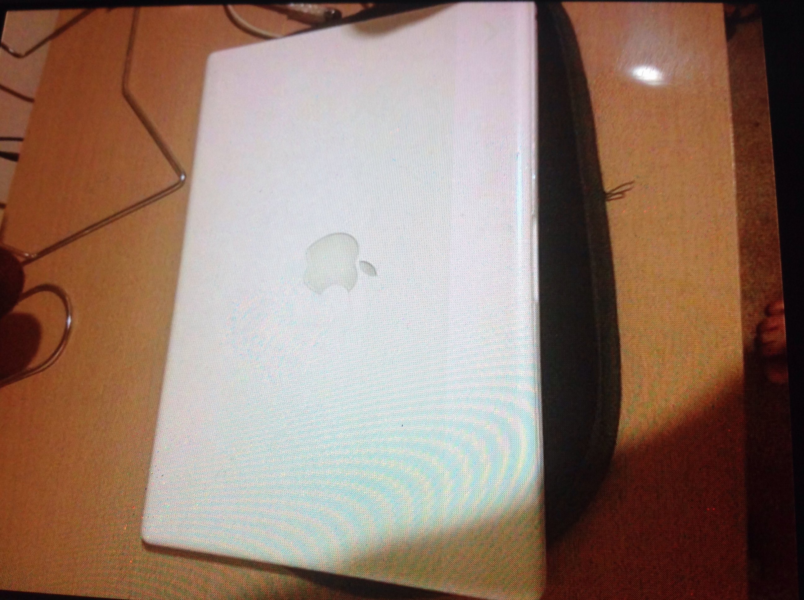

which right adapter suitable for this macbook?can you recommend the right adapter
For this macbook or picture it will be helpful
Titi wrote:
"which right adapter suitable for this macbook?can you recommend the right adapter
For this macbook or picture it will be helpful"
Looks like a 60w is what you need...
