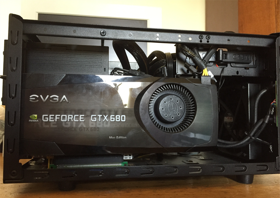

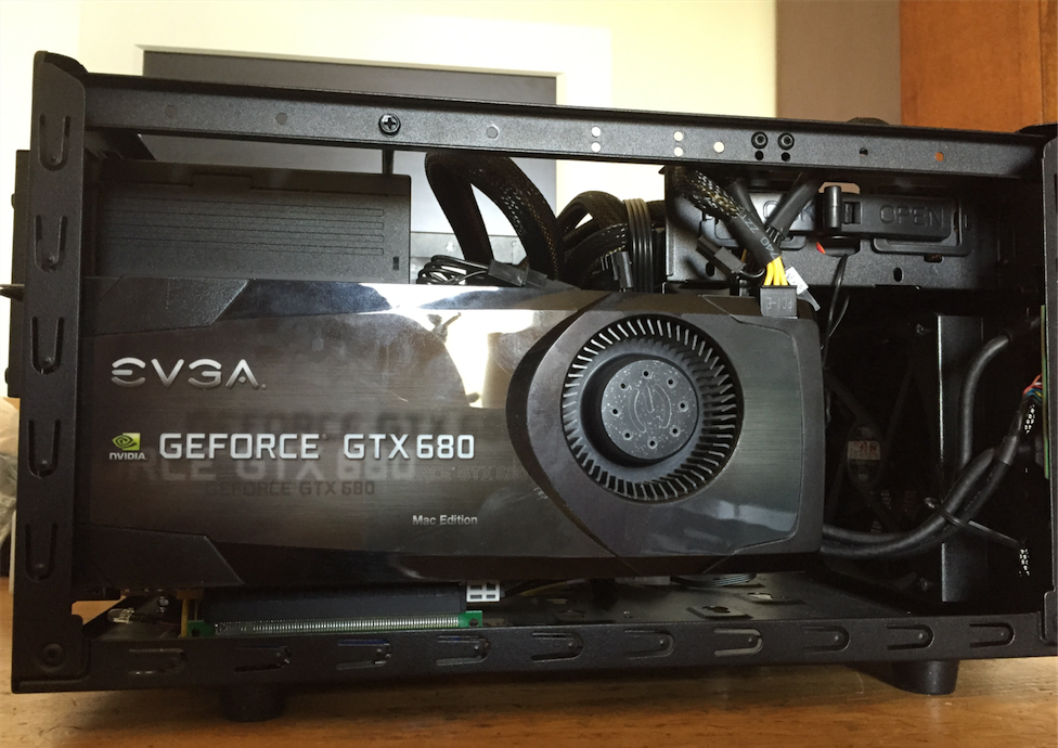

I had to activate DP 1.2 on my 4K monitor (Asus PP279Q), but yes, the card is capable of 4K/60 Hz.
My GTX 680 eGPU @ 4K/60 Hz: https://forums.macrumors.com/threads/mac-mini-4k-tv.1644192/page-3#post-23656730

No, it's not flashed, it's an original 'Mac Edition' GTX 680 2GB card. I can definitely confirm that the info about DP 1.1 on the EVGA site is wrong.
I made sure that I bought DP 1.2 cables. And I had to activate DP 1.2 on my Asus PB279Q monitor (default was DP 1.1).
