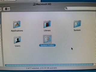

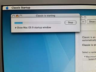

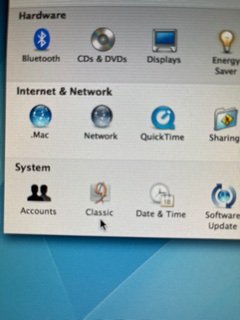

When I first went to my G5 with OSX 10.4.11, I could not find Classic mode. I went to System Preferences, then to the View menu and Classic was not there.
To get my G5 to work in Classic mode, all I had to do is copy, using an old USB drive, the OS9.21 System Folder, I had on another machine, into the HDD of of my G5. Then, either click on the System Folder or onto an OS9 app and the computer automatically opened in Classic mode. Now, I can run Classic apps and I see Classic under the System Preferences View menu. If you double-click on Classic, it allows you to select Classic mode to launch at startup
Reactions: dextructor
