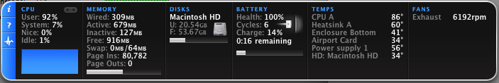

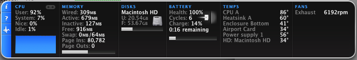

Hi! I can totally understand your concerns. I too find, that some times my Macbook Air is simply getting to hot. At max., it runs up to 86 C, while the heatsink stays somewhat cooler (see screenshot). I would encourage people to measure their system max temperatures and post them as a screenshot, because right now it is extremely difficult to tell, what is the normal temperature range among users.
Follow this guide:
http://www.intelmactemp.com/howto
Take a screenshot of iStat (cmd + shift + 4), post it on this site.
My theory about some MBA high temperature (and high difference between CPU and heatsink) is the bad application of thermal paste (as shown on several pictures on the net). Some users may have notebook with extremely bad heat transfer to the heatsink, while others have acceptable heat transfer.
Regards, Hansano

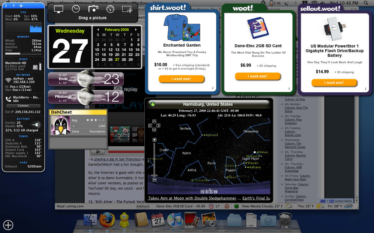

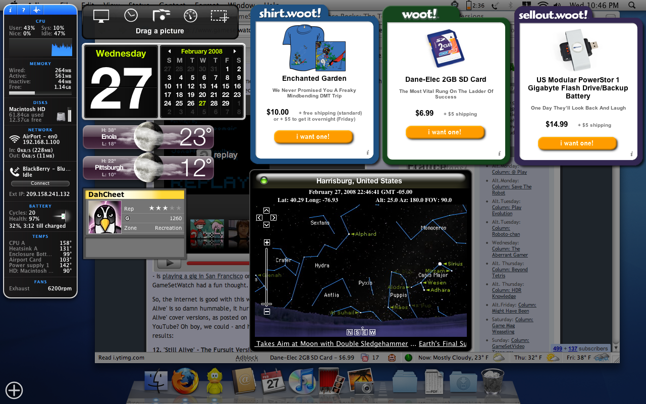

Damn my CPU seems to be running at 90c right now. No idea why, i'm not doing anything processor intensive and I just took it out of sleep. The wierd thing is the computer doesnt feel very warm on touch.
Edit: i think charging your MBA while using it may make it run hotter.
Complain to Apple.
It's probably the thermal paste, which has been applied too thick (again). There have already been photos of the CPU and thermal paste posted somewhere in this forum.
Your processor usage is quite high if you say it's at idle. LOL @ all those widgets though. Close some of those and you'll see a temperature reduction. Also, charging the battery will always cause a temperature increase.

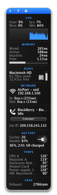

Here's my screen cap. I was just watching a bunch of YouTube videos though.
On a higher note, my original screen shot was taken at 10:46PM and at 10:52PM my temps and fan speed are lower. No videos or strenuous use, just surfing the forums and posting pictures.
Mine only got that hot when I was doing updates, had like 10 other apps open, including google earth! It was like that for 5 minutes and the fans were at 6500 but other than that always they stay at 2500 and the mba stays cool.
