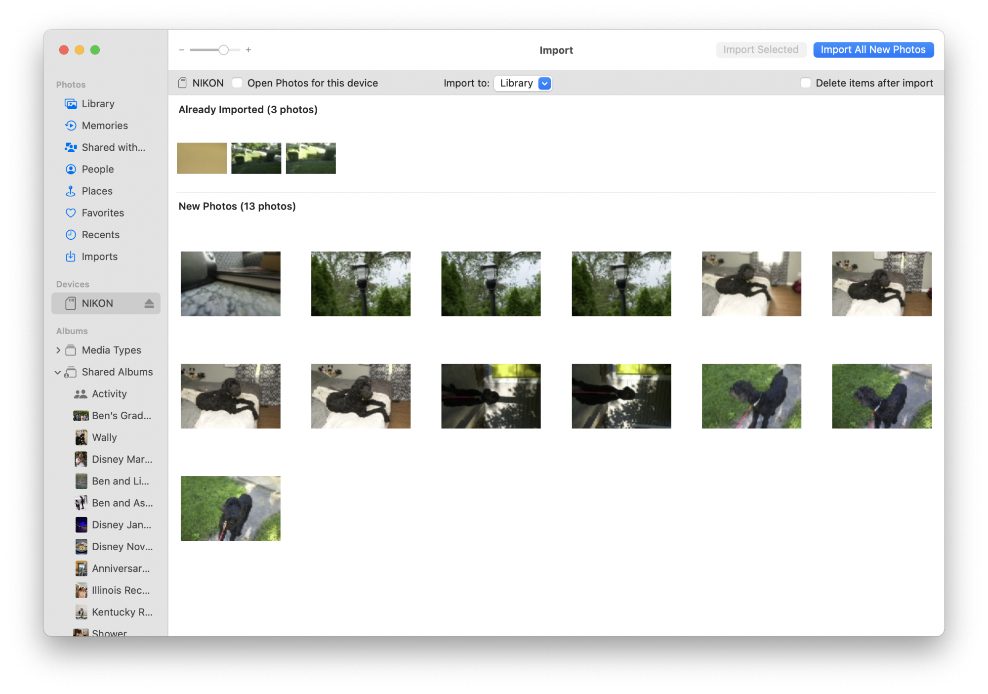

Remember we are talking about macos here. I have a number of old digital cameras, Fuji, Sony and Panasonic that are not detected by macos when connected via their USB cable (yes they are setup correctly in the camera's settings). I have an imac 2010 i3 model with OSX 10.13 and it does not detect my older digital cameras when they are connected to the machine via their usb cables which is why I have to use a USB card reader because each camera uses an SD card.
I use the Photos app which detects cameras.
Based on a discussion in another thread, I think you're using Image Capture, which detects your camera when attached.

No I am not using image Capture and only used it briefly which I have later learned did not fix my problem.

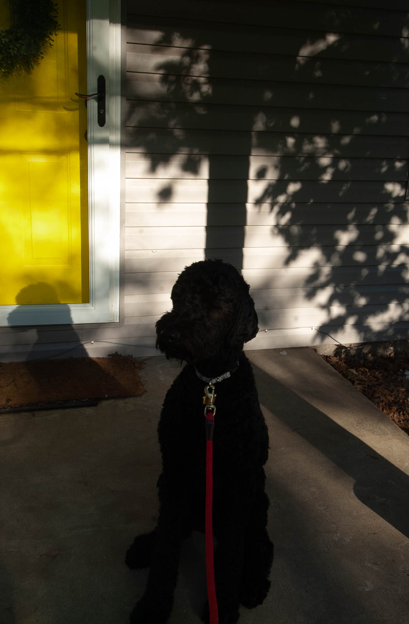

Here's a photo from my Nikon D1 shot this morning. I hope you'll humor my use of a pet photo, but a jet black dog can be surprisingly difficult to photograph and he was also being well behaved this morning.
First of all, I shot these in RAW(.NEF). This is still the format used by Nikon cameras, although each camera has its own quirks and the RAW processor needs to have support for the specific camera model generating the files. I'll also mention that even though I have a couple of D1s, this is the main one I use, partially because I spent a lot of time setting it up. The camera feels very much like a digital Nikon F5, and rather than having full text menus, a lot of settings(or custom functions in Nikon speak) are handled as on the F5/F100 and you really need a "cheat sheet" to know what you're setting. Incidentally, that button along with the ISO button is right where you'd find it on an F5-under a little metal door behind the small LCD on the back toward the bottom of the camera. The ability to even record in RAW is toggled on/off by a custom function.
Apple Camera RAW is able to read/recognize the files in Monteray, although I'll also mention that I hate Photos as a RAW processor

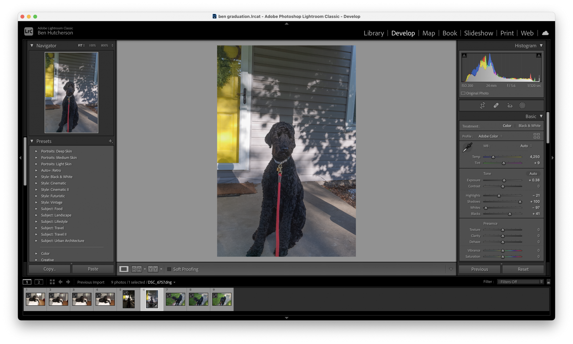

Fortunately Lightroom also handles them fine
The final result...well it's okay but not really by 2022 standards. I'd not be ashamed to share it if I wanted to show someone a photo of my dog. Note too that this is nearly ideal light-it was morning light in the shade of the porch, so not contrasty like full sun but still plenty bright.

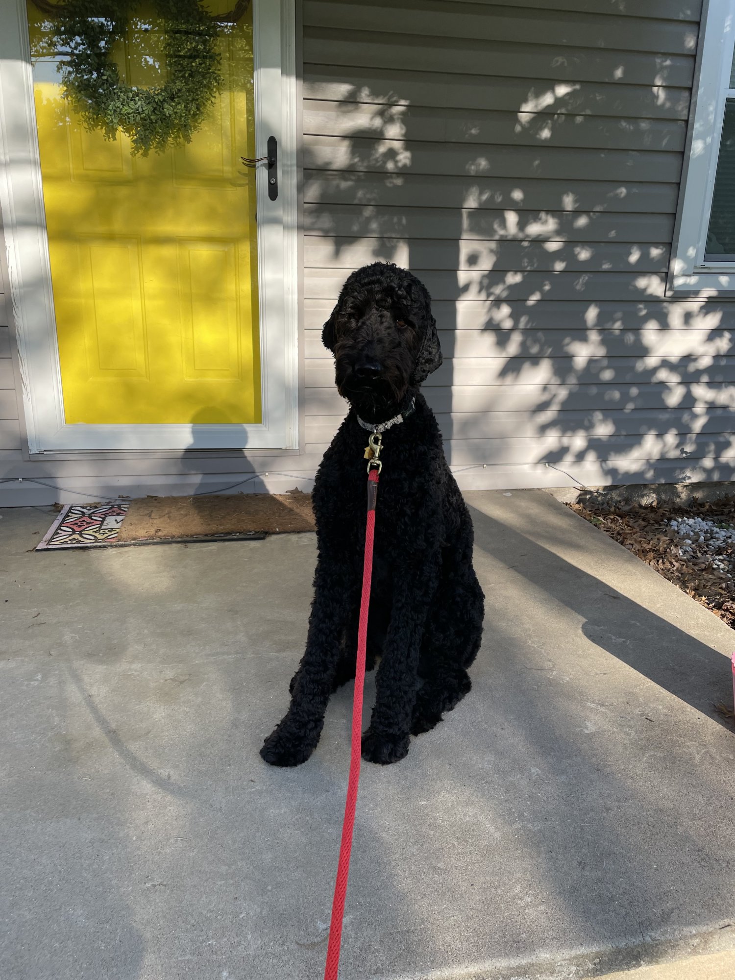

BTW, this is a full resolution file. If I tried to post one from one of my more modern cameras, the website would scream. This was also at base ISO, 200. I have this camera set to underexpose since CCDs do not handle blown highlights the way we're use to on a modern camera, and this is what the uncorrected image looked like(not the same photo, but taken a few seconds before, and I didn't feel like rolling back the edits when I realized I should include it in this post).
Even with my massaging, I feel like my iPhone still handled it better
