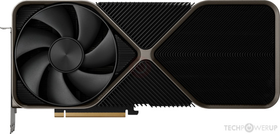

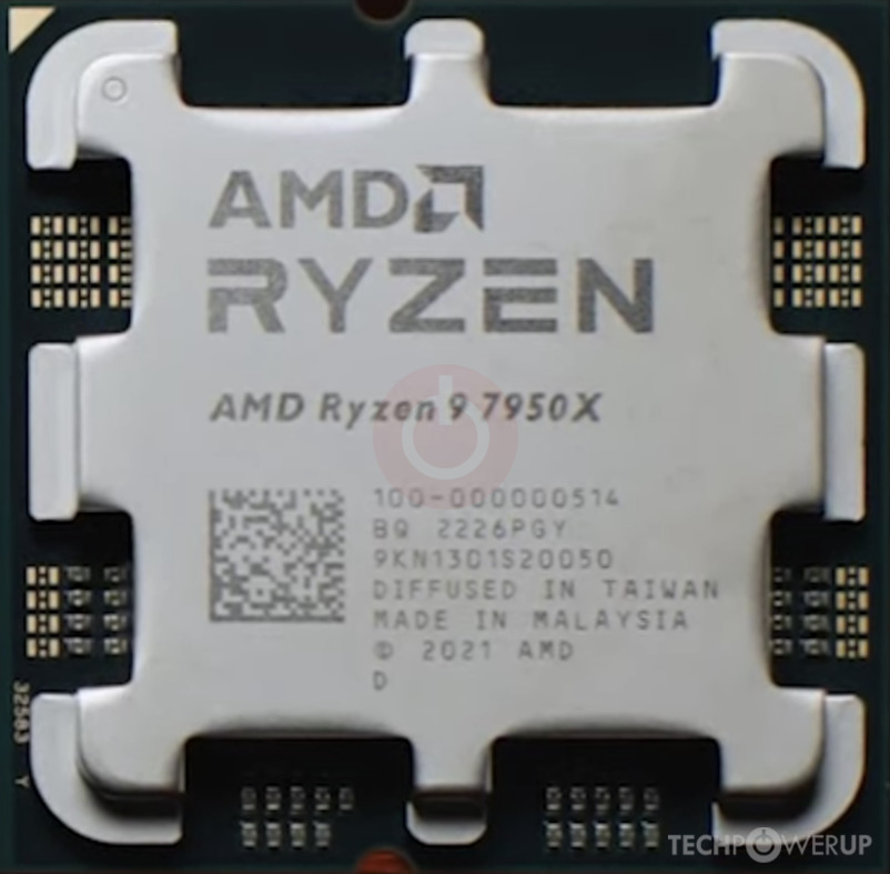

The top level M1 Ultra (114B) requires many more transistors than AMD Ryzen 9 7950X (13.1B) and Nvidia RTX 4090 (76.3B) combined.
But the M1 Ultra includes 64 GPU cores and 32 Neural Engine cores! If we assume that these chips are produced on the same process nodes, than the energy consumption differences are direct proportional to the number of transistors used for a calculation.
