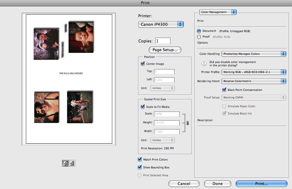

The one i'm using here at work is a Canon Pixma iP4300.
I'll attach a picture form my print screen within CS3 so you can see for yourself.

Looks like you're asking Photoshop to manage colors and you're working in a basic color profile. I would recommend trying to choose something that is tailored towards the paper. What paper are you printing on?
The most common user error is to "double manage" the printer color profile. It must be done in EITHER the driver or in Photoshop but NOT both. If that is OK then is you monitor calibrated?
