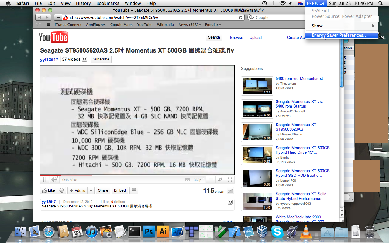

I have a Mid-2009 MBP 13", just now I noticed something strange, the light on the power cord suddenly turned to orange(from green) and the battery indicator shows 15 minutes left(and decreasing, now it is 12), but it also shows 95% full and increasing, now it is 97% full:

I think sometimes when you leave your laptop plugged in, it doesn't start to charge the battery until it drops below a certain percentage. This is to protect the battery from overcharging. When it then decides to start charing the battery again, it shows the time left until the battery is charged. NOT the time left until the battery runs out.
So, basically, your battery is fine.
Thanks for your reply, but the time left actually increased a bit, from 7 minutes to 8 minutes now, at 99% full, I'll see what happens next.
The time you see indicated is the time remaining until it's fully charged. The time estimate can change from moment to moment, depending on the workload and power requirements of your system.
This should answer most, if not all, of your battery questions: Apple Notebook Battery FAQ
