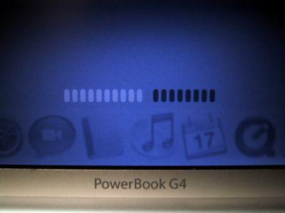

It's a G4, correct? Is there a gray screen with a little progress indicator when you press the power botton?
If there is, a new feature on these machines, called "safe sleep", may be enabled on your computer. This means that after a specified amount of time your PowerBook saves its memory to the hardrive and shuts down. Thus, when you open its lid, nothing happens. The computer is completey off. When you press your power button, the memory is automatically restored from the hard drive and all returns to normal, usually. Because your computer was completely off while in safe sleep, there was nothing keeping track of time, except for the motherboard's clock. I think it is likely you need to change the battery on the mobo, but this could be a software related issue.
He said it's an older 1GHz PowerBook G4. They did not have this feature.
