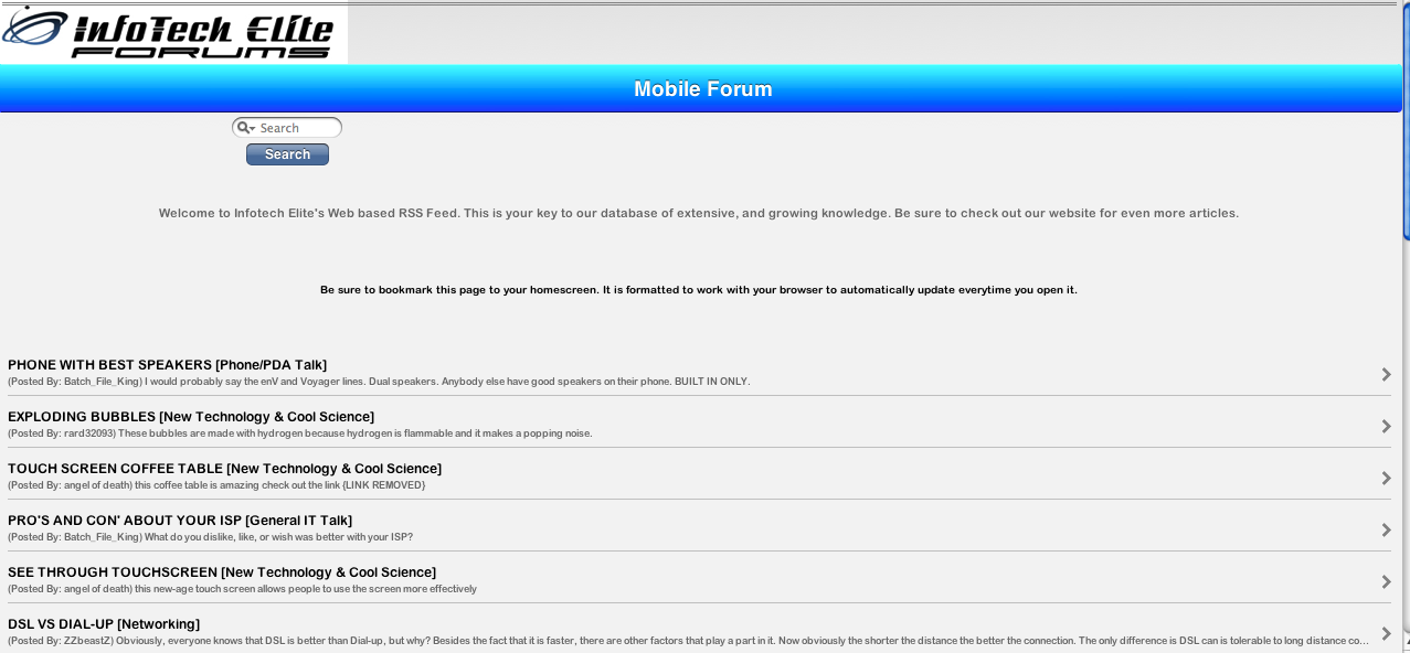

If you for some reason see the web app page from your browser, go to:
https://www.infotechelite.com/mobile/search
* You can try using our SSL certificate, maybe that will work better.
I've attached a screenshot of what you should see.
But I'd like to know If I could somehow implement a PHP search script into Dashcode? I know PHP very good.
